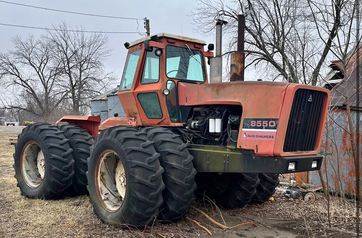

Good day,
So looking at a 8550 that’s about an hour away that has been sitting for about 6-7 years due to blowing an injection line.
Seller says his son finished 10-15 acres of NH3 before replacing the line but says it still didn’t run right so he parked it in the weeds planning on repairing it but never got to it.
Seller’s pretty sure it has a hole in the piston?
If that’s the case would it be reasonable to only replace that piston and ring set?

Post Options Post Options   Thanks (0) Thanks(0)   Quote DrAllis Quote  Post ReplyReply Direct Link To This Post Posted: 12 Mar 2026 at 10:29pm
Interesting how we go from a leaking injection line (which would leak fuel and could cause a miss-fire) to a hole in a piston ?? Two unrelated problems. It could have been a leaking number one injector line and a failed piston could be number 2 or 3 or 4 or 5 or 6 piston ?? Should have been a ton of blow-by with a failed piston. There are injector lines under the valve covers too.........

I owned and farmed with a 8550 for many years and yes they are notorious for injection line failures. One other possibility is when they replaced the failed line the inj. pump barrel might have moved slightly, causing fuel to bypass and the engine still miss. This happened to me once, removed the one head expecting to find something and everything looked good. Good Luck!

Post Options Post Options   Thanks (0) Thanks(0)   Quote 55allis Quote  Post ReplyReply Direct Link To This Post Posted: 12 Mar 2026 at 11:01pm
I thought that very interesting too..
Going to look at it possibly Saturday morning if all works out.
Seller drained the engine oil last spring or so to start in on the repair so I wont be able spin it over.
Is there any concerns about being a dry start?

Fill the new engine oil filters with oil before installing and start it at an idle to let the oil pressure build.

Is there a way to have a custom lines made that has thicker sides walls or bigger line with same fittings?
Never even seen one in person, only photos and videos off the internet so bear with me.
With this being told what’s a good price range to offer?
Paint is crappy (mostly brown) tires aren’t the greatest but do look like they hold air and might last awhile. Cab interior is crap, seat has a hole. Hour meter reads 3644 hours but not sure if it works.

Talked to the owner again today and he said it had a lot of blow by to the point of blowing oil out the breather..
Said it didn’t have any before…

The more I read, I think this engine needs a major overhaul. If one of the diesel lines under the valve cover let loose, you could’ve had Diesel get to the bearings. You could’ve had a valve touch a piston. It sounds like the owner has told you several different things, so it could be anything and everything.
We had diesel in the oil on a 4W305. It turned out that had a bad seal on the injection pump. Every time I turned into the wind, I could smell Diesel. I managed to catch it in time and no damage was done. Sometimes it’s really good to be lucky.🍀🍀🍀🍀🍀

Would the cylinder with the leaking injector line have caused the rings to stick from lack of fuel or poor spray pattern? Just a thought

Looked at it this morning.
Guy is asking $11,000 and I think that a little steep, went down $1000 but still think steep, says for any less he’ll fix it and keep it.
Wiring is shot, front tires are pretty much bald with cracks.
Did manage to get it to crank over with battery but it was out of fuel (he drained it years back). The range shifter cable is very stiff but the rest seem to work fine.

Awesome machine for sure, but the cost of repair would surely be very high. Tires alone would be a small fortune. Is this the model that was commonly swapped to an 855 Cummins, or the 4w-305?

I think it’s cool you wanna save it. Unless you have unlimited funds I’d walk away from it. Always thought they were the best looking 4x4 that AC made. Personally like the narrow cab look versus the newer model. Although the newer model would be more comfortable and roomier. Good luck with whatever you decide to do. I’ve done some dumb things in my life, bought some stuff that I should have walked away from, but I never regretted it. If you want a big project, that’s the one for you. It’s bada$$ in my opinion.

I would write up an estimate, get numbers you can look at so you are aware of what the minimum is that you will spend. I would plan on a complete overhaul of the engine, and include tire replacement cost. These are the items you know need to be done. The fuel tank sitting empty for years will probably add another bit of time and effort to the project. When you have your numbers you can calculate a fair offer, and you have your reasons why you make the offer you did. I think if the current owner sees what he can expect to spend to fix it himself the price may get a little more flexible. The other way it may go is after you look at the numbers you may not be as interested.
I noticed that one exhaust is significantly more discolored than the other, probably because one has been replaced recently. But why would they only replace one? Both should be in about the same shape, theoretically have had the same amount of heat and exhaust through them unless there is a cooling system issue and the back runs quite a bit hotter.

No deal right now…
Just seen a 7580 that runs and is decent field condition sell for $7500.
I kinda made a list of everything it would need, not sure on pricing but I know it would have some big bucks into it.
Here’s what I came up with, if you want to add prices for fun you can.

I offered $7000 (that was probably dumb) but he wouldn’t budge. He seems to think it’s big hps so get big bucks for it.
I’d love to get one but I’d take a wild guess I’d have at least $20,000 in parts and tires for this one.
