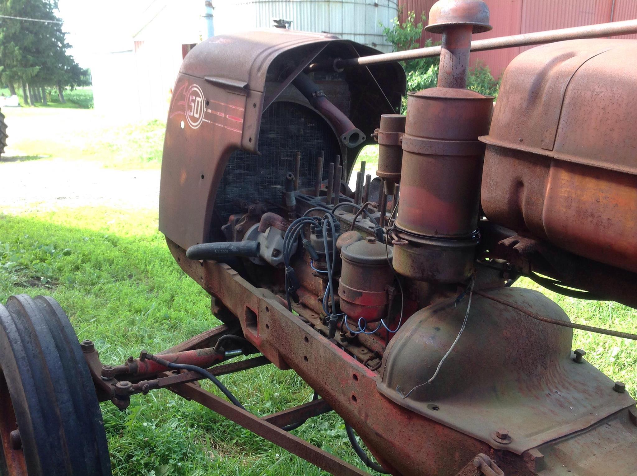

I have taken over a basket case Cockshutt 50 with the Buda 273 engine. I am looking at what I hope is a g262 Allis Engine. I think it may have 2 oil filters on it. Is it possible to be a 262 with 2 oil filters or does that automatically make it a G230? It is a Gleaner engine I am told.

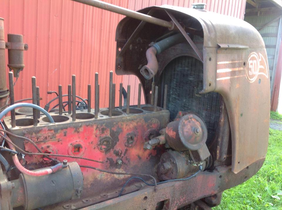

Post a shot of the left side please.The core plugs on the right side are not used in the Allis engines.

Don, that is original 273 engine in it. It needs a repair sleeve. The Allis Gleaner engine I have not got it home yet. If it is a 262, I will use it as is. If not, I will use the crankshaft plus other parts.

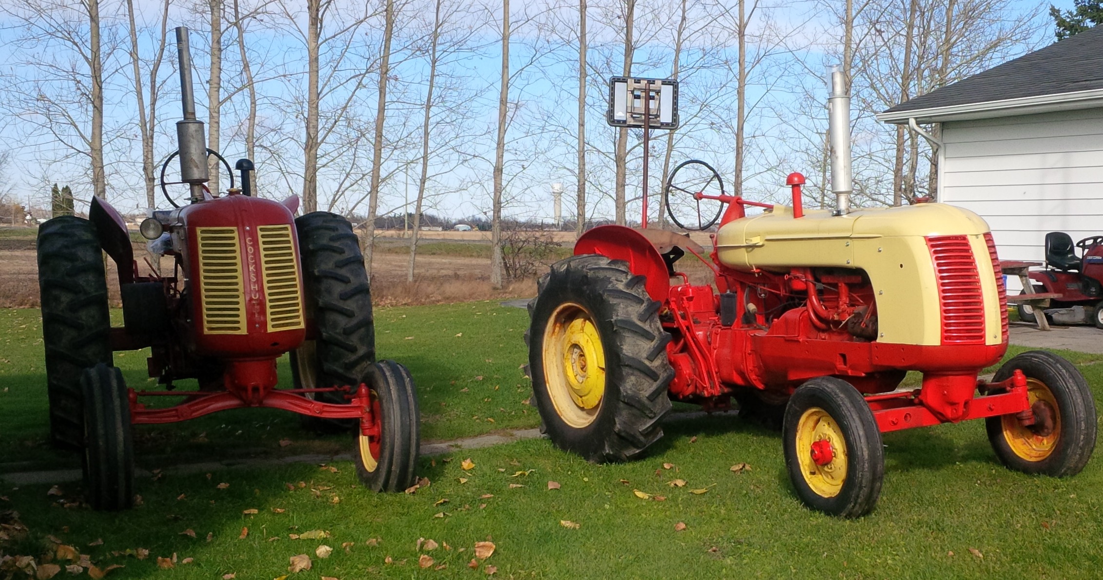

Here is a picture of the 40 complete and the 35L I have also.

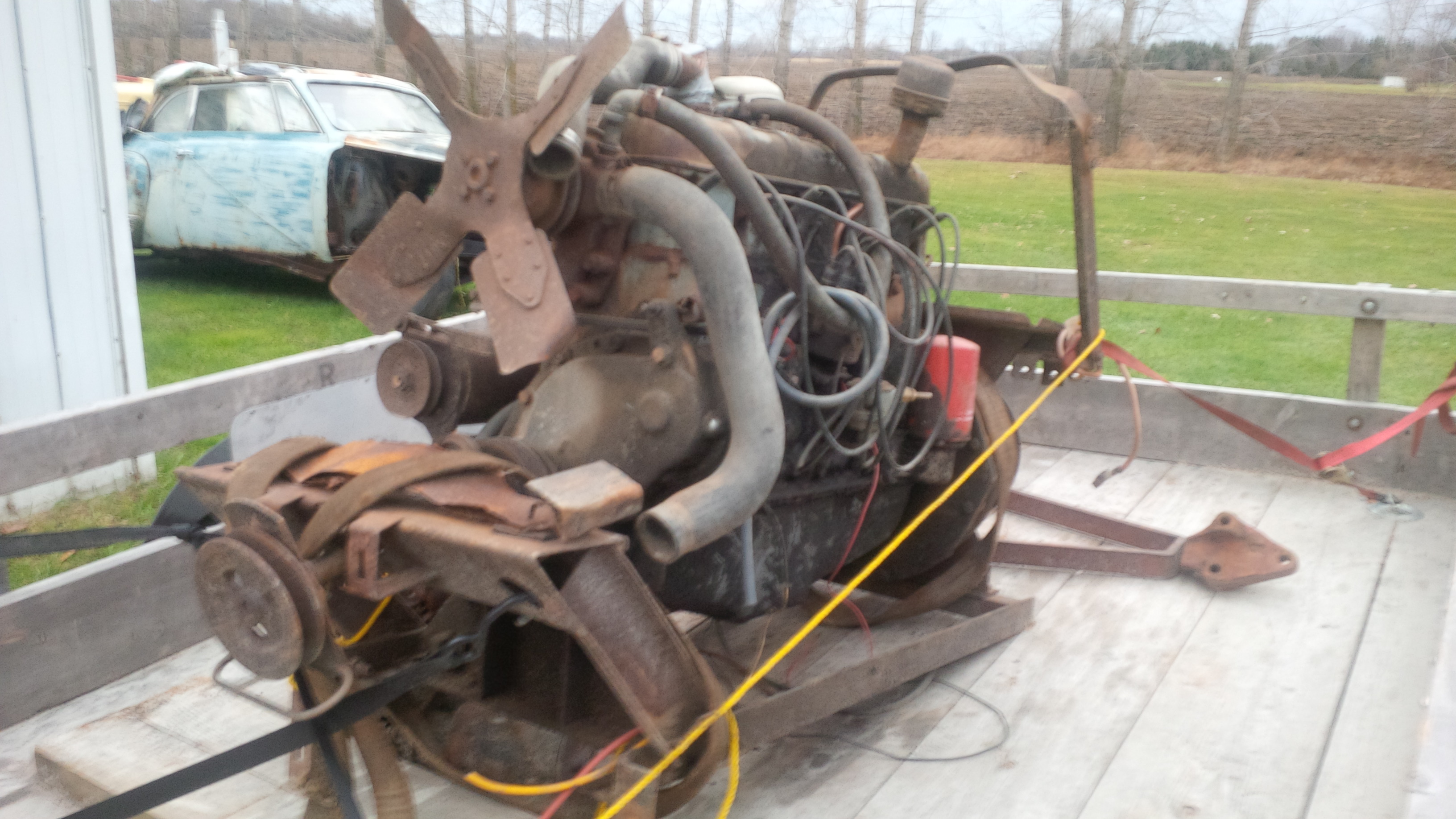

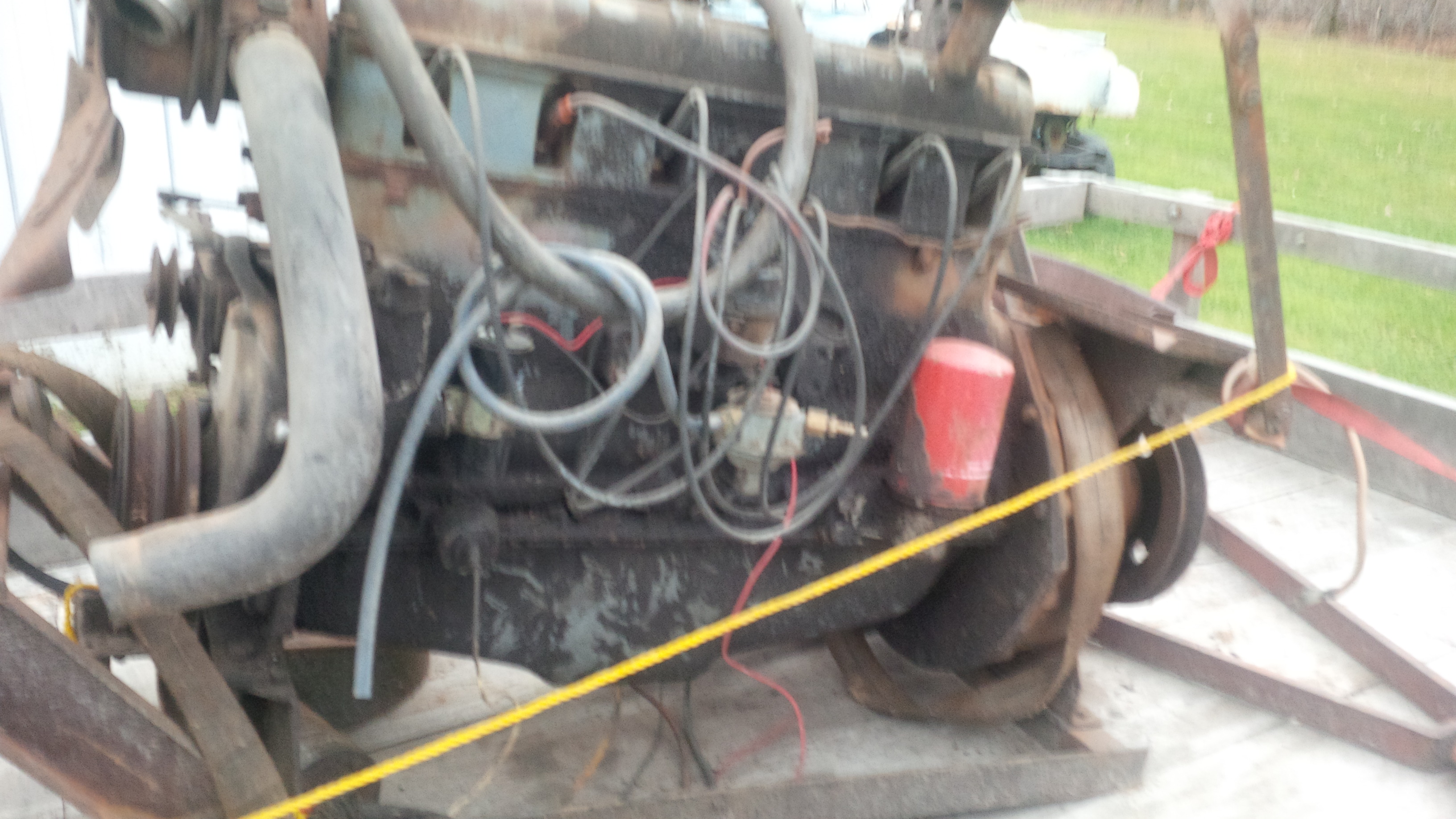

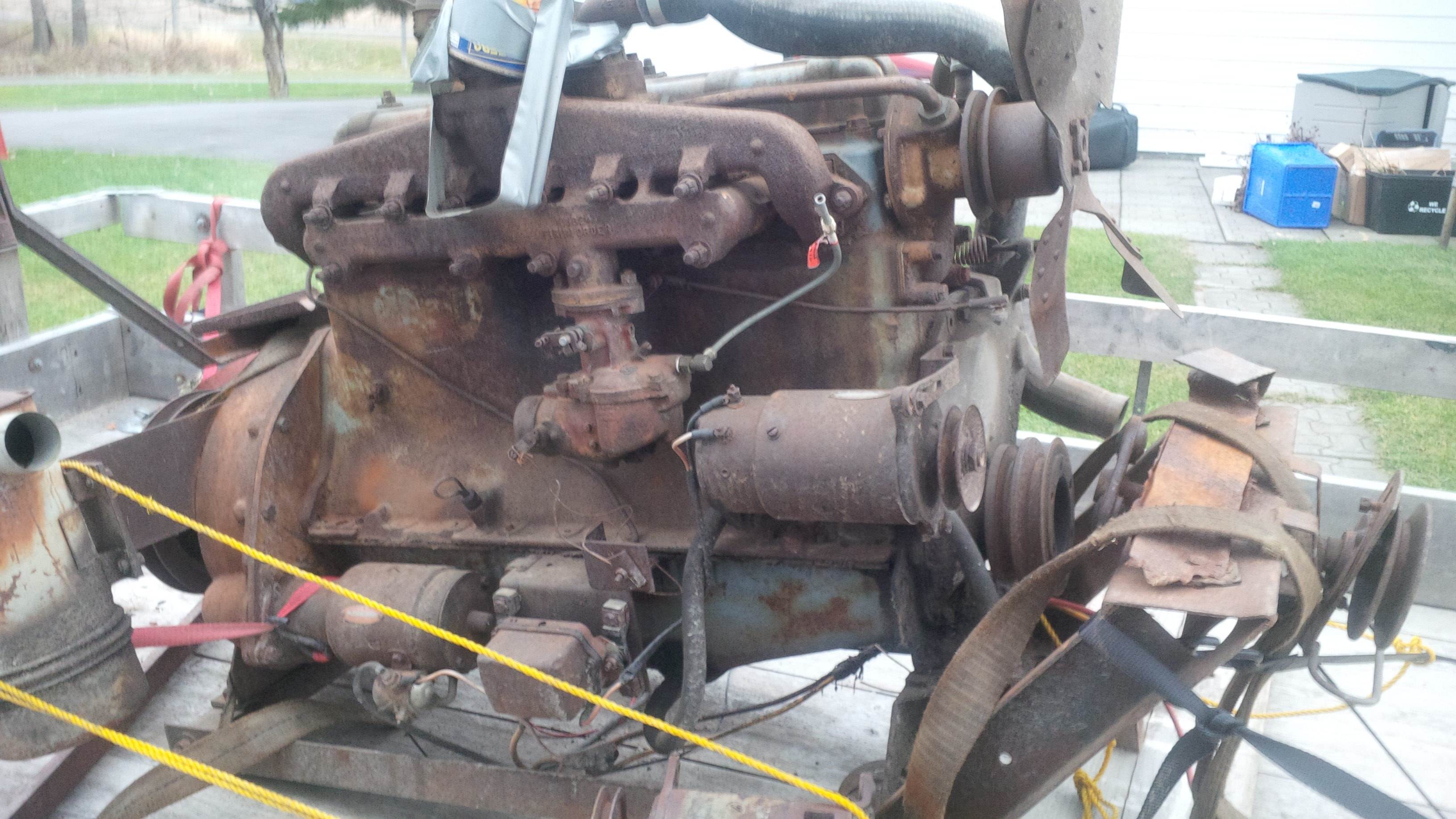

Hi Don. I got it home now and it is on my trailer yet. Here are a couple of pictures of it. It has no tag on it and no date code either that I can see. No plugs on the rh side or even marks like the b230 had where they could and maybe should have put frost plugs. The right side is all smooth. I have a picture of a G262 looking similar while a picture I have of the G230 looks like the B230 on the right side, so I am hoping it is a 262 - any thoughts on if it is?
Thanks for your help. My first thing I will do is take the compression after I put a little oil down the cylinders and then work on getting it running. It has been as few years since it ran I think.

That's a G-262 with that big Bendix carburetor on it.
