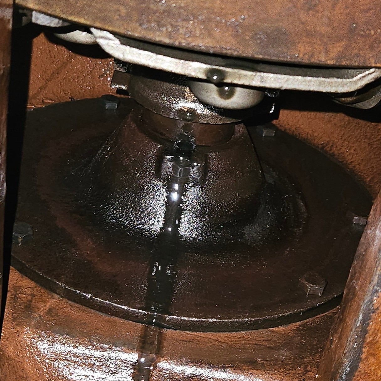

Not sure if the pic uploaded here or not (not very techy). I dried off all the oil before starting the tractor, let it idle a bit and brought the idle up to about 1000 rim and engaged pto (nothing connected). Almost immediately I had oil coming out from the shaft seal on the hydraulic side.

I'm not doubting the oil leak inside the bell housing when the PTO is engaged. I am seriously questioning the complaint of the differential oil disappearing into the hydraulic sump. Never ever seen that and why are there two problems at the same time all of a sudden ???

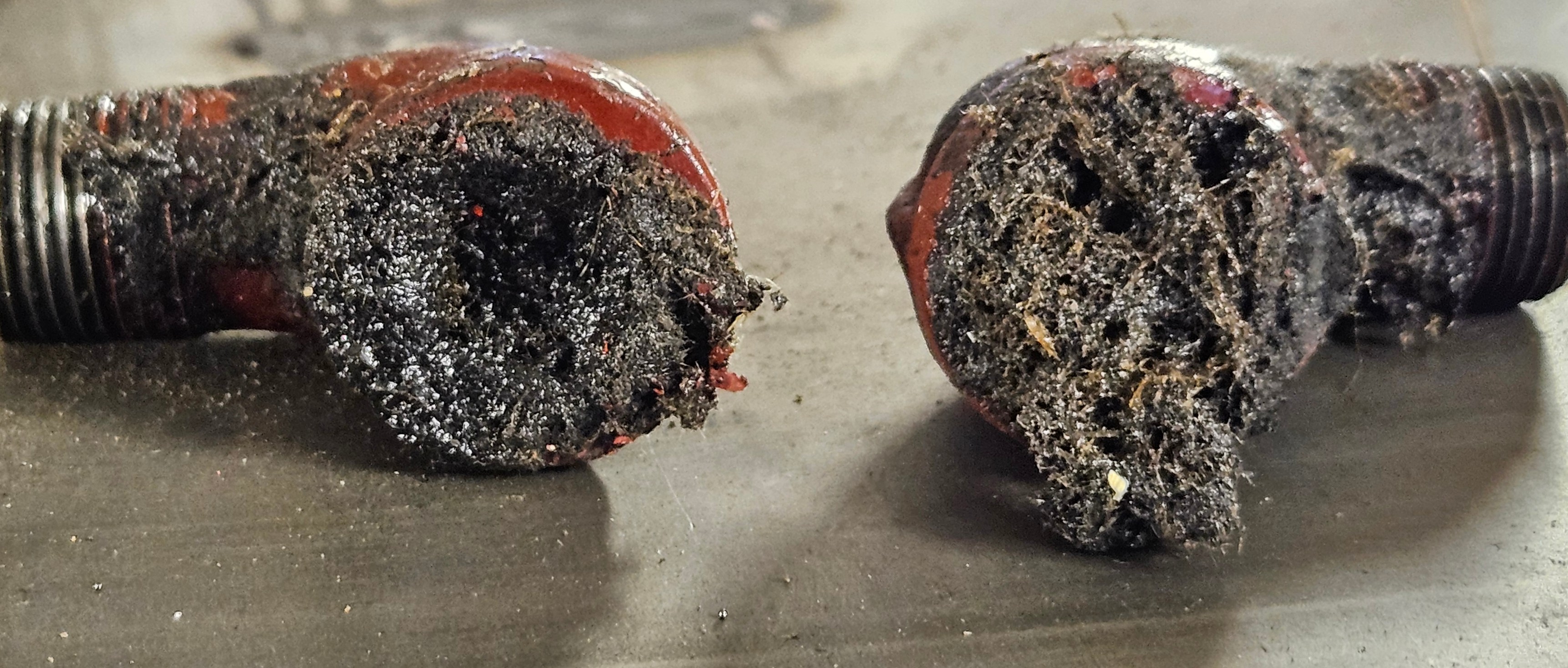

I did remember today to take the diff vents off and they were solid plugged. Cleaned them real good and air easily passes through now.

These are the 2 vents on the top plate of the rear diff. The rear dipstick does not have a vent on my tractor.

The two vents you cleaned are to the right and left bull gear compartment. As I said, the breather for the CENTER compartment (differential and PTO gears) is built into the dipstick handle. You could remove the top sight glass and let the oil run out, but that usually means you'll need a new sight glass as they will break when removed. Drain oil out of the pan directly down from the sight glasses one gallon at a time until you can see thru the top sight glass. How much oil have you added to the differential compartment ??

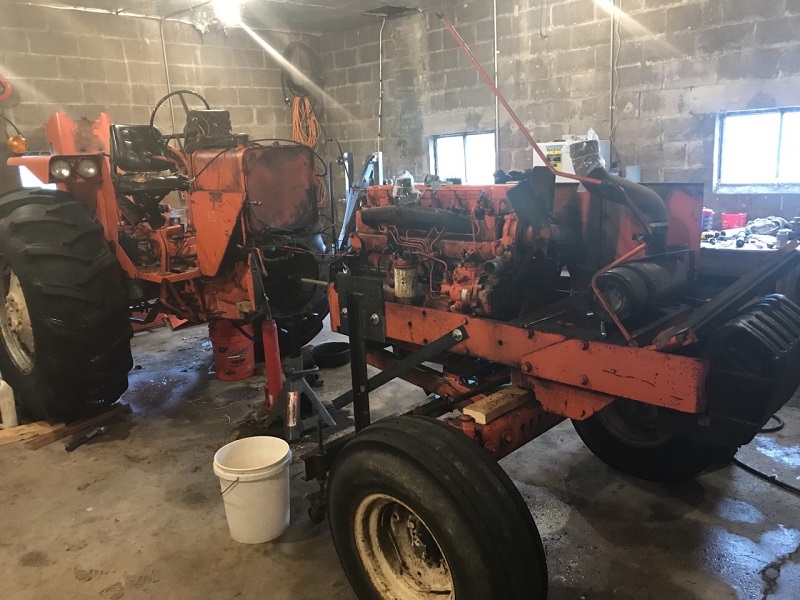

I will look into splitting the tractor. Not afraid of getting my hands dirty, but I am afraid of flipping the tractor as I've never split one before.

It's a good time to build yourself some splitting stands. I"m sure osme on here have some pictures to share if you need some ideas. Here's some on my 185
