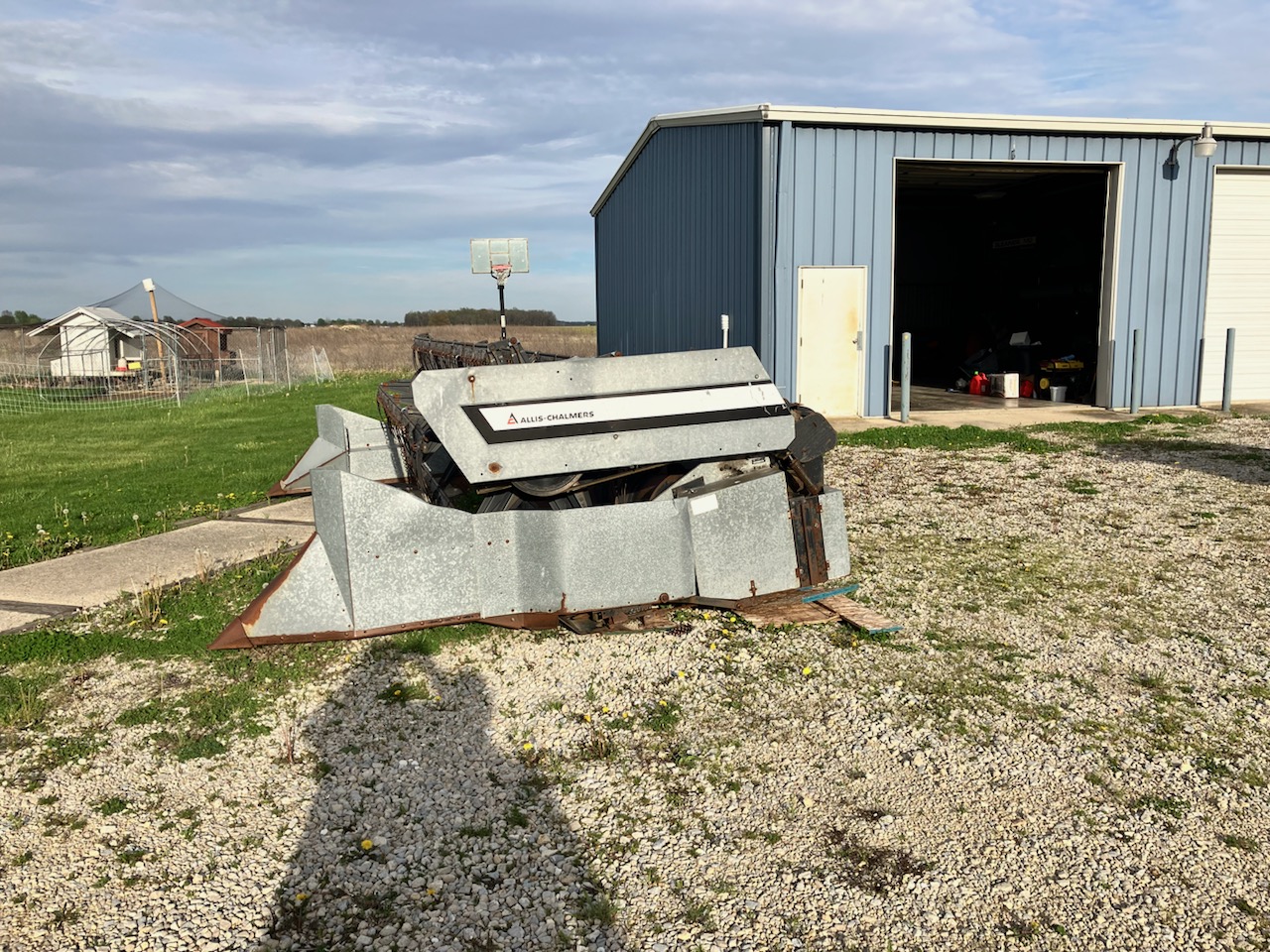

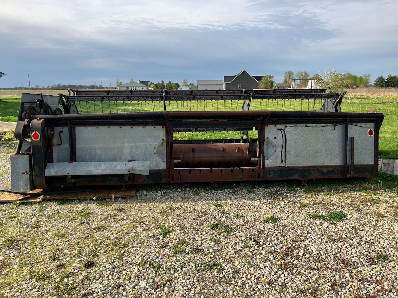

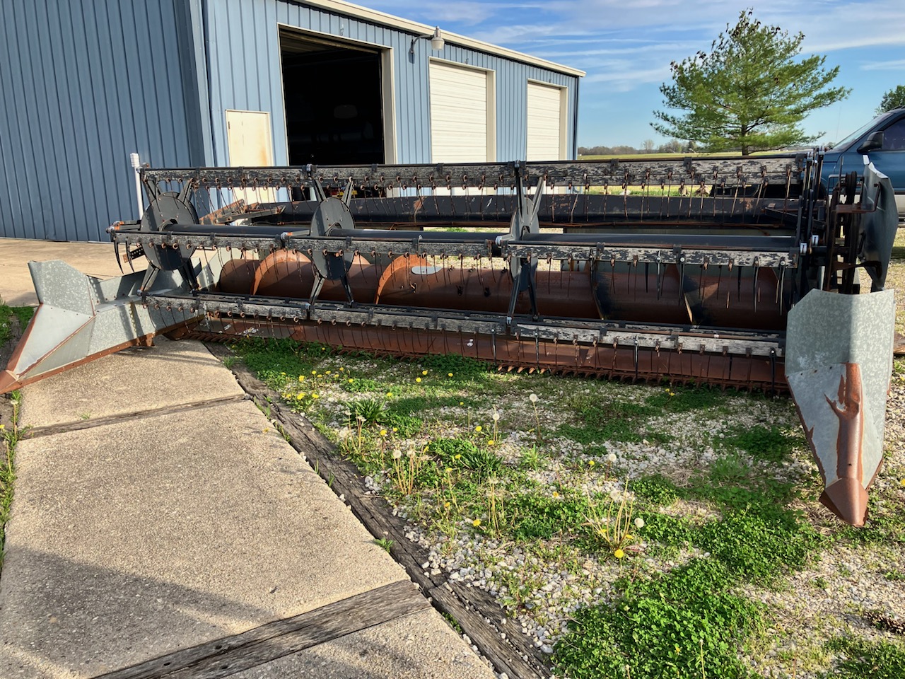

Hello All,
I have some pictures of the grain head for some perspective. IMG_6241.jpgIMG_6240.jpgIMG_6242.jpg

If you are using this head for small grains you have to lock it up, so it doesn't float otherwise it is very hard on bushings. You leave it float when cutting soybeans. Look up in the book how to lock it up.
Points: 22794
Post Options Post Options   Thanks (0) Thanks(0)   Quote DrAllis Quote  Post ReplyReply Direct Link To This Post Posted: 19 Apr 2024 at 4:56pm
The header is a "Series 2" floating cutter-bar head (FCB) with a wobble box sickle drive. You MUST slow down the variable-speed header drive on the combine (if it has one) to the slowest speed and disconnect the hydraulic hose to keep from overspeeding the wobble box which will DESTROY it. Get a combine owners manual.

DrAllis,
Thank you for your input! You just saved me a lot of hassle and potential damage to the head. So just to clarify I don't want to hook up the two hydraulic lines? What are they there for?

Those are for the reel and YES, you want to use them. The hose I'm talking about is on the COMBINE header drive.

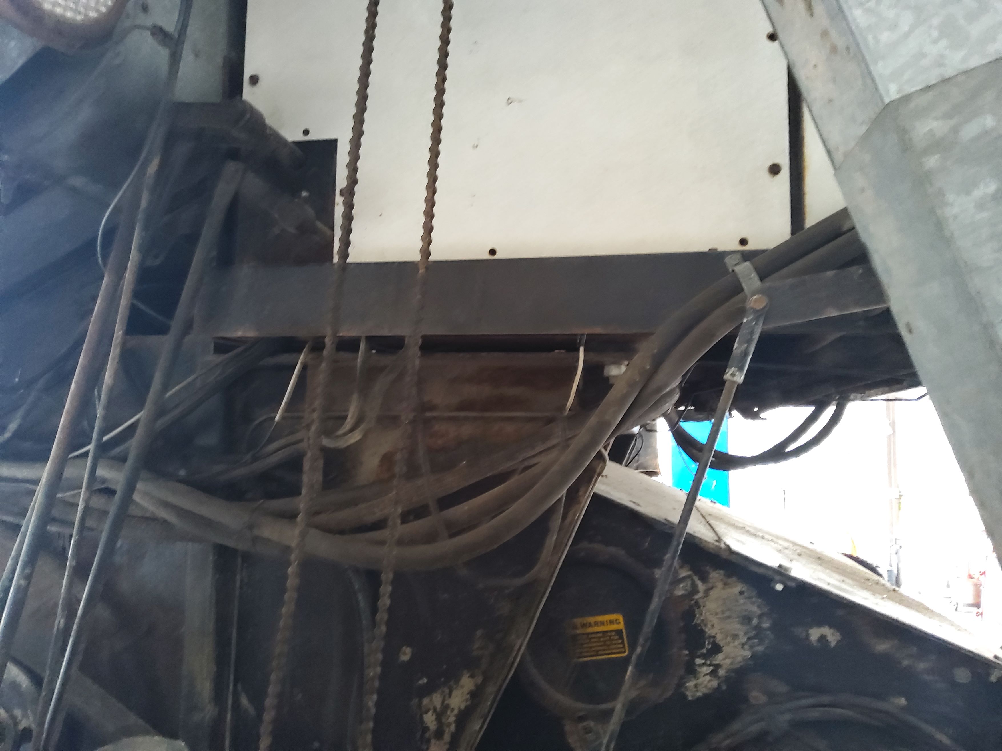

There is a hose on the left side that hooks to the variable speed under the cab step area. When you hook up a grain head you set that speed as slow as it goes. It's been so long since I ran an M I was thinking that hose then goes on the grain head for reel speed but I could be wrong you just disconnect it so you don't speed up the head.

Should there, is there a lock out ring for the variable speed?
Points: 8979
Post Options Post Options   Thanks (0) Thanks(0)   Quote SteveM C/IL Quote  Post ReplyReply Direct Link To This Post Posted: 21 Apr 2024 at 9:08pm
Never saw a lockout ring before rotorys.  I'm sure it's like my F2. Slow it all the way down and unplug it.

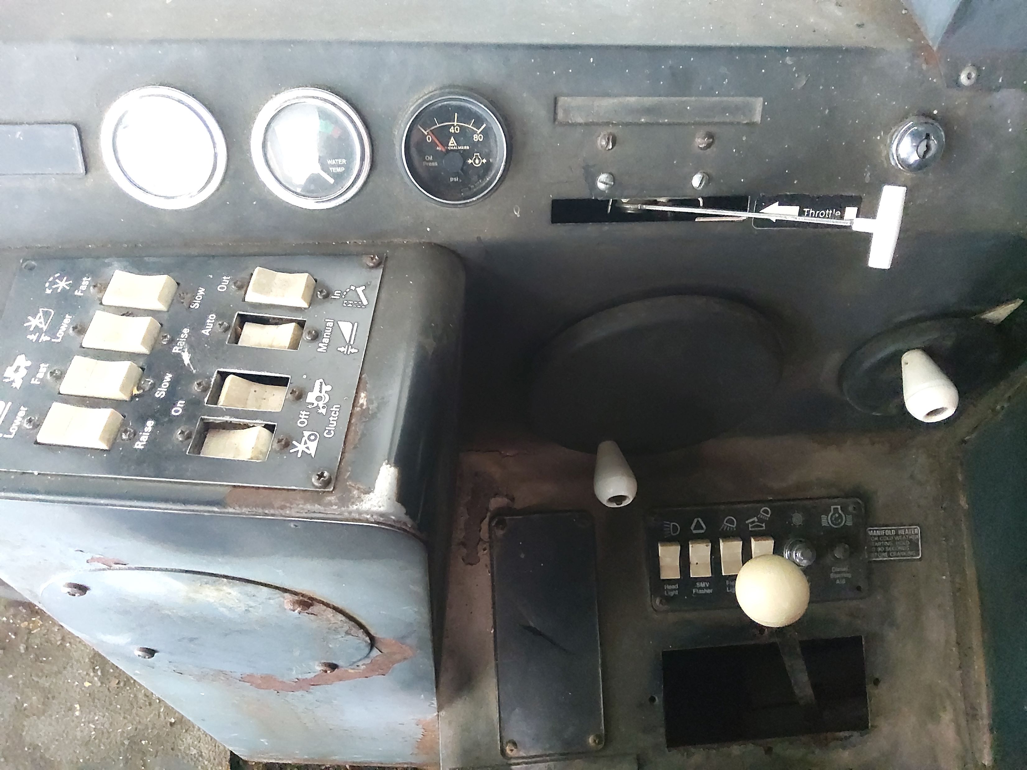

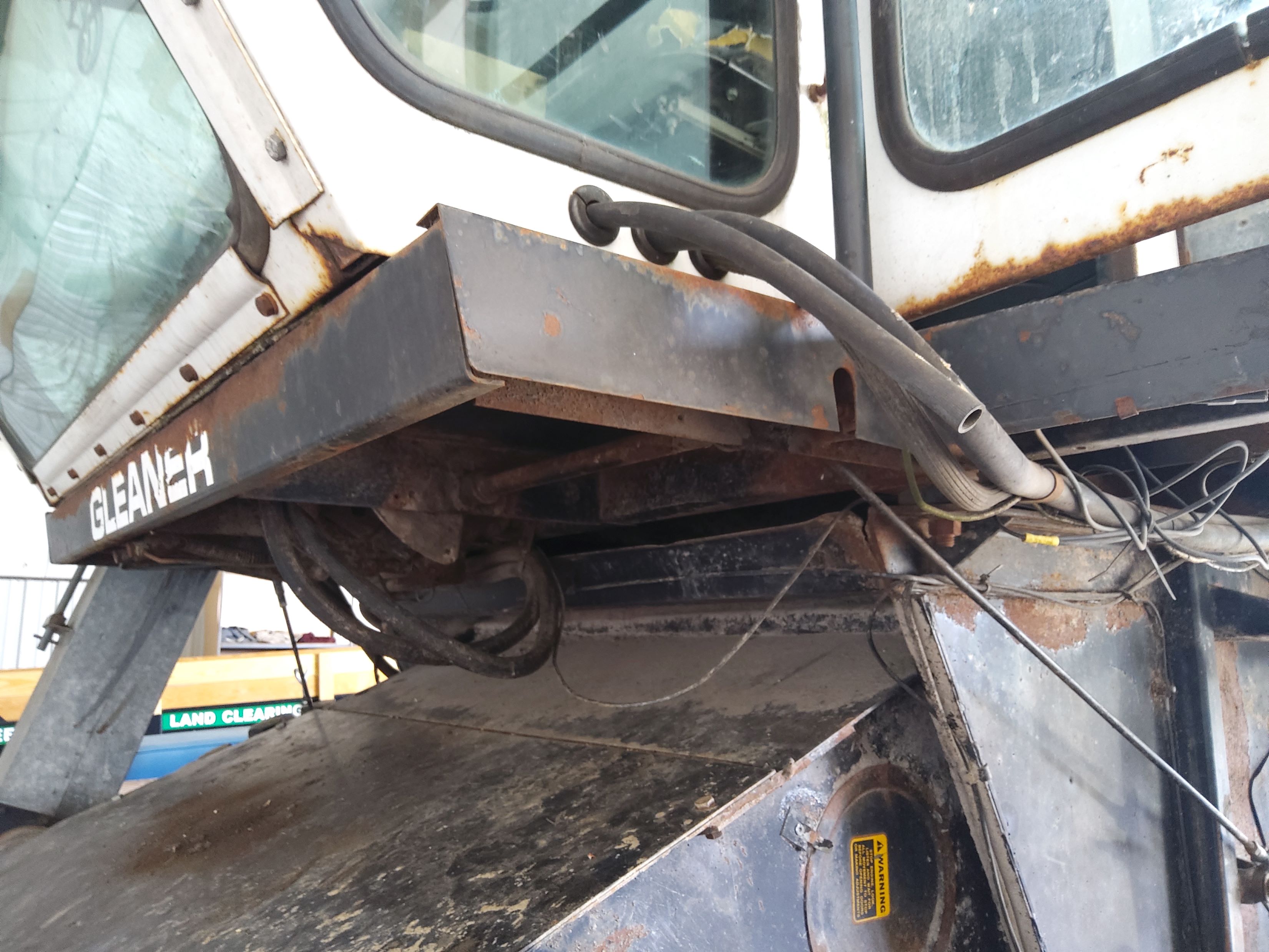

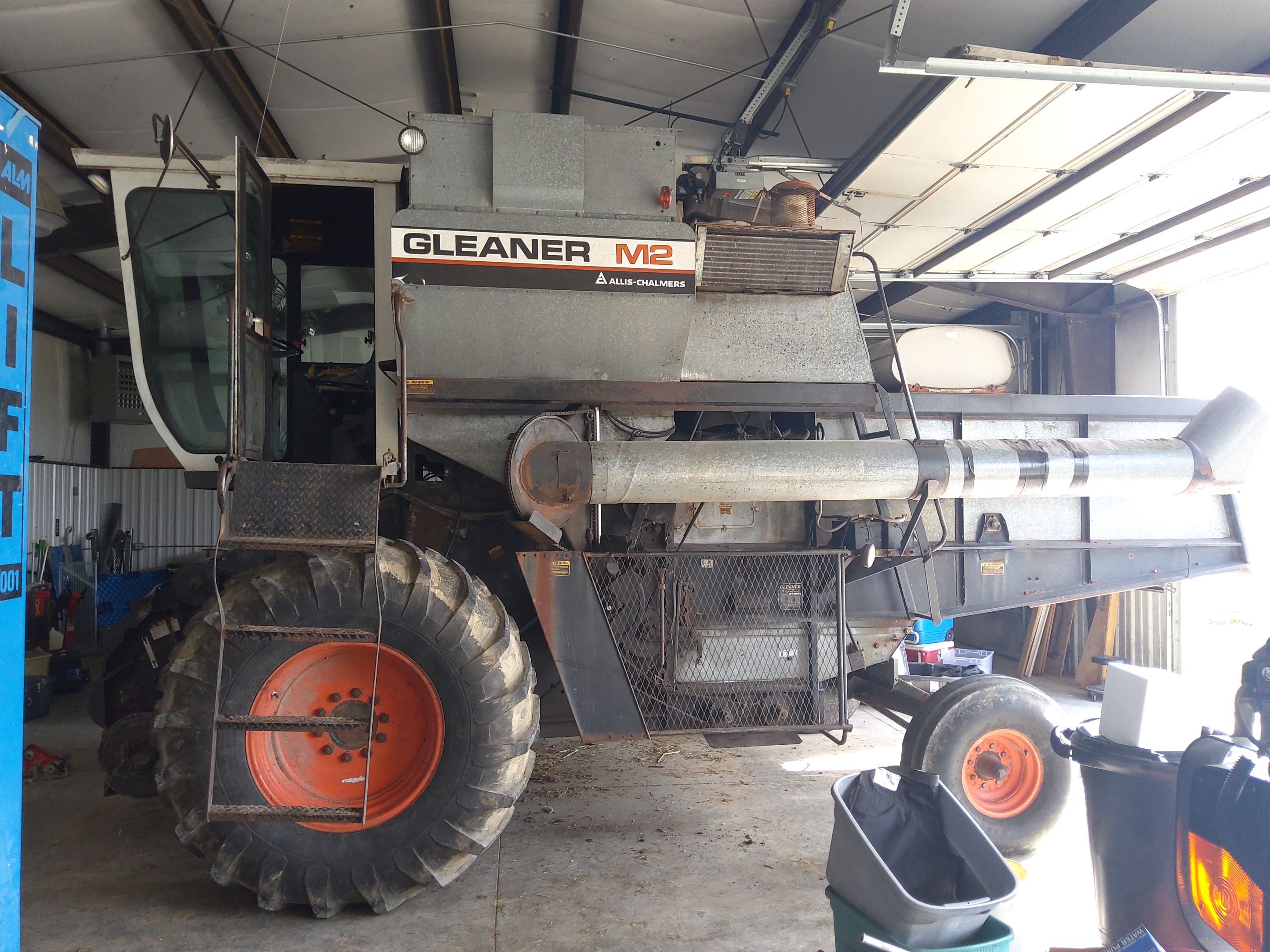

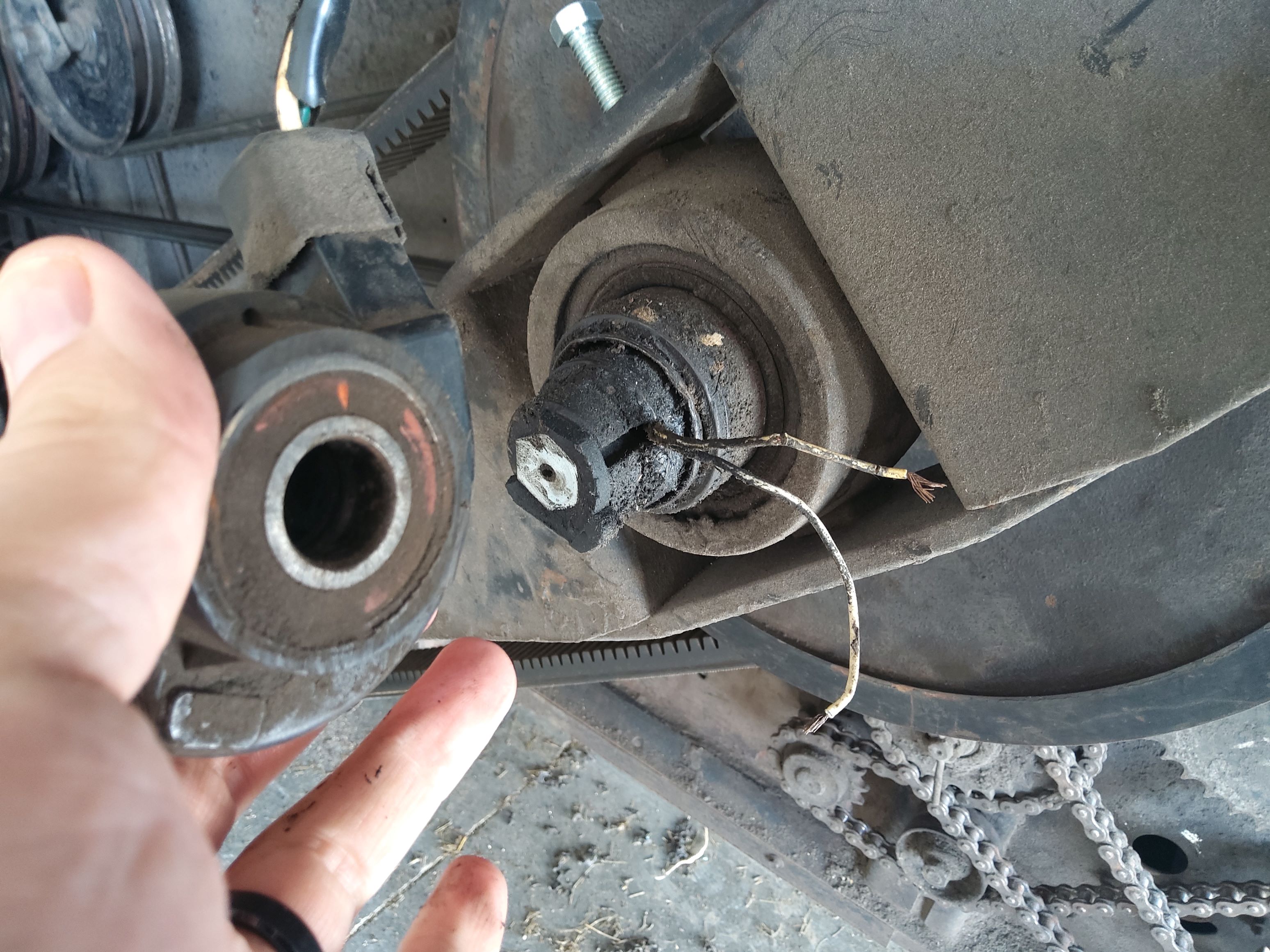

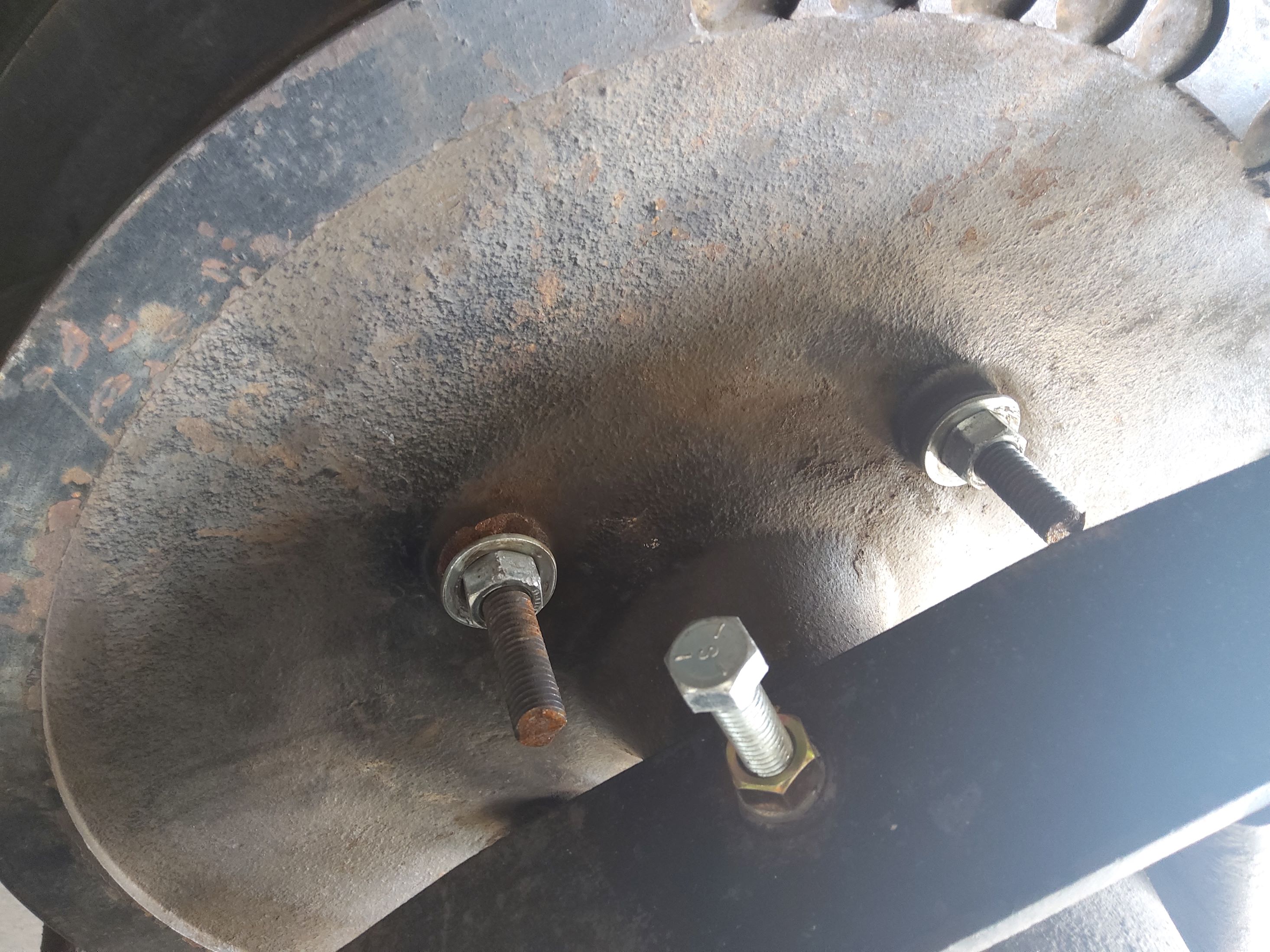

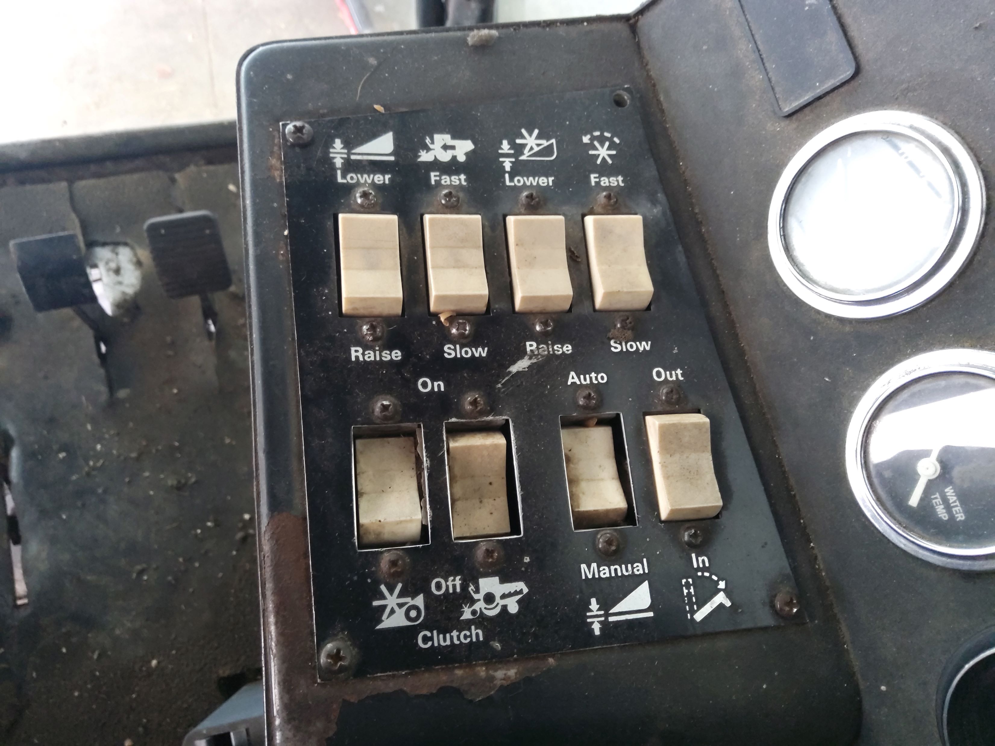

jiminnd,
Here are some pictures of the M2 for reference. The second to last picture shows the variable speed clutch sensor that's inop. Unfortunately, the clutch has also been bolted directly to the drive pulley. So the feeder and head is always spinning as soon as I crank the engine over. I'm not too worried about this though, as the owner claimed this unit had run 80 acres of corn for the past couple years like this. He seemed like a straight shooter. He didn't hide anything and was happy to take my calls weeks after I bought the unit. If I can get 2-3 seasons out of this M2 and be profitable, I will most likely part the machine out and upgrade to a newer unit. Hope the pictures help!
M2_cab.jpgM2_cab_switch.jpgM2_front_cab_1.jpgM2_cab_2.jpgM2_combine.jpgV_speed_clutch_.jpgVariable_speed_clutch_pulley_system.jpg
