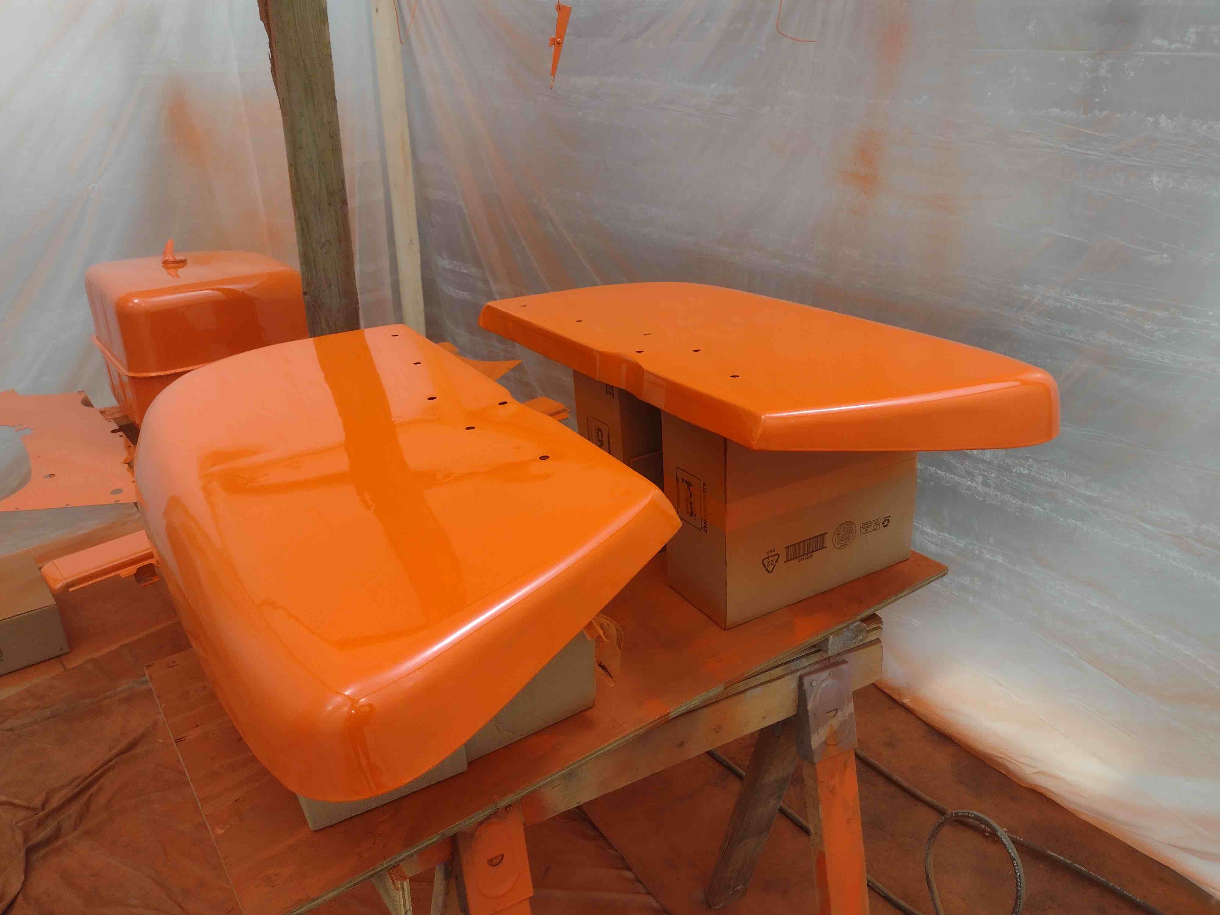

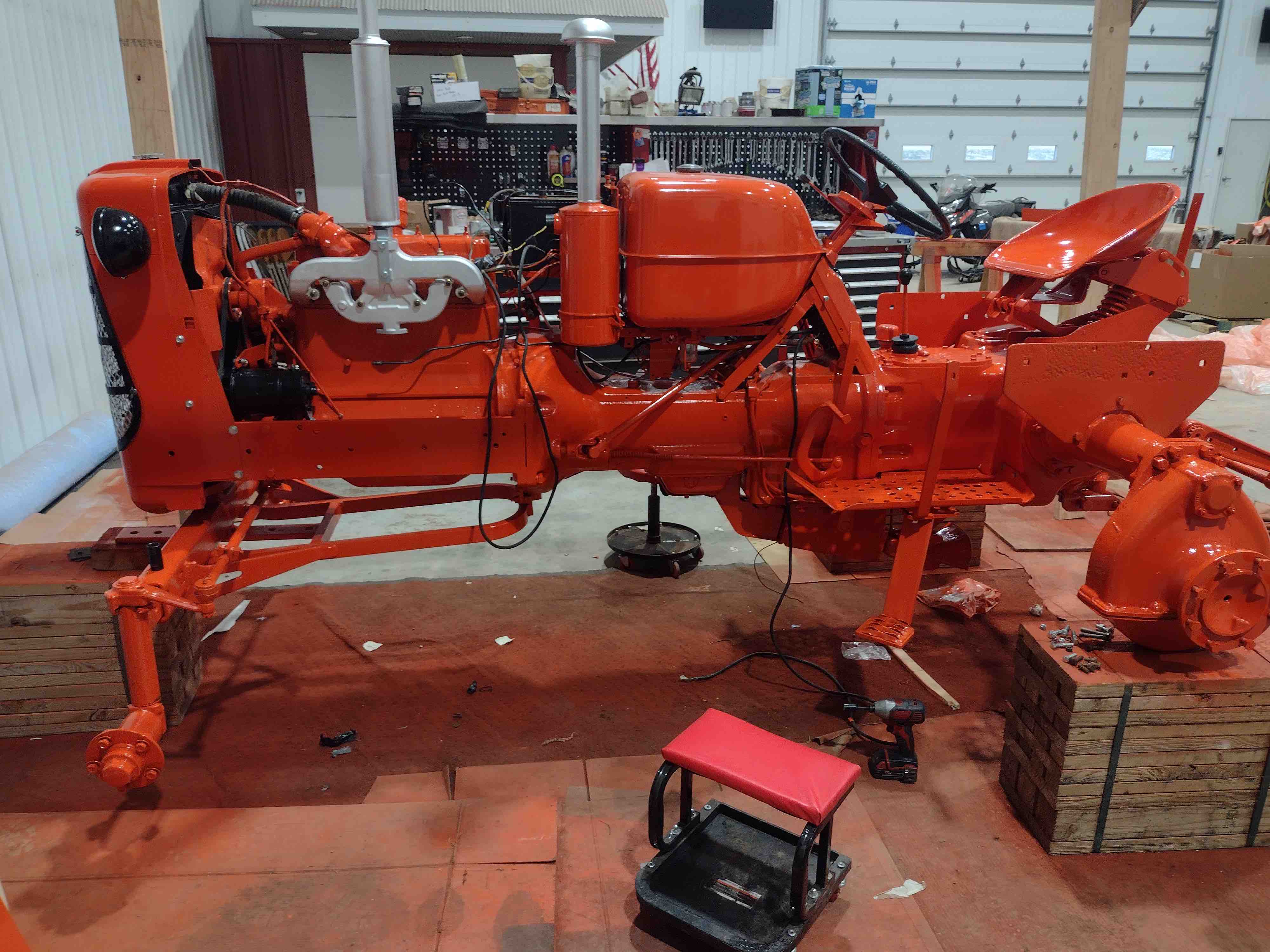

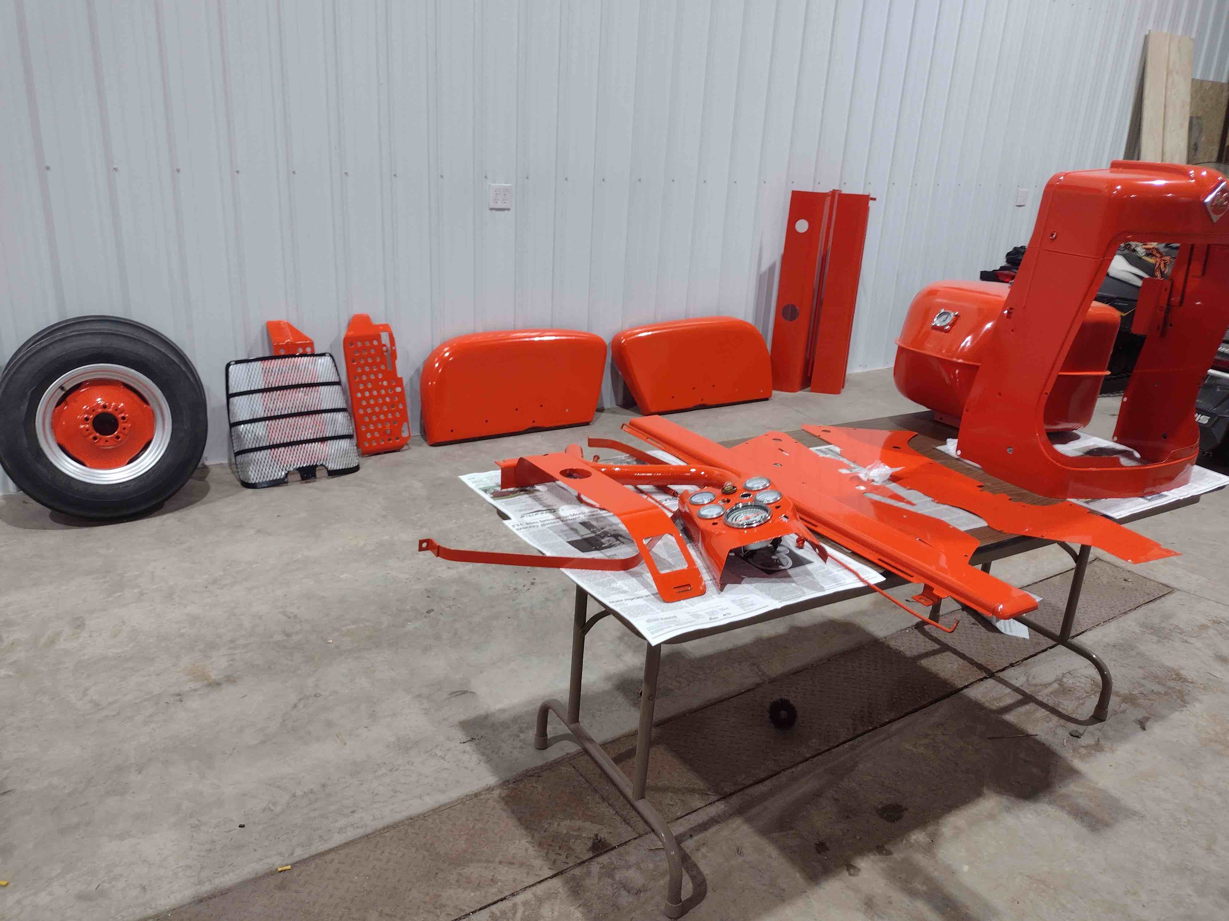

Fender update!  Went with the "not restoration quality" fenders, did have to do a little skimming with some bondo to cover ripples in the curved parts and fill in dimples from the welds holding the reinforcing ribs to the sheet metal.  One fender was actually pretty good, the other is the one I had to spend most of the effort on.  Turned out just fine for me.  Was hoping for a minimum of a "20 footer", I think she'll be a solid "5 footer" thanks to a lot of help from my son behind the $19.99 Harbor Freight paint gun.
When we've got her all back together will post more pics.
Edited by Hayseed - 19 Mar 2024 at 7:45pm

Forgot closeup pics of the fenders in the "paint booth"...
Edited by Hayseed - 19 Mar 2024 at 7:43pm

Looks great.  Smile

That is looking really nice!! Great job so far, don’t forget to post pics once it’s all back together!

For someone that wasn't to particular in building a Mecum show Tractor, that Tractor looks pretty damn nice from where I'm sittin'!  Nice job!  Kudos to your son with the paint gun too!  Love the detail.
