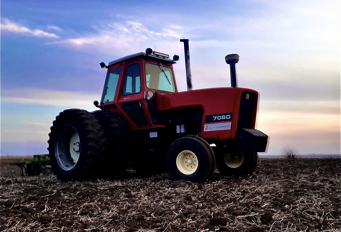

It cloud white…
Persian 2 = cream white
Corporate = cloud white
My brothers 1978 7060 has cloud white and looks awesome…

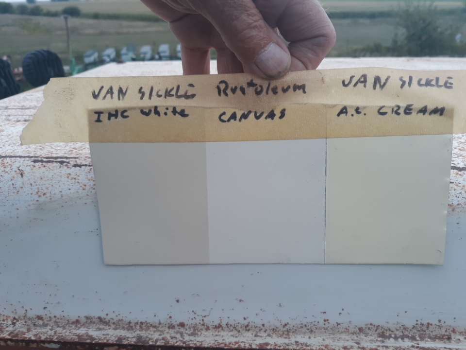

Post Options Post Options   Thanks (0) Thanks(0)   Quote plummerscarin Quote  Post ReplyReply Direct Link To This Post Posted: 06 Sep 2023 at 6:27am
This is against the roof of a 75 7060. I'll take my color card down to the farm tonight to compare to the 7045

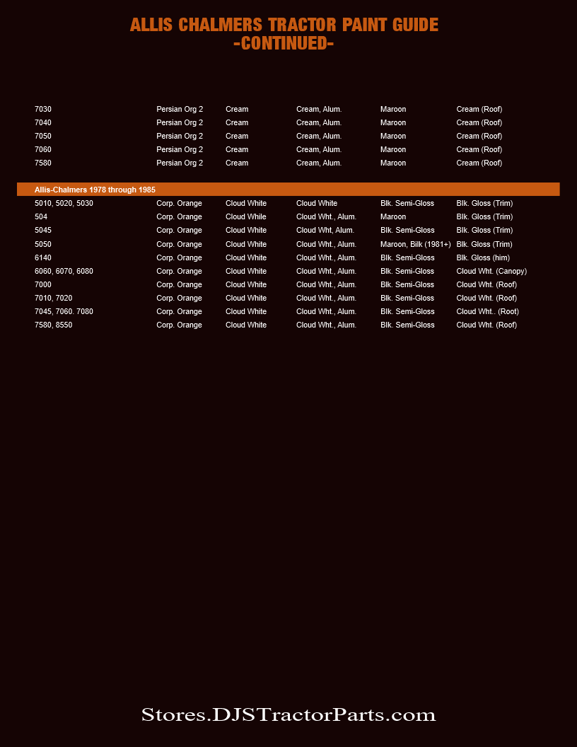

Post Options Post Options   Thanks (0) Thanks(0)   Quote 55allis Quote  Post ReplyReply Direct Link To This Post Posted: 06 Sep 2023 at 9:31am
Here’s a sheet from DJs

Post Options Post Options   Thanks (0) Thanks(0)   Quote plummerscarin Quote  Post ReplyReply Direct Link To This Post Posted: 06 Sep 2023 at 10:13pm
Ok, so here is against my 7045. serial number indicates a 79 model. A little brighter than the '60. Point being if you do not wish to travel to the dealership, Rustoleum is reasonably close. They may have another shade lighter. Did mine in Gloss

If you noticed in the 7060 picture…
When you get it together, take a picture of it!!!
