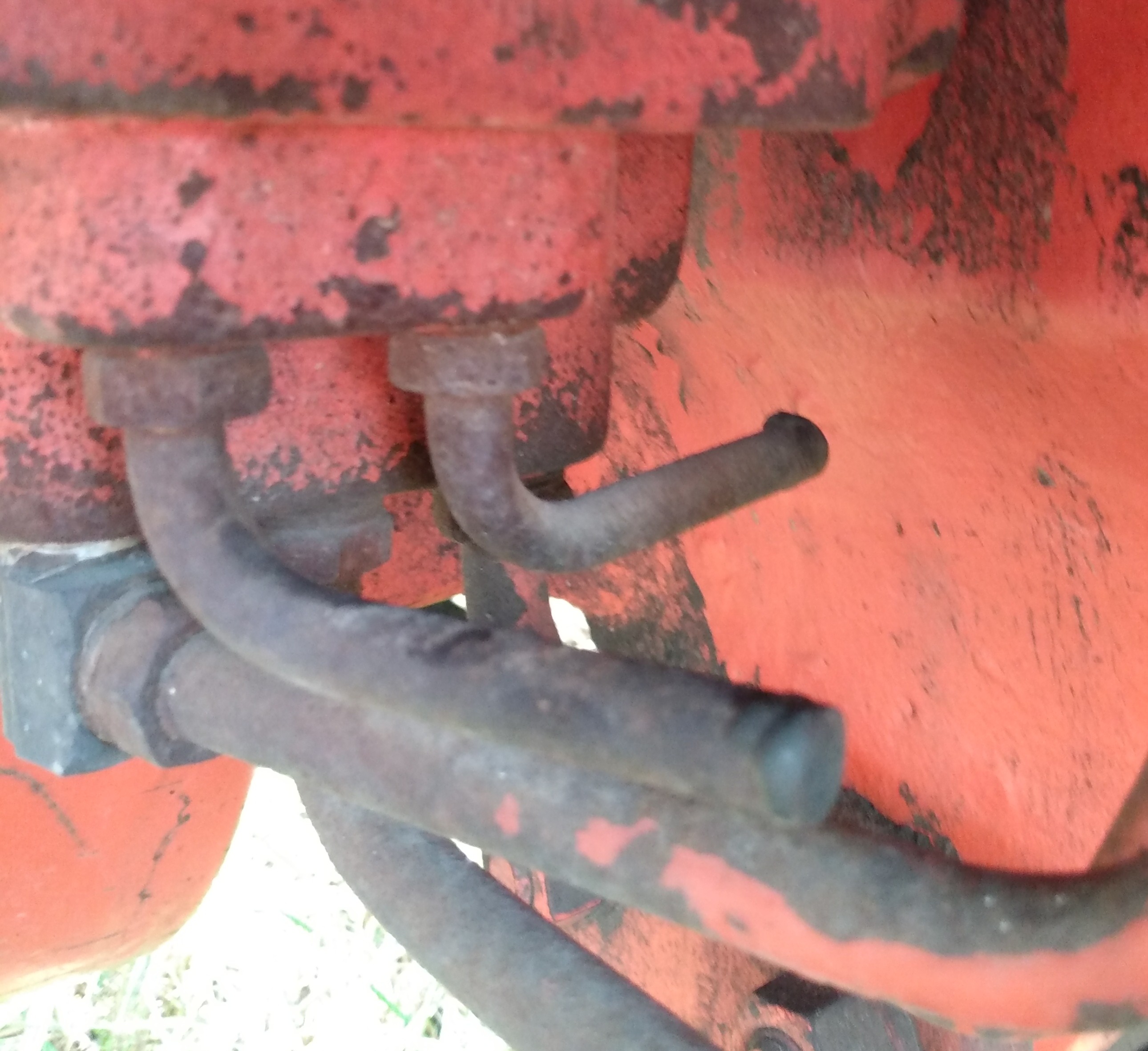

anyone know what these two welded shut lines are for they are located in front of the passenger side brake assembly. Thanks in advance

Can you zoom out for a better shot?  The entire hydraulic valve body is in front of the brake assembly.

Post Options Post Options   Thanks (0) Thanks(0)   Quote youngorange2000 Quote  Post ReplyReply Direct Link To This Post Posted: 15 Oct 2022 at 8:07pm
This is located about 6 inches behind the main hydraulic spools and pd valve

Post Options Post Options   Thanks (0) Thanks(0)   Quote Lynn Marshall Quote  Post ReplyReply Direct Link To This Post Posted: 15 Oct 2022 at 8:15pm
That's the PTO valve body.

Post Options Post Options   Thanks (0) Thanks(0)   Quote Alex09(WI) Quote  Post ReplyReply Direct Link To This Post Posted: 15 Oct 2022 at 10:23pm
resized picture*
My best guess is someone removed the hyd pto clutch from the torque tube and capped off the lines from the pto valve.

Post Options Post Options   Thanks (0) Thanks(0)   Quote youngorange2000 Quote  Post ReplyReply Direct Link To This Post Posted: 17 Oct 2022 at 6:05pm
Is it possible my tractor had a hydraulic pto at some time? It has a decal on the side of the counsel for the PTO but no lever it has the pull knob on the floor

Post Options Post Options   Thanks (0) Thanks(0)   Quote DrAllis Quote  Post ReplyReply Direct Link To This Post Posted: 17 Oct 2022 at 6:24pm
The valve is there. So, they removed the lever.

Post Options Post Options   Thanks (0) Thanks(0)   Quote youngorange2000 Quote  Post ReplyReply Direct Link To This Post Posted: 17 Oct 2022 at 6:52pm
Is it possible my tractor has both types of PTO? If so why would they disable the hydraulic pto?

Post Options Post Options   Thanks (0) Thanks(0)   Quote Alex09(WI) Quote  Post ReplyReply Direct Link To This Post Posted: 17 Oct 2022 at 8:20pm
For simplicity's sake, it is not possible to have both. You have 1 or the other. If you still had the hyd pto clutch, your pto would not work because there is no hyd pressure to engage it, regardless of moving the knob by the platform.
The hyd pto enables the operator to engage and disengage the pto independently of the foot clutch. It is not live PTO, because you don't have to use the foot clutch to engange it. And its not really independent PTO because in an emergency, the operator can use his reflex to slam in the clutch pedal to stop all powered motion. I might label it as semi-independent pto??

Post Options Post Options   Thanks (0) Thanks(0)   Quote DSeries4 Quote  Post ReplyReply Direct Link To This Post Posted: 17 Oct 2022 at 8:21pm
You would have to ask the previous owner why they disabled it.  Only they would know.
