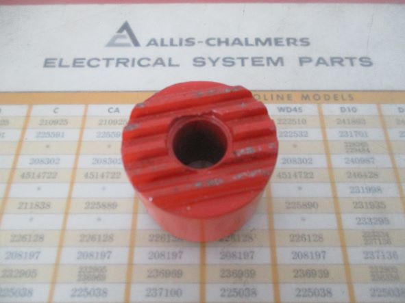

I need the serrated bushing that connects the twin arm to the sickle head on an 80 series mower .  It uses a 1/2 x 2inch fine threaded  # 8 bolt.  Please let me know where there might be one available.    Thank You !

Rich- Just sold my last NOS 804518 bushing last week, we tried making a brand new one but the serrations were a hair off. Give me a couple weeks yet, I hope to be in the $50 or less ballpark.

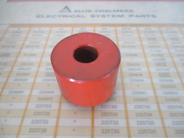

#11 is the bushing. Later were grooved face, earlier were smooth face to mate with the knifehead.

Serrations on top/bottom..... or the OD ?

The serrations on bottom of bushing, mates with the serrations on top of knife head. This puts load on bushing, not bolt. HTH Tracy

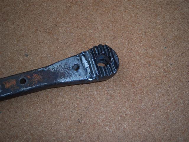

This is what the serrated knifehead looks like.....I had just broken mine and had to weld it back together.

Make sure the bushing fits snugly inside the cross arms,if the bushing and/or cross arms have much wear it'll let the bushing move back and forth some and end up breaking the
knife head and/or the bolt.Also make sure the bushing slots are mated to the slots on the knife.

We have the 804518 serrated bushings available now, it took us a while to get the serrations correct. They are heat treated just like the originals. I have one on my 80s mower and have been using it to make sure it fits and functions properly. Price is $93. Be sure to use flat washer 920309, lock washer 916966 and proper grade 8 bolt 805306-->927236 to keep the bolt and bushing tight against sickle.
