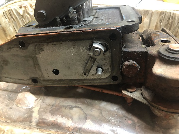

I've updated the title of this thread now that I'm into the hydraulic pump - following Hunt4Allis's footsteps there. Original post follows:

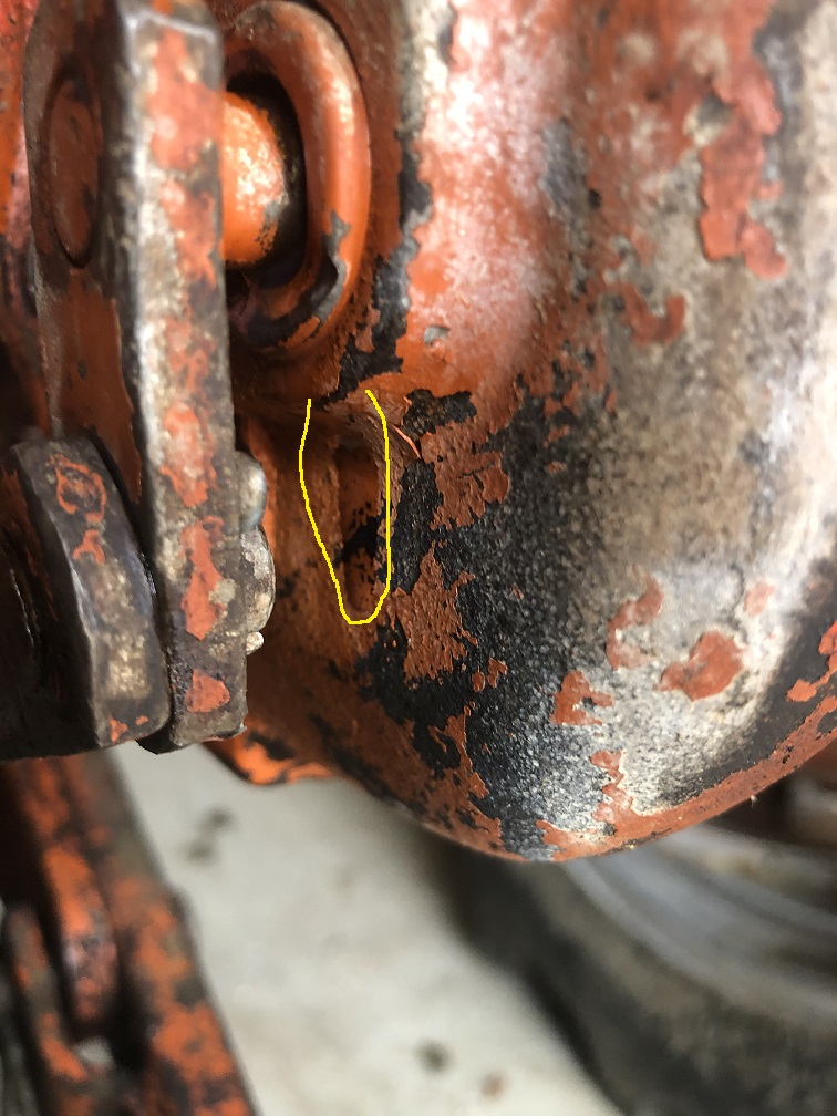

I previously posted about a leak in the hydraulic pump on my CA. After studying the parts diagrams, I realized that the leak is in the hydraulic pump drawbar control - similar but different. It's leaking at the inner side regulating shaft oil seal, #3 in the diagram found on p120 of the Agco CA Parts Book. [I haven't figured out how to post a screen shot of the online parts book yet.] The photo below shows the leak at the oil seal:
The area circled in yellow shows the oil on the housing shortly after the leak appeared. The metal casing of the seal appears to have been damaged - possibly the cause of the leak? New seal is on order from Sandy Lake. Interesting that oil doesn't leak when the pump is running - finally saw it start after I shut off the tractor.
More to come.

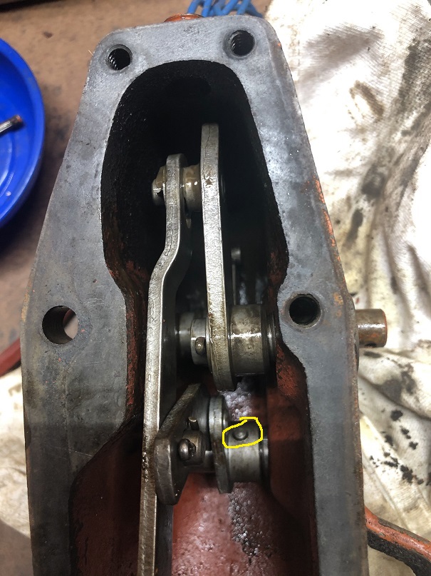

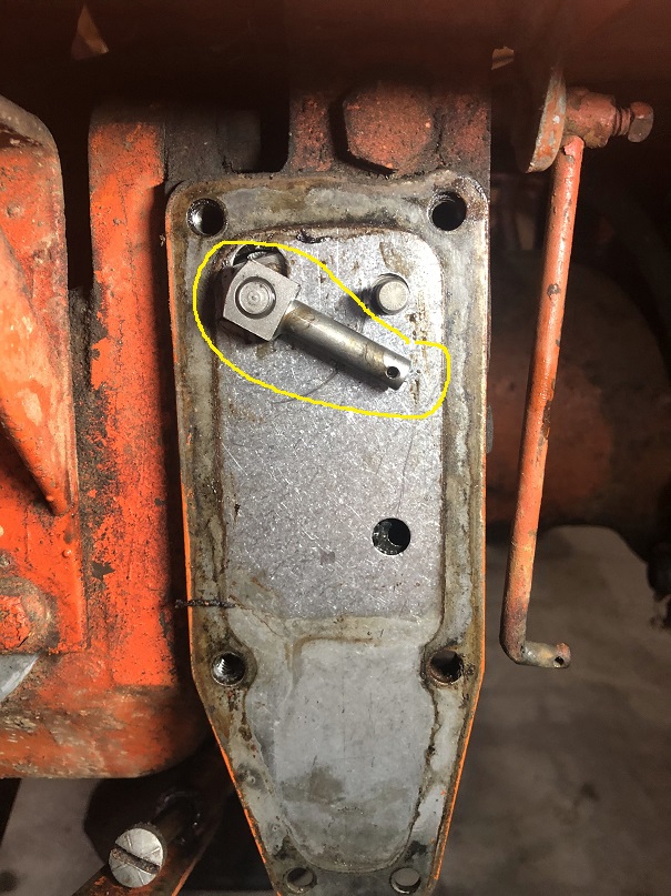

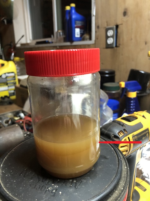

Today's project was to remove the Control unit from the tractor.

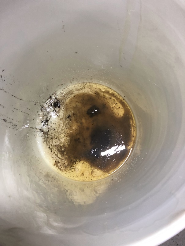

Started by removing the plug from the bottom of the control housing. Nasty glop oozed out into the pail:
I hope the inside of the pump is in better shape!
There are two arms attached to the control: the arm that reaches down to the Snap Coupler and the raise/lower arm. Removed the two cotter pins attaching them to the control. There are six bolts that attach the control to the hydraulic pump - 3 pairs - easy to tell each pair apart.
The control is attached to the pump via the control valve lever which is secured to an arm from the pump with another cotter pin.

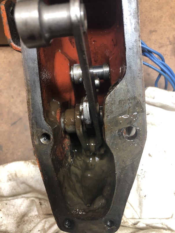

And here's what I found inside the housing:

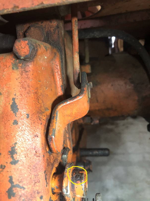

Had to remove the lockout arm - drove the pin circled in yellow out:
And then this pin in the regulating shaft:

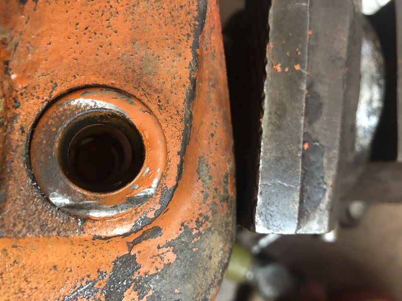

Which allowed me to drive the regulating shaft out of the housing so I could remove the oil seal. Here's a shot of the dinged seal:

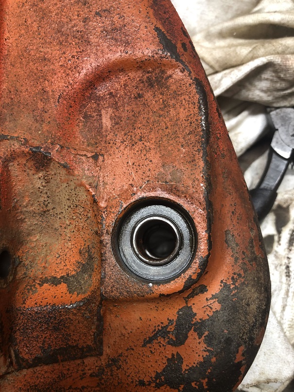

With the seal removed, here's the recess in the housing:

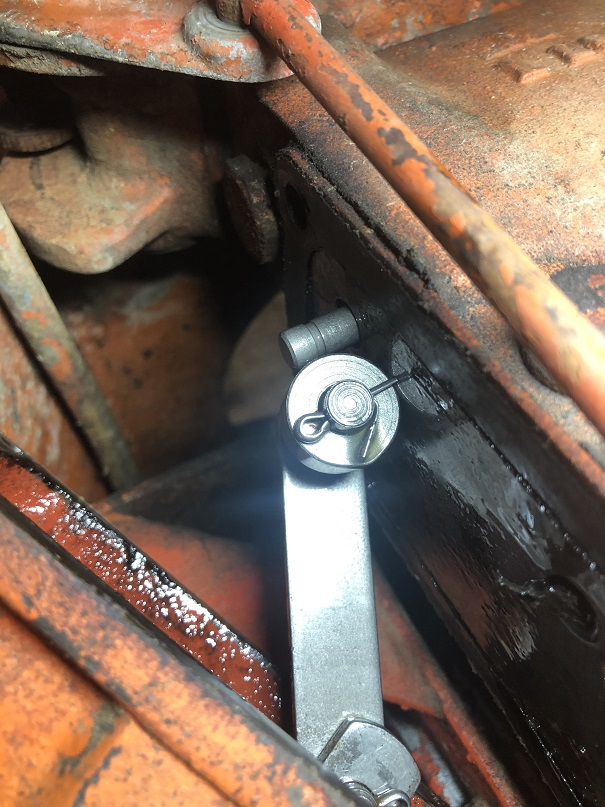

Here is a picture of the arm from the pump that engages the control unit. There's no pin holding it in place. Anyone know if/how it comes off or what secures it to the shaft? Maybe a key?
Now waiting for the new seal to arrive from Sandy Lake. Stay tuned!

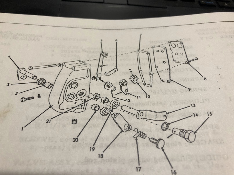

Here's the parts diagram that I'm referring to below:
I gently drove the new seal (#3) into place, reinstalled the regulating shaft (#4), sliding the regulating lever (#12) on as I did so and pinned it in place. Pinned the lockout arm assembly (#18) onto the other end of the shaft. Reinserted the pivot screw (#15) and the cotter pin that secures the hand control lever (#10) onto the screw. Done....
....until I started to wonder whether I'd installed the regulating lever the right way (orientation to the regulating shaft) or the wrong way - 180 degrees around the shaft. While it's hard to know if it'd actually fit into the housing if installed wrong, this was not a good moment. While I had taken a bunch of pictures, I didn't have one that showed me enough to know that I had the lever installed right. With the excellent help of Hunt4Allis who's rehabbing his CA hydraulic pump and sent me some pictures, I found that I'd installed it correctly. Whew!
Decided that I would pull the hydraulic pump and check it out to see why it is so slow to raise the arms first time around in the day. Drained the oil. Ugh. Not as bad as it could be, but I'm seeing evidence of water mixed in there. Here's a picture of a sample after sitting a few hours - you can see the liquids starting to separate at the line about 0.5" below the surface - at the red line. More fun to come!

Does anyone know whether having water in the oil could cause the sluggish behavior I'm seeing after the tractor has been sitting a while? I've read that water in the oil can increase cavitation, but I'd think that the effect of that would be continuous, and in my case the sluggishness goes away after the arms have been raised once. Just wondering!

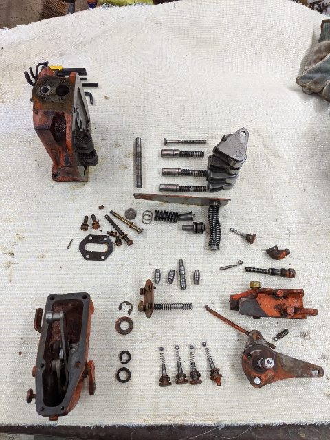

Pretty soon your bench will look like this🤪good luck( lots of pictures and keep everything layed out in order of how it came apart...

Matt - that is impressive! I'll try to be as organized. Smile I gather that you were able to drive out the cam follower pin?

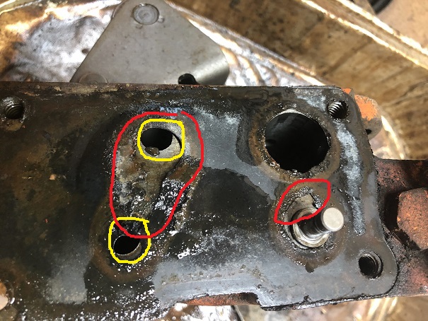

Removed the hydraulic pump from the CA today. It went pretty well - here 'tis sitting in an old roasting pan waiting for dissection:

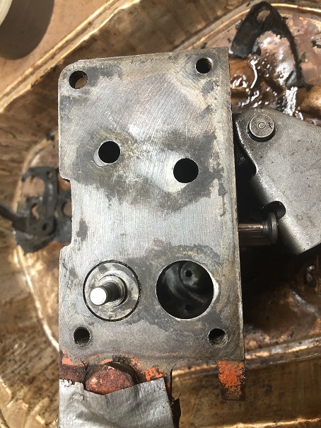

Having read Hunt4Allis's posts, I removed the housing cover plate and found that the gasket between the plate and the pump has had a hard life. At least two of the pump openings were partly blocked, and parts of the gasket are gone. I've circled the blocked spots in yellow and the missing material areas in red; the larger area marked in red looks as though oil could get from one opening to another - not sure that this is a serious issue, but it's not supposed to be that way!
The gasket was glued to the pump surface - came off HARD! Here's the surface cleaned up:
I'm thinking that polishing it so the darker "stains" are gone would be good, but then I'll really need to take everything apart to get all the grit out.

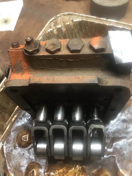

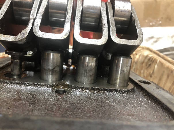

Here are the plungers before any cleanup. I don't see or feel any scratches or dings, but others may see some!
Here are discharge valve plugs. Anyone know what the small allen screw plug at the left is about? It is in the parts diagram but w/o any description:

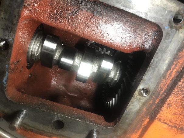

Last step today was to dung out the cavity that drives the pump. Actually wasn't too gunky in there. Some carb cleaner, compressed air and a rag helped a lot.
The big question of the day: is the gasket between the housing cover and pump body supposed to be glued in place?
Comments and suggestions welcome!!

It's probably better than my gasket which was never installed which is probably why there was so much oil/ crud everywhere at the back of my tractor all the time(I thought I had found the problem when I fixed one of the hydraulic cylinder hoses a while back but now I'm questioning if it was the lack of a gasket the whole time...)

The allan grub plug screw 'might' be a port to install a pressure gauge ? Just a guess, been 15-20 years since I did my CA.....sigh WHERE did the time go ?
