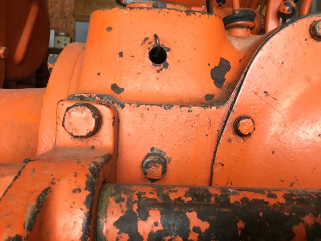

There you go. Left side in middle of pic. Can hardly see it. I really struggle getting these pics on here but this is good practice! 😀  Above the square set screw on the flat just below the line. Mine is 175421. I can see it all with a good light shining on an angle and maybe my close up glasses on. LOL.

Brian the pic is right above your message! 😀. Let me know if it is not showing. Was posted from iPad.

Location in pic. above is the only place you will find the numbers. ---If it aint there---you aint got one!  ---- Tractor may have been stolen sometime in its life which would mean no number.

I don’t see a WD on mine. I will take another look but it was painted many years ago so maybe too much paint.
Just took a good look at the original pic on my iPad and yes the WD is there! Just to left of the first digit. Very faint and a bit smaller than the numbers. Maybe done in different way. Harder to see in post - pic was downsized.

I see WD Big smile

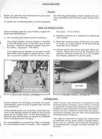

As I (and Mack) said, early WD #s were sometimes near or under the RH side of the LH brake cover on the top of the housing.
I know that sometime in the past someone posted a picture of a number there but I don't know where to find it.  I remember someone posting a picture of the number on the hydraulic pump also but  don't know where to find that either.
The only place I have seen the number myself is where Ed (Ont) shows it in his picture.
However, the "Operating Instructions and Parts Illustrations" for the "MODEL WD-45 TRACTOR" shows the location in two places. I'm assuming in one of either of the two
places.
