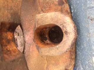

D17 front support seems to be wallowed out.  Not sure how much build it up.  Anyone have a picture or measurement would be helpful?  I am guessing if too tight it will be hard to put back.  Thanks, Keith

Surely the pin that goes into that hole is worn out too ???

Doc , can that be bored , machined , drilled out and have a bushing installed ? And yes then have the other end built up .

It may need to be welded up some and then bored and then a bushing installed. All depends how bad it is.

Makes no sense but the pin didn't wear much at all. thanks

The hole on our D-17 was in the same condition as the one in the photo. Over 20 years ago, I rebuilt it with Belzona 1111 (Super Metal) and a new bushing.
Replaced the worn out pivot pin with new pivot pin.
This tractor has a 500 loader.  Most of the time, it is used to move round bales.
