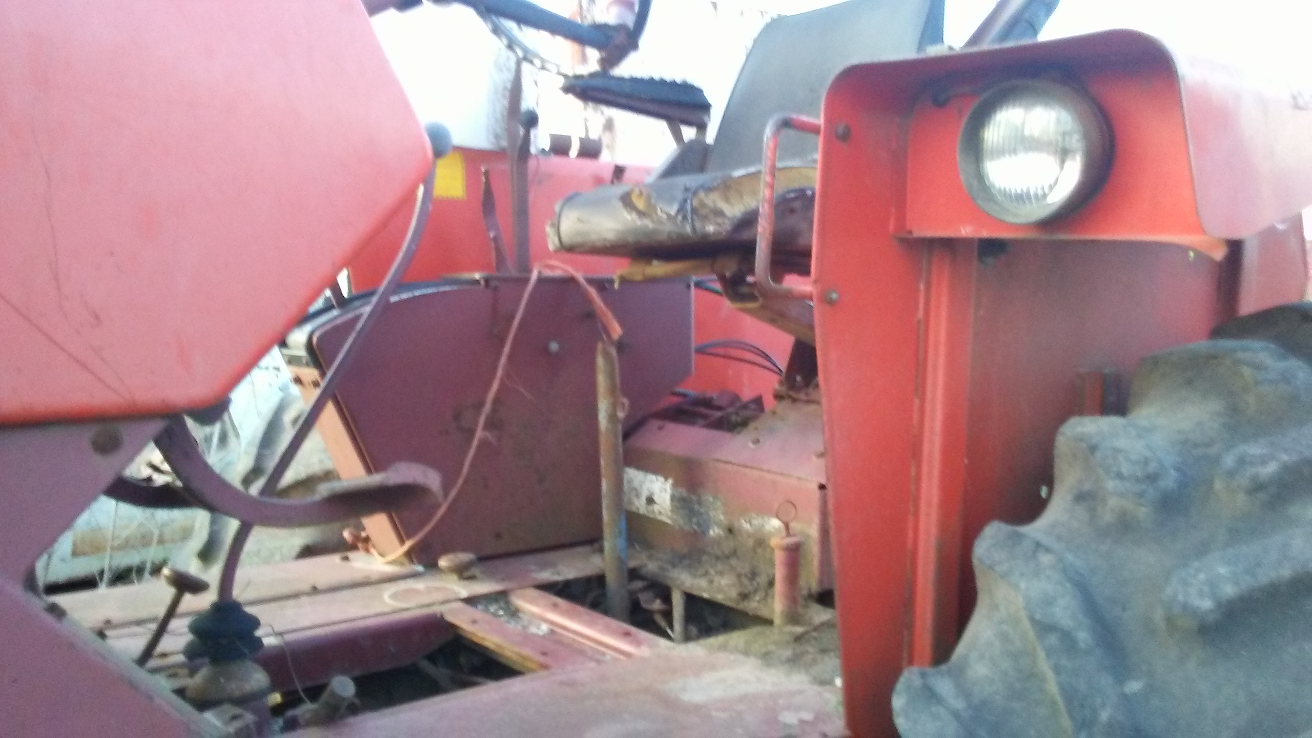

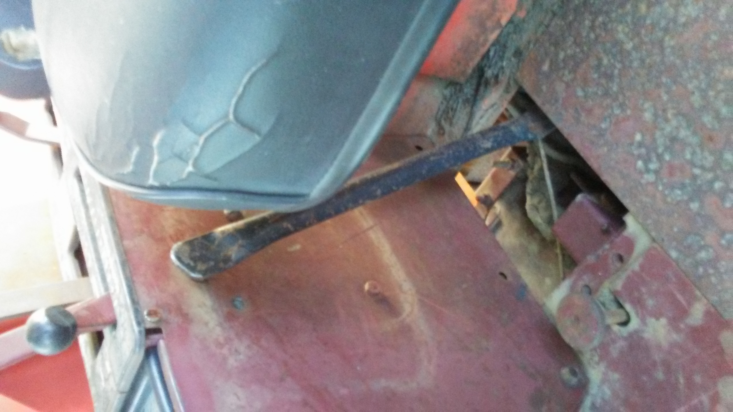

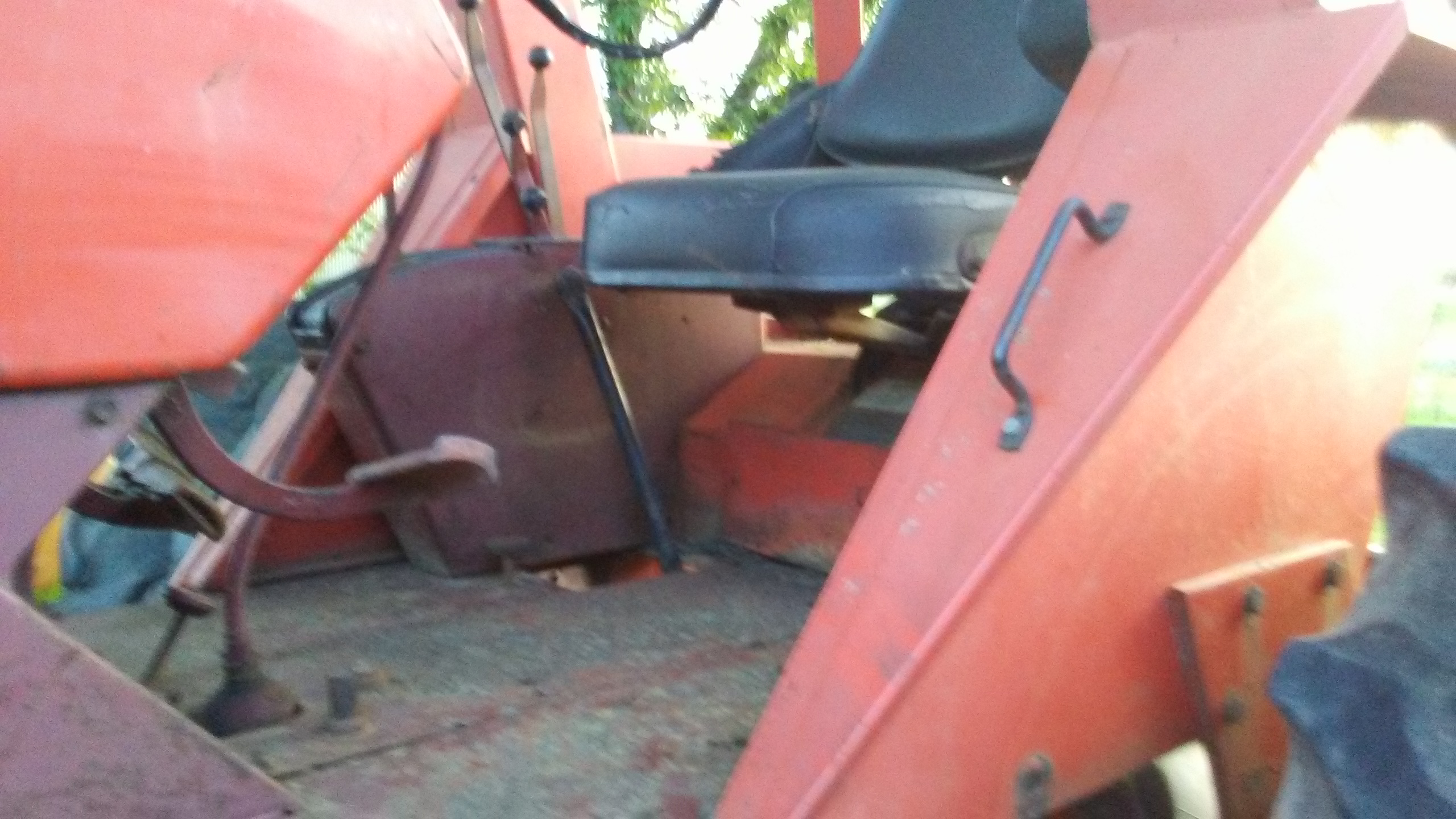

This is how i did it on my 7030. Not perfect but quick and simple

I thought it was a little classier than how this 7030 had been fixed by the previous owner but i guess it still got the job done

Post Options Post Options   Thanks (0) Thanks(0)   Quote Michael V (NM) Quote  Post ReplyReply Direct Link To This Post Posted: 06 May 2018 at 10:50pm
that is very similar to the 7030 I seen sell at an auction a few years ago, cept they had put a truck shifter boot on it,, that sorta made it look a little more professional...
