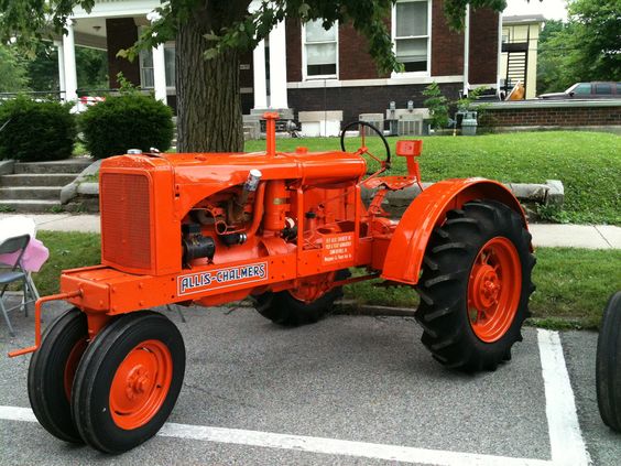

Herschal Surrat in West Central Illinois sold an early WC last October at Aumann Auctions and the wheels were green.  The auctioneer said they checked and the color was correct for that period.
