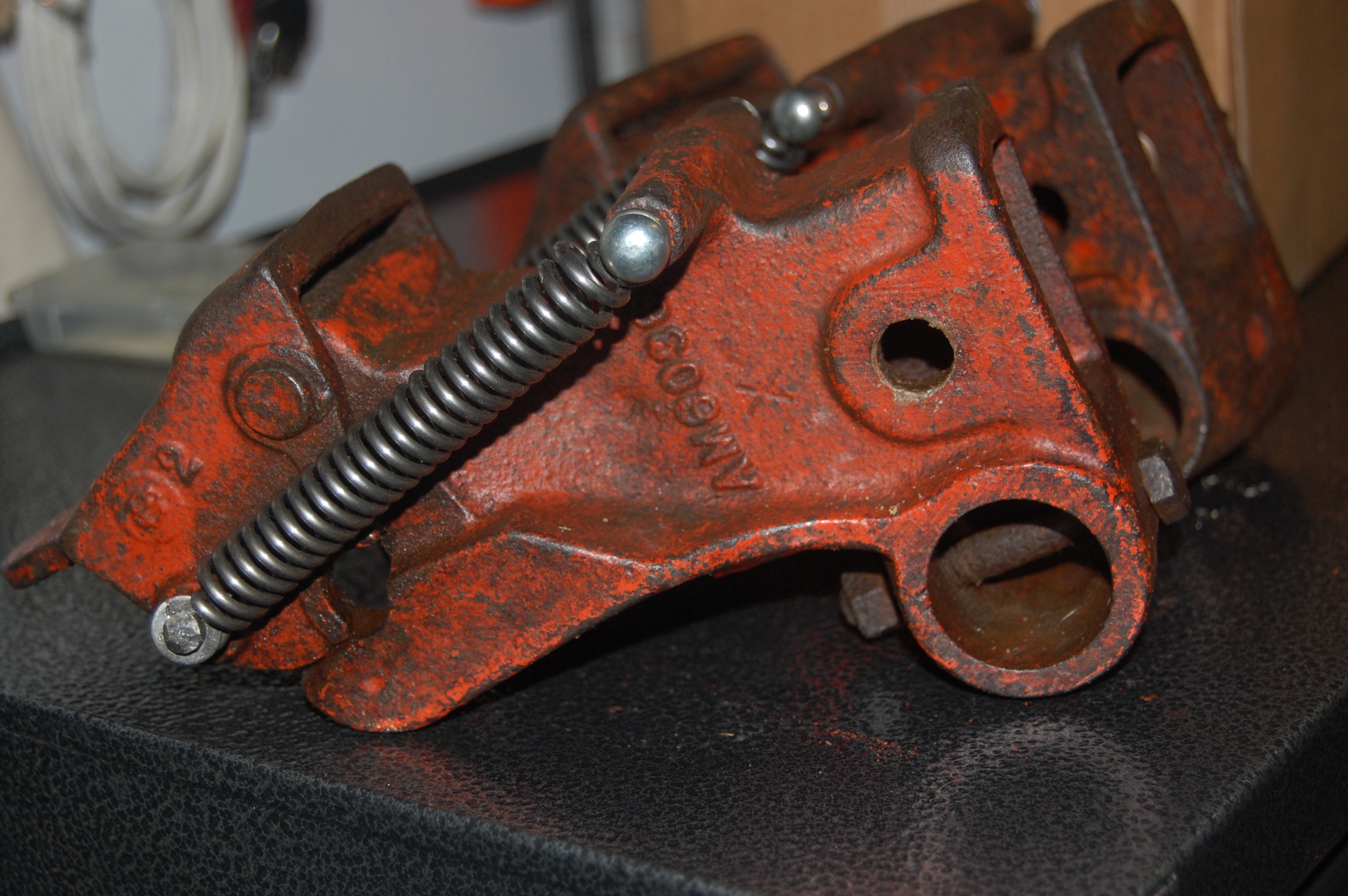

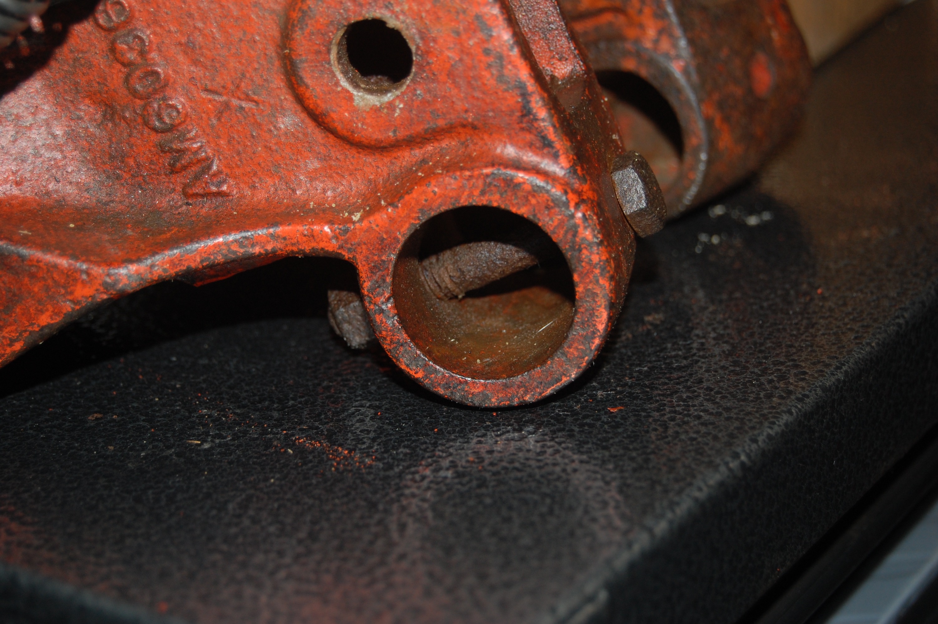

What is the 1 1/4" hole for in the couplers?  I have never seen them used.  I suppose you could put a pipe connecting the two together.  I have never seen an implement that used them.  Pictures or a description would be great.

Not a pipe, a solid bar.  used with heavy plows, IIRR, to stabilize the 2 arms...
