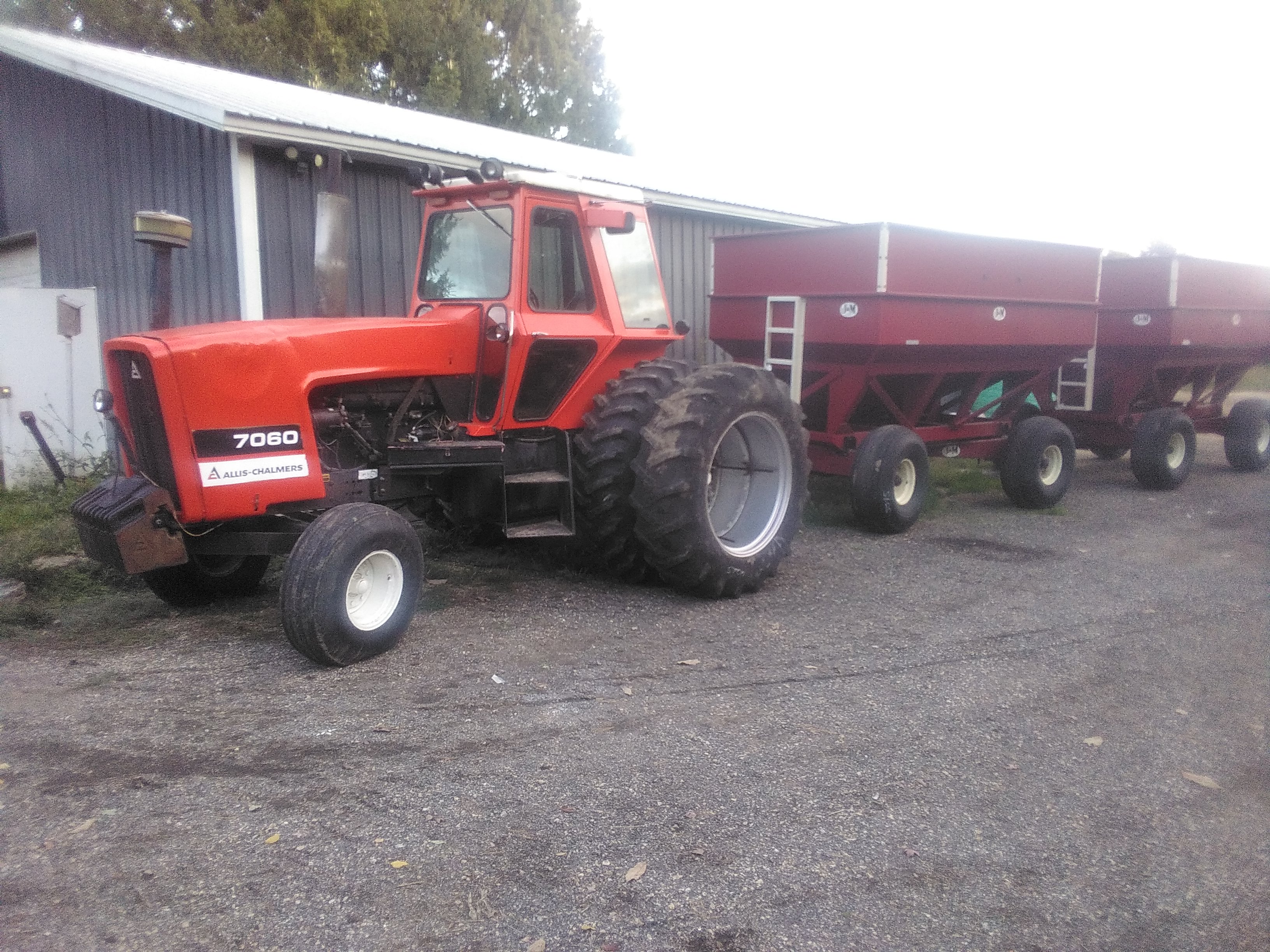

I bought off auction 2 JM 385 bu grain wagons. Like to pull with 7060 to elevator. Rears are 18.4 Both wagons have rear surge brakes. Slight up and down hill to navigate. Question is:should I put fluid in rears and/or put the duals on. Tractor has 600 lbs up front.

Follow up: Been busy with harvest , but thanks all who replied. So I stayed with my 18.4 , put fluid in, added my duals, fits scale, pit level once on, added full front weight, I keep bumping up bushel, last was 650, tractor handled fine, went 5th no PD. Next will do 700 bu. The incline it works tractor a bit , but not that hard. Level ground runs fine.
