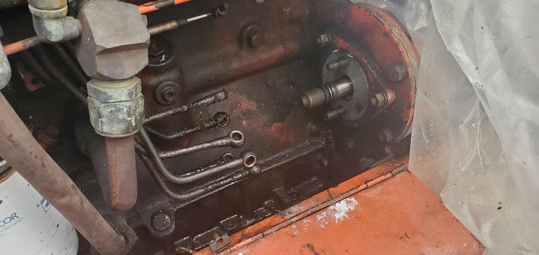

Post Options Post Options   Thanks (0) Thanks(0)   Quote Digit Quote  Post ReplyReply Direct Link To This Post Posted: 29 Mar 2022 at 2:18pm
  1.  Broken Pump Shaft is what I found. Forgot to post. Sending pump off to be rebuilt again. been too many years setting. Thanks

Post Options Post Options   Thanks (0) Thanks(0)   Quote injpumpEd Quote  Post ReplyReply Direct Link To This Post Posted: 29 Mar 2022 at 5:45pm
seized pump is never good. But that didn't have anything to do with it being out of time lol!

Post Options Post Options   Thanks (0) Thanks(0)   Quote John m Quote  Post ReplyReply Direct Link To This Post Posted: 30 Mar 2022 at 11:11am
So what would have caused this.
Points: 22807
Post Options Post Options   Thanks (0) Thanks(0)   Quote DrAllis Quote  Post ReplyReply Direct Link To This Post Posted: 30 Mar 2022 at 11:13am
The hydraulic "head" on the pump has seized/welded itself together. The drive shaft is designed to shear off like it did to protect the timing gears of the engine. A plugged injector or a big loader hanging on the side frames are the two most common reasons for seizure.

Post Options Post Options   Thanks (0) Thanks(0)   Quote injpumpEd Quote  Post ReplyReply Direct Link To This Post Posted: 30 Mar 2022 at 5:58pm
This one's failure is obviously crappy old fuel. Look how nasty the fuel side of the shaft is. Now, imagine pump parts with millionths of an inch of clearance are supposed to function properly in that environment, this is typically the result. People just continue to try and start them when it obviously doesn't want to pump fuel. If it is properly torn down and cleaned up before starting it, you can usually save them. The head and rotors for these are in stock, at 1300 just for the new head & rotor. I've used up many of my good used ones!
