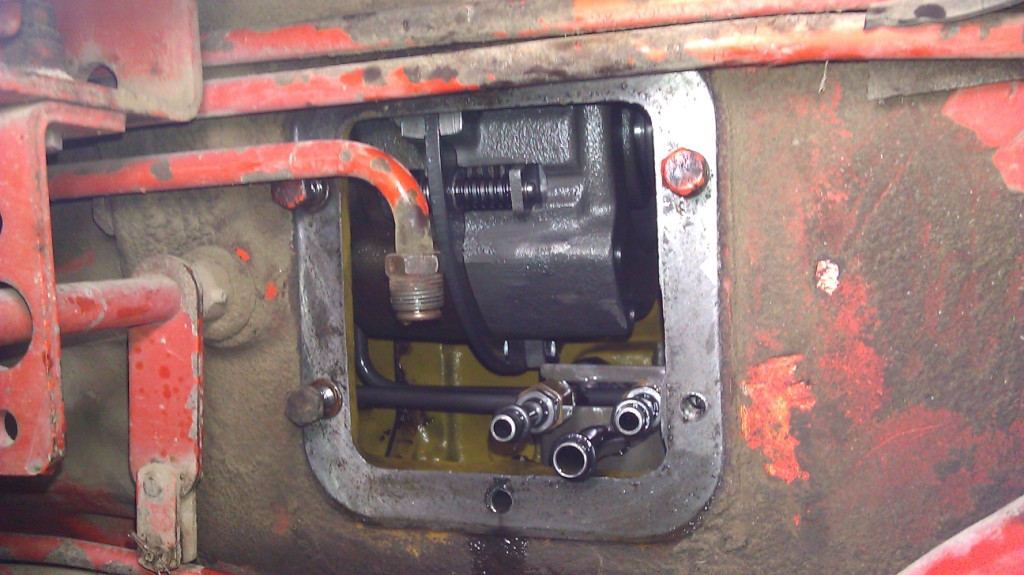

We cleaned the shop up and pulled the 190 in to figure out why the high-range wont work on the power director.
I checked the pressure on both ports on the valve, and had pressure when the stick was in low and high ranges
I have the valve and inspection plate removed, and can see the PD. The plates on the front of the PD have a bit of play (3/32"), and everything seems to look fine.
Anyone that can offer some input on this would be appreciated. I will split the tractor if I need to, but want to avoid it if possible.
Thanks!
Edited by Reed(UT) - 28 Dec 2011 at 7:07pm

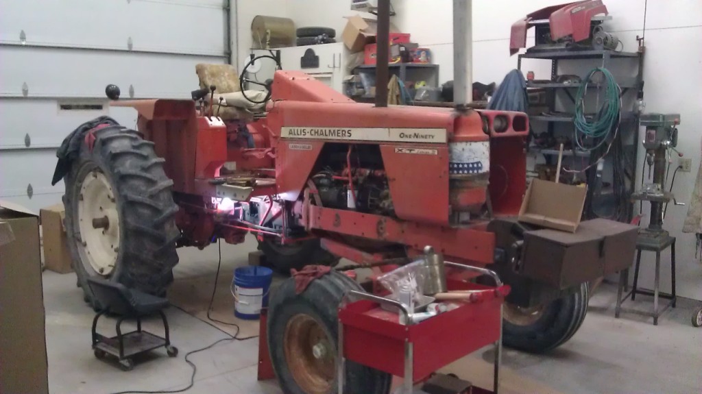

The above diagnosis is probably correct. You will have to split the tractor.
Don't go to all the work to remove the platform. After you have unhooked
all the necessary lines and connections, Take all the bolts out
holding the platform except the 2 in front. Take the nuts off and remove
the lock washers. Then put the nuts back on just even with the end of the
bolt. Jack up the back of the platform just far enough to clear. Make angle
iron supports and bolt them from platform to just touching the floor, but
in FRONT of the axles. Then you can proceed to split the tractor. Of course,
support the front half adequately. You must remove the short extensions
on the hydraulic lines that come out through the opening where you removed
the control valve.
  It is a bit complicated, but I'm sure you can figure out all the things you need
to take loose. When you get in there, taking the PD apart  is a process that
you need to make sure you follow the instructions in the repair manual, or
it won't come apart. I sure hope that is somewhat helpful information. Dean(IA)

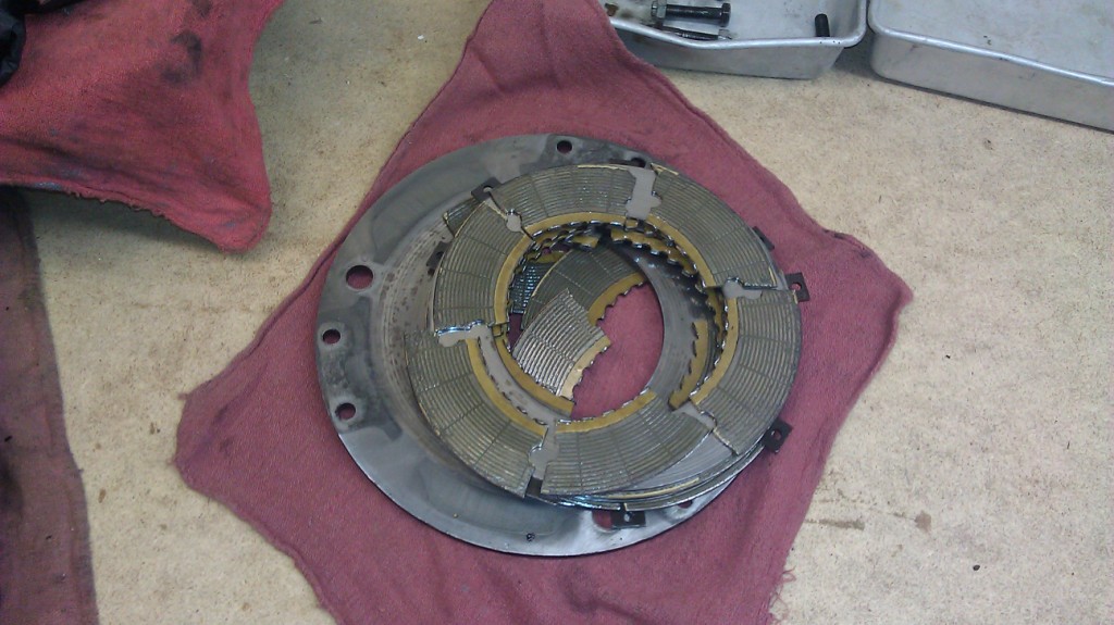

Post Options Post Options   Thanks (0) Thanks(0)   Quote Reed(UT) Quote  Post ReplyReply Direct Link To This Post Posted: 31 Dec 2011 at 4:44pm
It looks like all the high-side plates are broken.
Should I replace anything besides the high-side plates while I am in here? Mack, what is the torque tube shaft and gear?

A lot of people will tell you to replace them with the 7000 maroon belly power director plates, as they are much more durable.  Hang onto your pocketbook, though, they are pricy!  Not sure what the rule of thumb is for the separator plates.  My 7000 manual gives a thickness for them and says to check for abnormal wear and/or warpage.

If the seperator plates are not warped, I generally reuse them. I always replace all 9 discs with 70261212 (model 7000) discs. I myself have never replaced a clutch shaft in the torque housing for worn/loose splines on the driving gear which is blamed for broken discs. I've always used the 7000 clutch disc parts and have my Dad's 200 for example that has had them in it since 1979 (at 3000 hrs) and today it has 8000 hrs on it and has never had any problems with the PowerDirector clutch since the 7000 parts were installed....original clutch shaft and gear still in it.

The torque tube shaft is the inside shaft of the two when you look in torque tube from the rear. If the outer shaft turnes a long ways before inner shaft turnes, the gear and shaft is worn causing a vibration which breaks the Hi plates.
 If the plates Dr. Allis uses do the job, that would be the best way to go.  MACK
