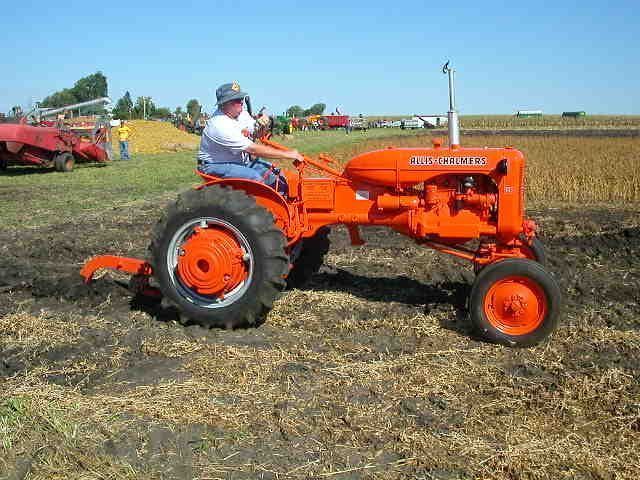

My CA with front & rear wheel weights plus engine side weights!
DeWayne

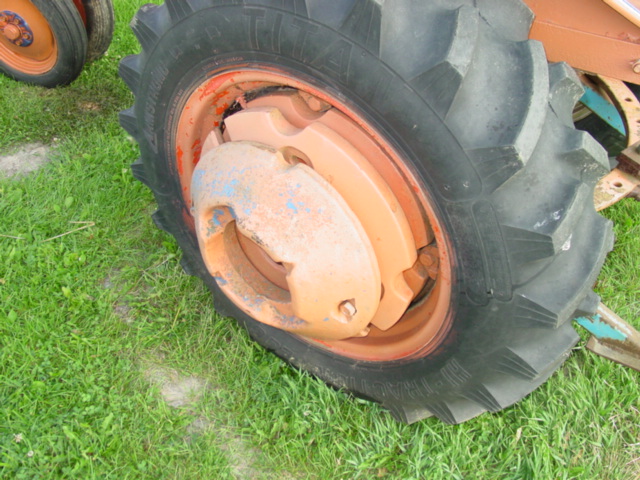

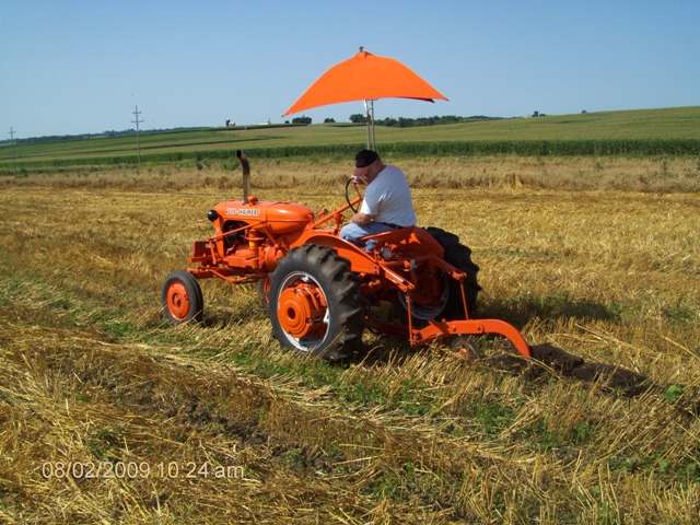

Like I said before, Dad had his tires loaded with two C wheel weights on each wheel, side engine weights both sides and a plank across the drawbar with sand bags on both sides behind the final drives as high as the top of the final drives. He farmed 148 acres of rolling hilly clay on the farm that laid in Ohio, Indiana and Michigan. Nothing broke because of the weight. I would guess the tractor weighed close to 4000 pounds. I pulled my C in the 3500 class some and the rear tires were not loaded. I used three sets of wheel weights with loaded front tires and used a CA front to add a hunk of steel as an extra front weight. I also cut bars of hot roll to stack under the seat to make heaver weights.
weighted to 3000 pounds in the picture.
My narrow front B weighted to 3000 pounds.

The tapered C weights are 100 pounds each. I have them on the inside and outside of the wheel. 200 pounds on a side. I have studs sticking out to put the third set on. The weights on the B are 125 pounds each that you see in the picture. Using pipe spacers and washers you can use those on a C as well. the holes line up.
