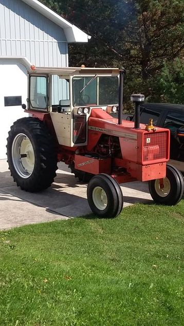

Good morning. I will be removing the cab off of the 190. I have limited head room and lifting choices. My old AC sales manual says:
                                      200 tractor cab weighs 1705 #
                                      190 tractor cab weighs 781 #
                                      7030 tractor cab weighs 691 #
                                      7050 tractor cab weighs 679 #.
   Why the difference between the 200 and the 190?
   Can I count on the weight being under 800 pounds?
   Ross.

Nice looking One-Ninety XT. Is there a stuffed tiger sitting on the front of its hood?
Ross D. View Drop Down
Joined: 02 Sep 2013
Location: Erin, Ont.
Points: 339
Post Options Post Options   Thanks (0) Thanks(0)   Quote Ross D. Quote  Post ReplyReply Direct Link To This Post Posted: 17 Jul 2019 at 1:19pm
   LOL.   Not a tiger, that is a 'Crushed Kitty'.      Ross.
