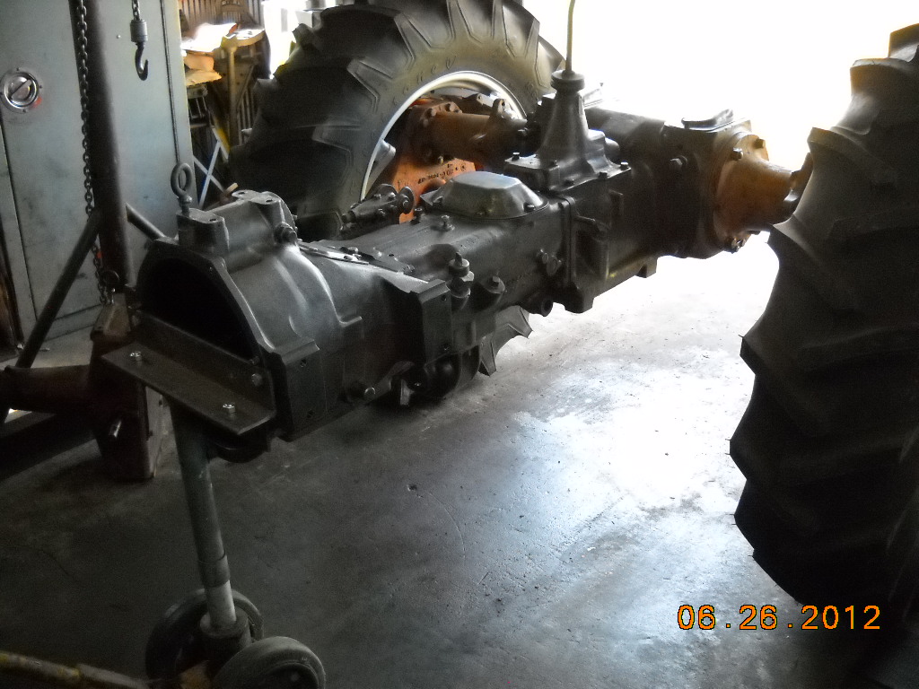

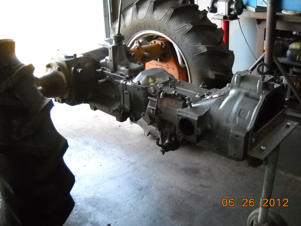

OUTSTANDING!  Is it just you working on it?

   I was thinking the same thing when I saw what he had holding up the tractor,simple yet effective

The front wheels were made up for a B that I repainted so I did a little remodeling to fit the WD-45.
Just myself working on this project, most of the small parts are done. The main frame, side rails and engine are about ready for prime and paint.

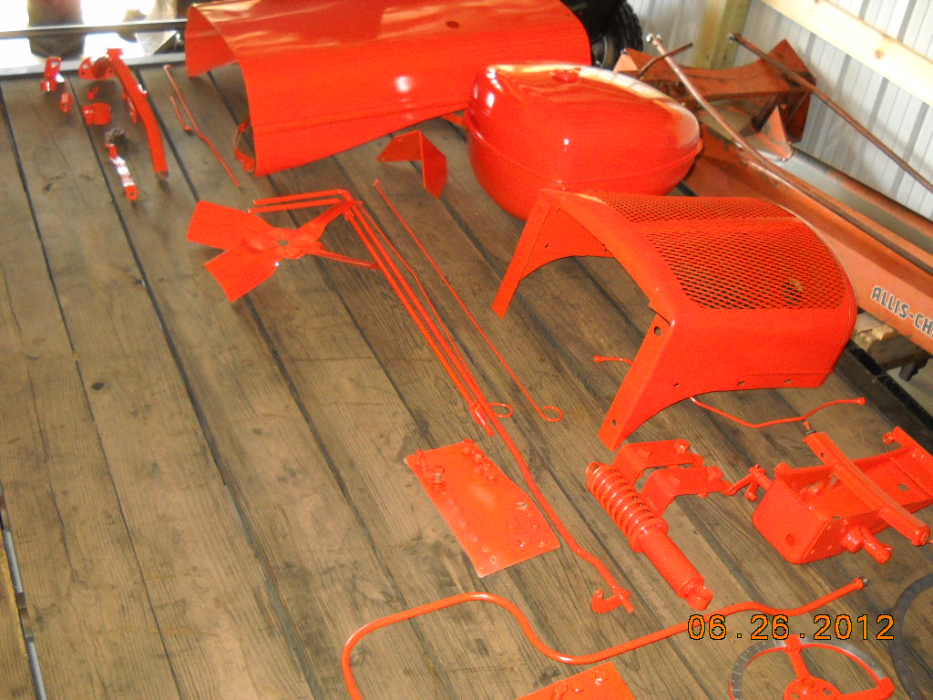

even the tires look gorgeous.

Harry you are on the final stretch and it looks great. Thumbs Up I'm taking notes on that front wheeled stand as I'll be splitting mine this fall/winter.

do what I did and paint the whole steering wheel, how they came from the factory.
But they look better in black! Tongue

Post Options Post Options   Thanks (0) Thanks(0)   Quote AC WD45 Quote  Post ReplyReply Direct Link To This Post Posted: 28 Jun 2012 at 10:21pm
factory looks better. IMO

They were not all orange from the factory, unless the dealer stripped ours before he delivered them in 1947, 1952, and 1954.

I like the stand too!

Yep, I like seeing how guys deal with splitting and work-support.  Wish my shop had a glassy-smooth floor to roll stuff around (sigh)... that will eventually come, but for now, it's hard-packed lime atop gravel.  At least it's fairly smooth.
Harry- what was your prep/cleaning method for the driveline?  Pressure wash?  Media blasting?  Wire brush?

Dave- I pressure washed to get most of the grease and dirt off than used a wire wheel on the main gear along with help from a needle scaler in the places where the wire cup brush couldn't get into. Before priming I will wash it down with simple green to get the oil off.
All of the other parts that did not have bearings or seals were sand blasted.
all factory pics ive seen were orange
