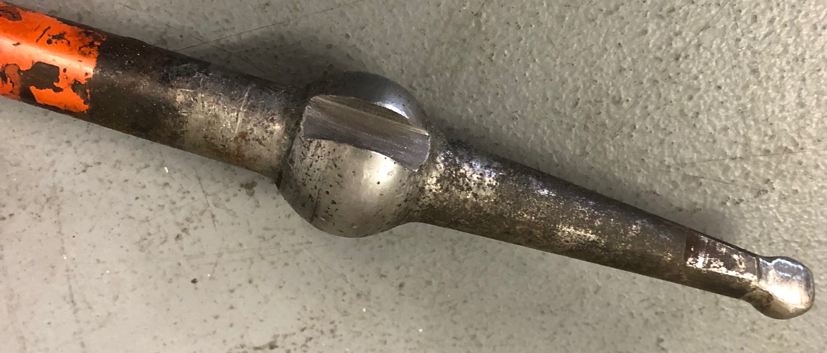

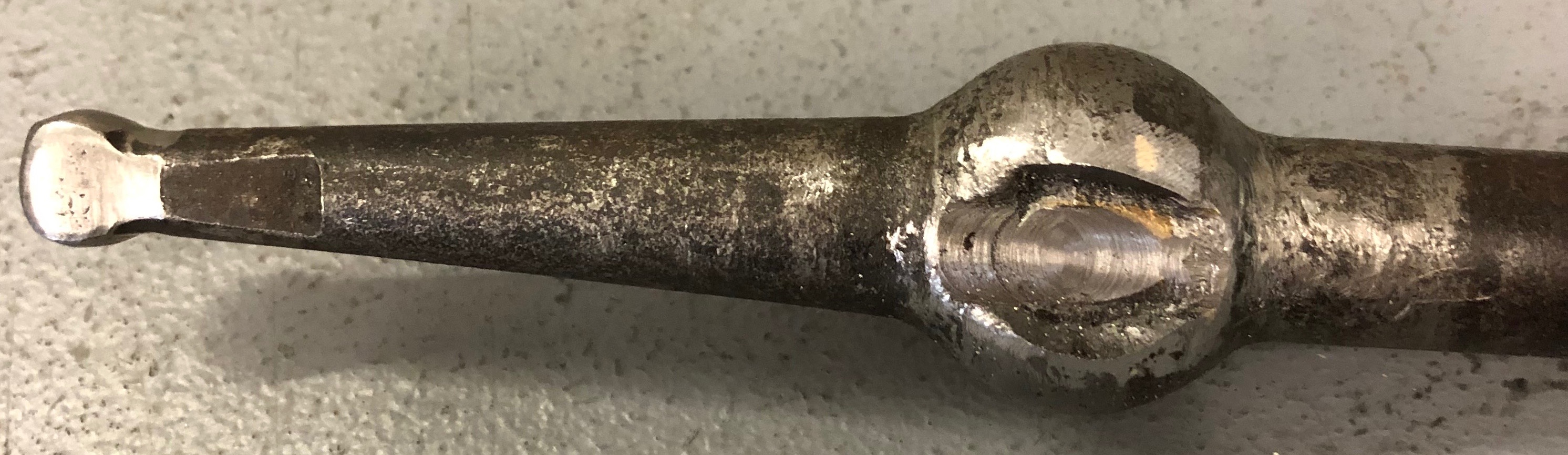

I've also got some shifter work to do, I've added a second slot to the shifter ball and cut a few new pins, I just need to weld up the old slot after I finish cleaning out some braze from a previous repair. Hopefully I can get away without removing the tower for rework but I'll take it one step at a time. Many thanks to Sugarmaker and others for their help.

 Welcome. Keep us informed of your progress. While the shift lever is out take a good look down in the tower. Look for worn areas on the forks. Is it a WD? Yes a mig welder should work just fine and better than braze to form a new slot.
