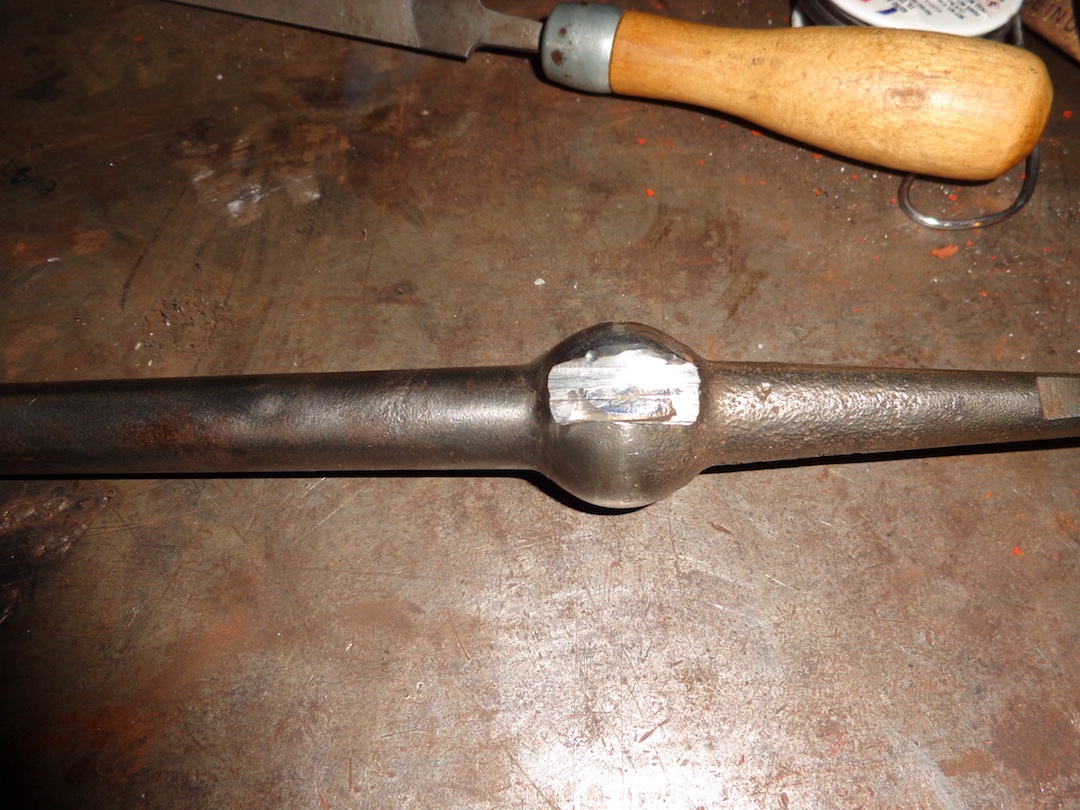

Hey Chris, could I just take one off a parts machine, box it up and send it your way? I need to go through one for the wide-front but this looks time consuming. I could pay with firewood, though shipping would likely be impractical!
Mike,
 This wasn't as bad as I thought it would be! I had maybe 8 hours playing with it. Probably took me longer to document it on here than to do the work!
Not sure I am into rebuilding them yet or ever, but there could be a need just like clutches. Sandy Lake is refurbing these. They probably put in a new shift lever and new side pins which could be $120 in parts.

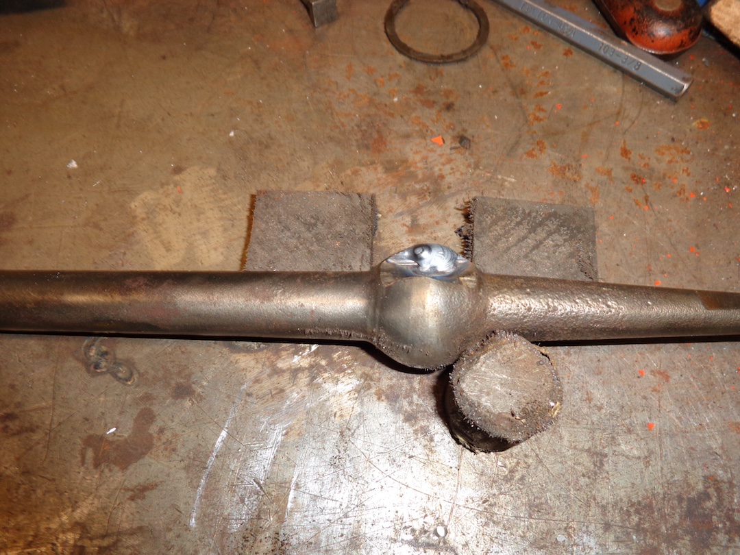

This is pretty incredible. I know I have shifter problems pretty bad on one of my WDs, and I should really deep dive into it.
Did you build these all up with mig wire and then dremel them to dimension? Very impressive.

GG, Folks,
 I have a welding problem, I will admit to that! I come buy it honestly. My dad taught me to stick weld with a old Lincoln welder 60 years ago. And my uncle welded everything to fix it. I got the welding gene too. I do try to restrain my self but sometimes it is the right way. So yes I welded the lugs and shift lever and then used a die grinder with the 2 inch screw on sanding discs to finish back close to what it may have been when new.

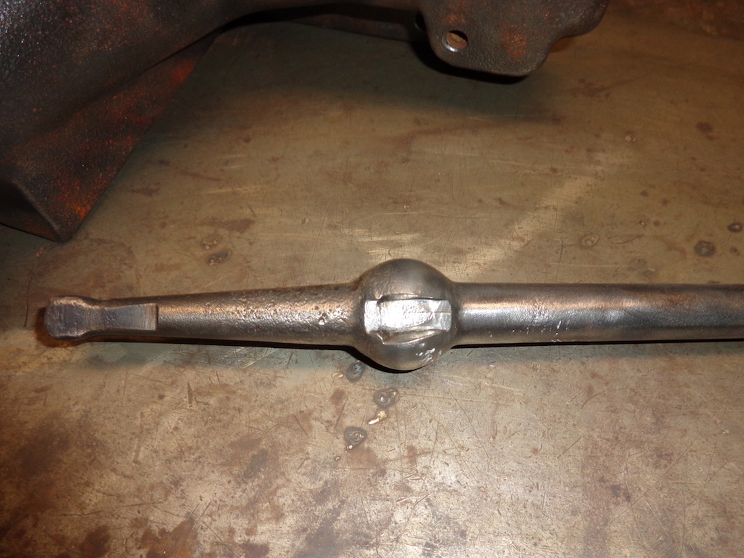

 Update on the shift tower repairs and function.
(Put all the items back together/ on the tractor this morning)
Cheryl and I took the 45 and trailer down the yard to pick up the trimmed branches from the apple trees.
I used first and second gear. First gear engagement needs to have the engine turn the transmission just a little to engage. Seems like that's about how its going to be. Second gear is very smooth to engage.
The whole feel of the shifting is smooth and crisp. Very little movement in the shift lever.
On the way back to the house, I got out in the road and got into third and then sliped into fourth gear with out effort. Very smooth! Into the drive and stopped and shifted easy back into third. No issues! Shifter felt solid and stayed in position with no slopping around.
When I got the trailer un hooked I tested reverse and the spring loaded "keep out tab" worked very good. Was able to over come the spring and engage reverse easily and smoothly.
I also tried to push the shift lever more forward when in third gear and did not have any additional movement. Now the shift lever might have been up against the custom washer below the snap ring?
All in all, I am happy with the WD45 shift tower repairs. Thanks for watching! If I can help let me know.
