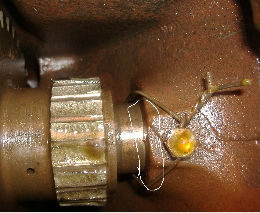

I got a notification that this thread came back to life.  Don't know that I can add much, but I want to ask SteveM about his method, to see if I can picture it.
SteveM, do I understand correctly that you were working on your back and going up from underneath?  If so, then was your pry point on the front (end of tractor) on the intermediate gear?  Did you find that as the shaft crept forward, it left a space in the cast housing bore that allowed you to insert 1/3 moon thin spacers that allowed you to fit a pry between the washer (or spacer) of the gear and actually pry into the bore via the spacer?
It was a very long time ago that I did this job, and mine came relatively easy, so I did not use the opportunity to see if pry space was created.  It is hard to create a picture with words, but if I can picture what you did, Allis Wd45 likely can too.

Post Options Post Options   Thanks (0) Thanks(0)   Quote SteveM C/IL Quote  Post ReplyReply Direct Link To This Post Posted: 19 Apr 2020 at 8:29pm
You got it. The front of shaft is larger diameter and protrudes past bore. Remove lock and pry gear fwd. Now you have room to insert spacer between shaft head and washer. Pry gear again. Repeat. You keep pushing shaft fwd. First one I did slid easy by hand. This one took a while. Removing frame rail is waste of time. You can force pump rollers by top of hsg. To install easy flatten some 1/8in wire/nail,push roller against the body and insert nail in edge of lever by pivot. When back in the hole pull nails out of levers. My dad apparently never knew the nail trick because he had a piece of bent tin he put over gasket and forced the pump back in. He worked on a bunch over the yrs.

Post Options Post Options   Thanks (0) Thanks(0)   Quote stu(ON) Quote  Post ReplyReply Direct Link To This Post Posted: 19 Apr 2020 at 8:57pm
Let's see if I can do this from an old pic.
Viola

Post Options Post Options   Thanks (0) Thanks(0)   Quote Allis Wd45 Quote  Post ReplyReply Direct Link To This Post Posted: 20 Apr 2020 at 1:17am
Steve, i just saw your reply my uncle stopped by tonight and I had him take a look. Did exactly as you said and with 3 spacers made out of a piece of pipe it slid right out. Thanks a bunch guys now to get it all lined up and back in place.
