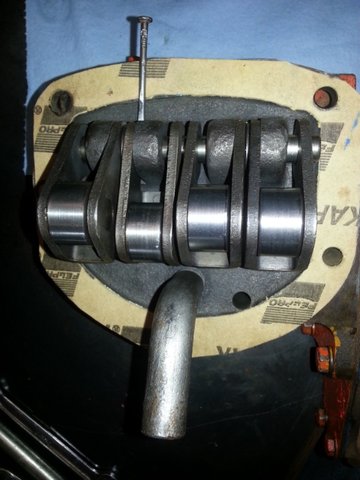

You can get it off without removing the frame rail, but you have to depress and hold the cam followers, two short 1/4 in bolts flattened and inserted at the pivot points will work.  You may have to cut the heads off the bolts.

Four fingers on the four pumping plungers and it will come right out. No problem.        MACK

4 of8 or 10 penny nails flattened a little and bent just a hair inserted between each roller arm and housing. Then pump will slip in .

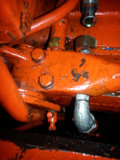

As others have said, It will come out and go back in without taking off the rail. Just need to wiggle it in and out. The pickup tube bends downward from the bottom so you will need to pick it up and tilt it so it will clear. The hold valve unbolts from the top. I found it easier for me to disconnect one line at the adapter on the back of the hold valve and the others can be disconnected at a swivel connection on the other end of the hose.
Also seems like i may have double nutted a couple mounting studs to remove them and that gave me a little more clearance. It's been a few years though. Hard for me to remember things from yesterday. LoL...
After thinking a bit. It may have just been the bottom stud i took out. Seemed to make it a little easier going back in.

take pto shifter off. remove pump out the bottom .put in from the top. push plungers in with fingers lay pump in rail put gasket on studs push in on pump put on nuts .that is how I do them
