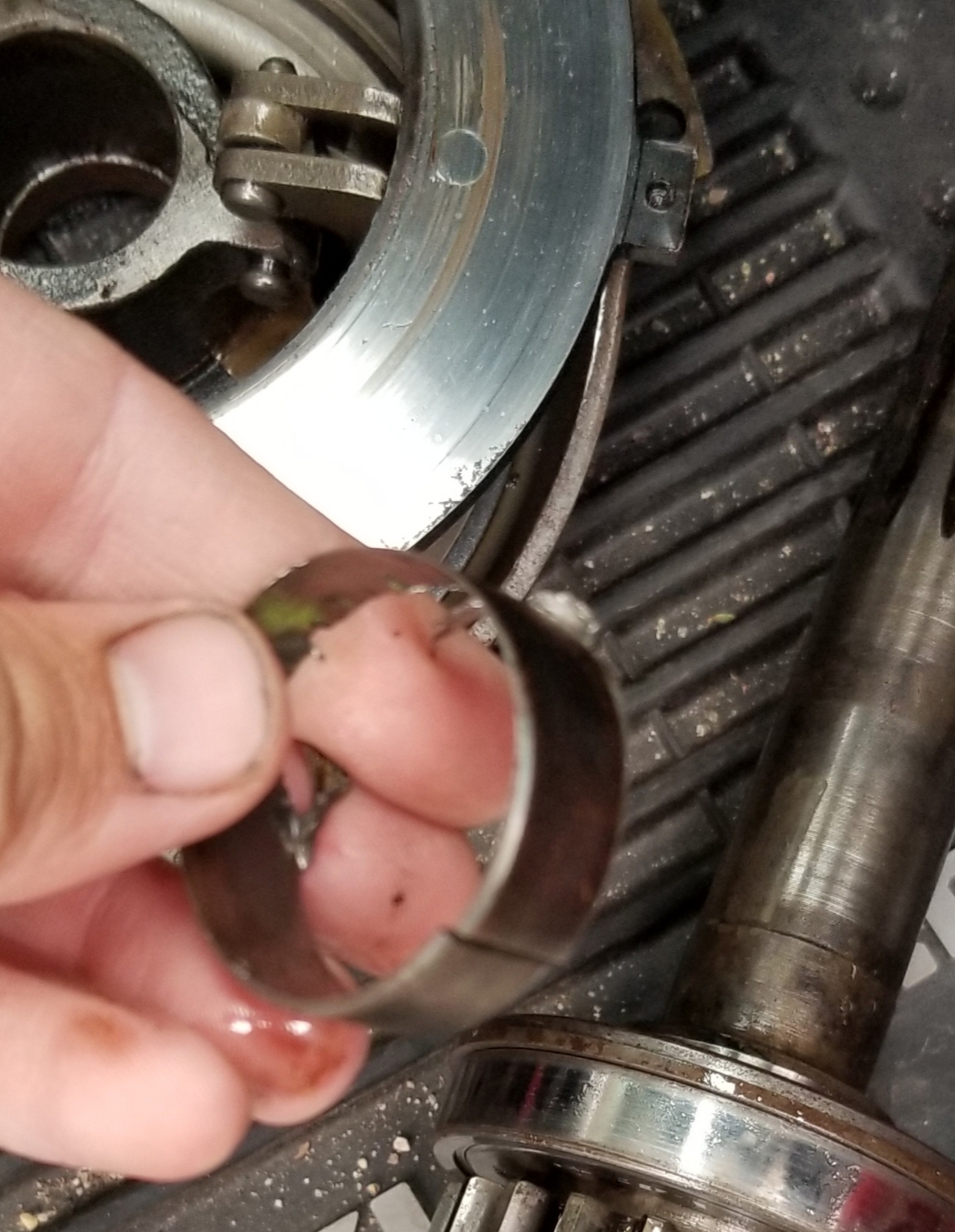

Hey everyone,
I am working on a WD and noticed I have 1 shifter bushing that needs replacing in the hand clutch assembly.  Does anyone know where I can source one of these?

Post Options Post Options   Thanks (0) Thanks(0)   Quote jhendy18 Quote  Post ReplyReply Direct Link To This Post Posted: 09 Sep 2020 at 9:04pm
Hey Chris,
They are inside of the clutch shifter assembly, where it slides over the transmission shaft. I attempted to upload a picture here let me know if you can see it, if not I'll try to upload one from a computer tomorrow. 20200909_210033_2020-09-09_21-02-57.jpg

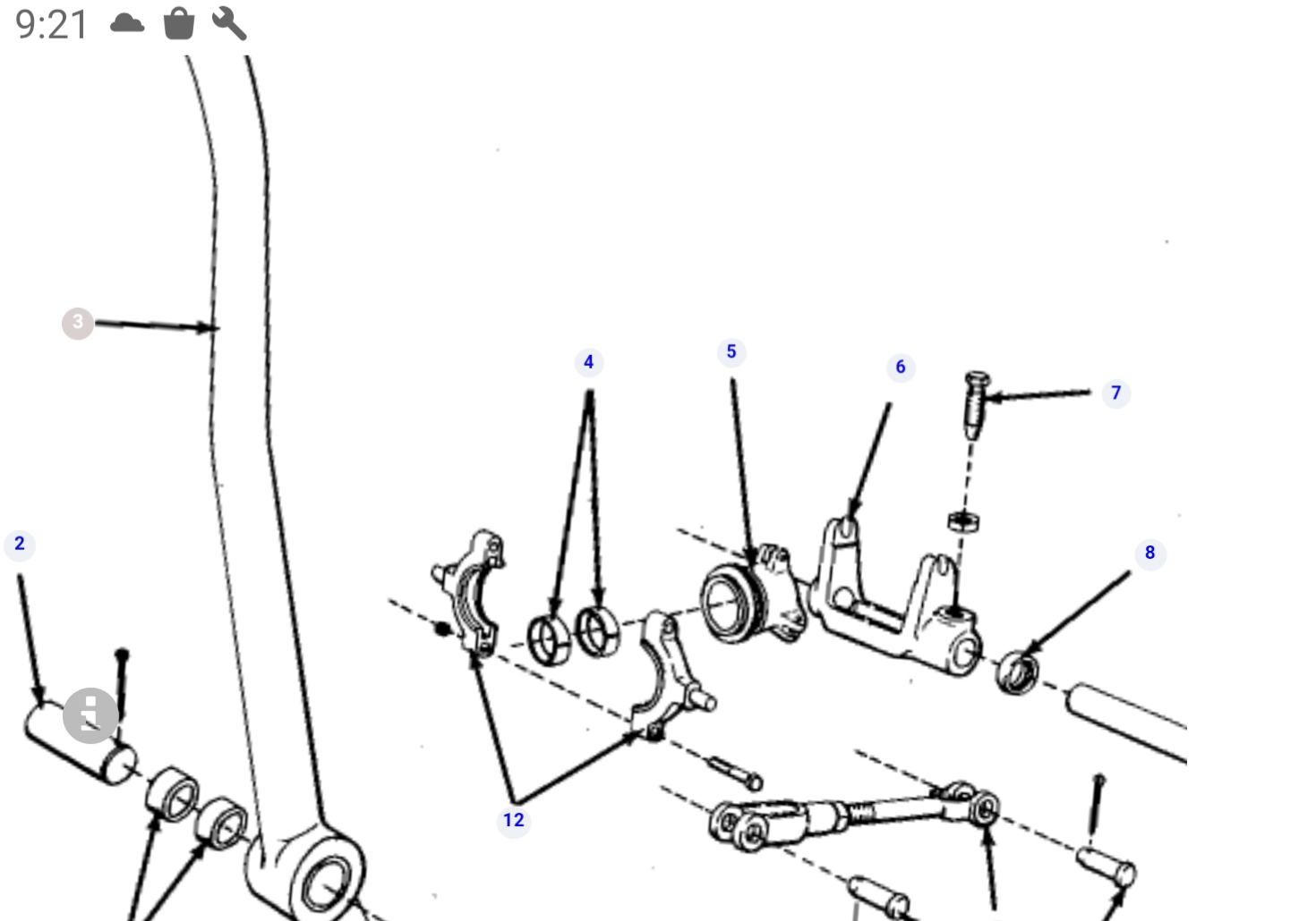

Item #4 in the parts diagram I posted
Points: 8626
Post Options Post Options   Thanks (0) Thanks(0)   Quote Sugarmaker Quote  Post ReplyReply Direct Link To This Post Posted: 09 Sep 2020 at 9:35pm
Ok I see the bushings but for the life of me I do not remember checking mine for wear or replacement?
Call Sandy Lake or one of the other suppliers that sponsors this site.

Post Options Post Options   Thanks (0) Thanks(0)   Quote Gary Quote  Post ReplyReply Direct Link To This Post Posted: 10 Sep 2020 at 4:58am
Now Mack, be careful.
See the posted picture for the 'wanted' bushings.
Bottom left corner, 2 bushings in Hand Lever, P/N 224705.
Item 1 on page 222
G

Post Options Post Options   Thanks (0) Thanks(0)   Quote Lon(MN) Quote  Post ReplyReply Direct Link To This Post Posted: 10 Sep 2020 at 7:47am
I have lots of used hand clutch parts on the shelf if you think that would work for you.

Post Options Post Options   Thanks (0) Thanks(0)   Quote jhendy18 Quote  Post ReplyReply Direct Link To This Post Posted: 10 Sep 2020 at 7:51am
Thanks for leads everyone!
I called sandy lake and the part is no longer made, however according to the parts book if you order the shifter assy these bushings should be included in it.  I ended up buying a used shifter assembly off of ebay for half the price that has at least 1 good bushing which is all I need.
