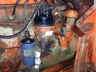

New here and I really need some help. I bought a 1948 WD that's been sitting for a few years. It didn't have spark when I started working on it. It had a 12v conversion already with a 12v generator. I've since replaced cap, rotor, condenser, coil, resistor, and points. I have power through resistor, coil, up to points and out the end of the rotor but no spark or power through cap. I'm stumped. Here is a pic of the set up

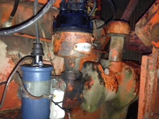

Here is another pic of the set up.. Don't know if it helps y'all when it comes to advice

Do you have 12 volts at the coil input? Even with the points closed? If not, check your ignition switch. If you do, disconnect the wire to your points and ground that coil stud with a short piece of wire. When you remove the wire, a spark should shoot from the high voltage wire. Have that wire within a quarter inch of a ground. If this works, get back to me.

Hello Mkstetkel      Just reading your post and Shooten from the HIP I'd say the carbon was not in the center of the CAP

Well I found I had a bad wire and I didn't have points gapped correctly. Got it fired up this morning for the first time in around 5 years.
