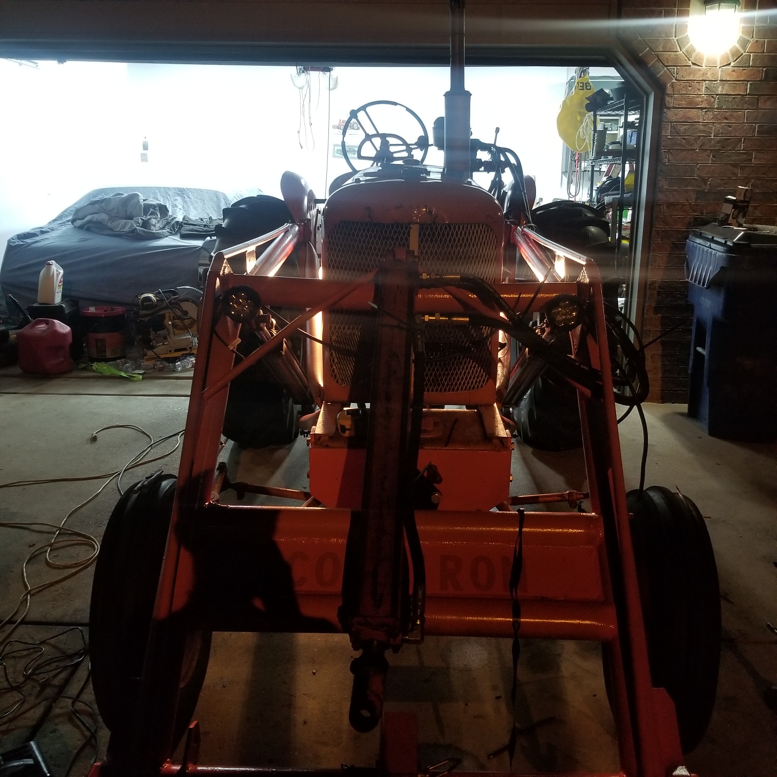

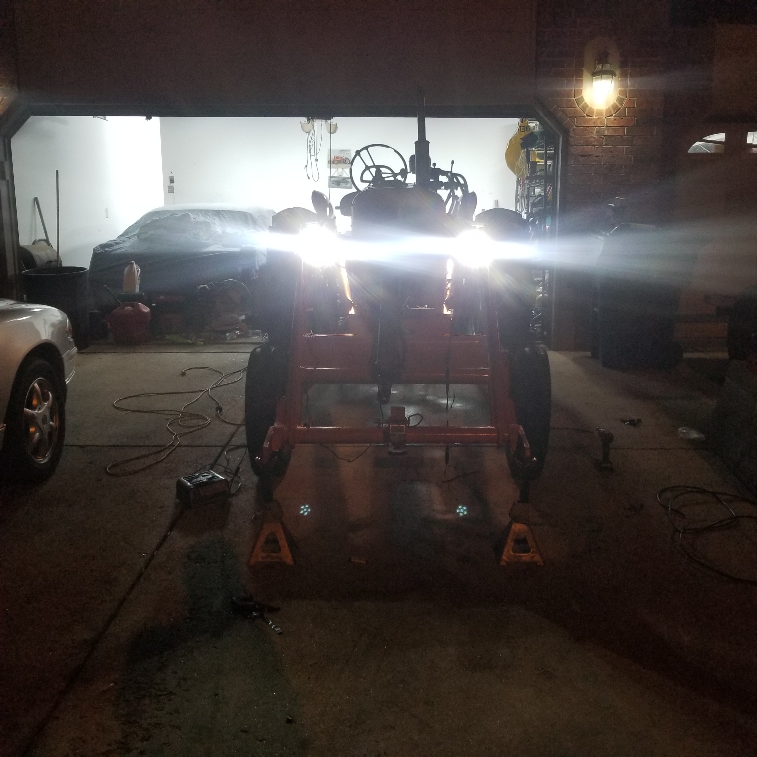

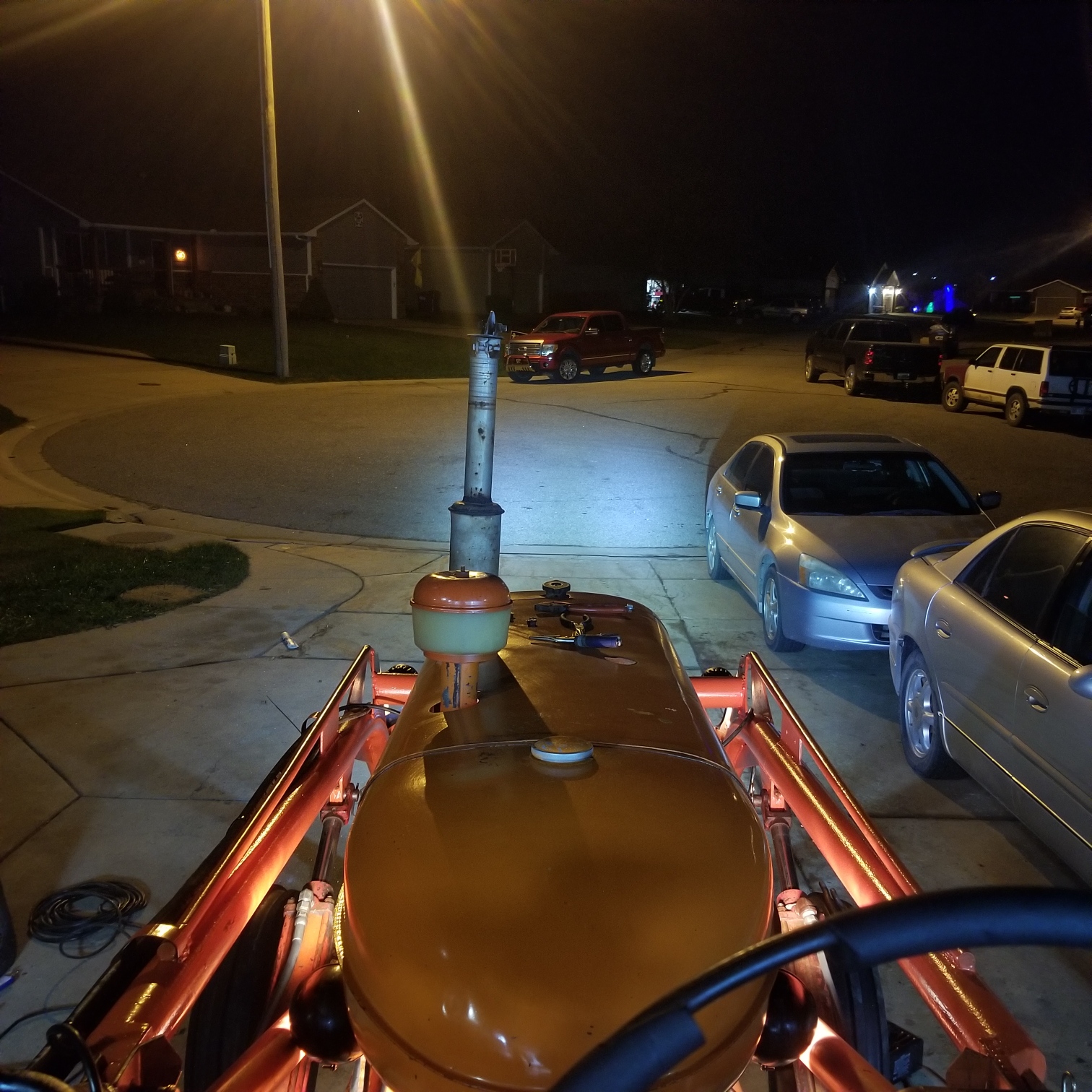

About to finally put this thing to use, but the lighting concerns me as far as getting it on the road, I fee lkj pretty confident with the headlights I added tonight, the stock headlights pretty much just light up the side of the tractor, so at least I'm pretty visable on the sides and front, I have the stock taillight on the left fender, I have another stock taillight on a parts tractor to mount on the right fender, and a smv sign, but I think the rear needs to be a LOT more visable, any ideas? Or pictures of what you guys have come up with? This is honestly a huge thing for me, my gma was killed 3 years ago because the vehicle she was in hit a poorly lit tractor, so for my safety and everyone else on the road, I want this thing to be impossible to not see

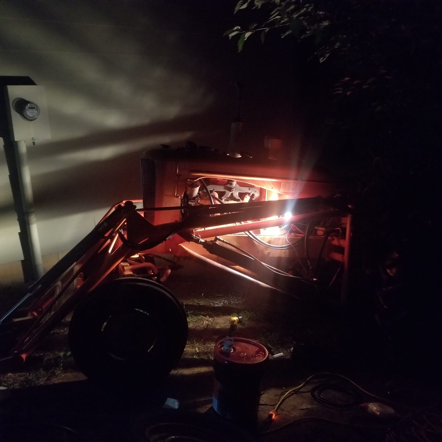

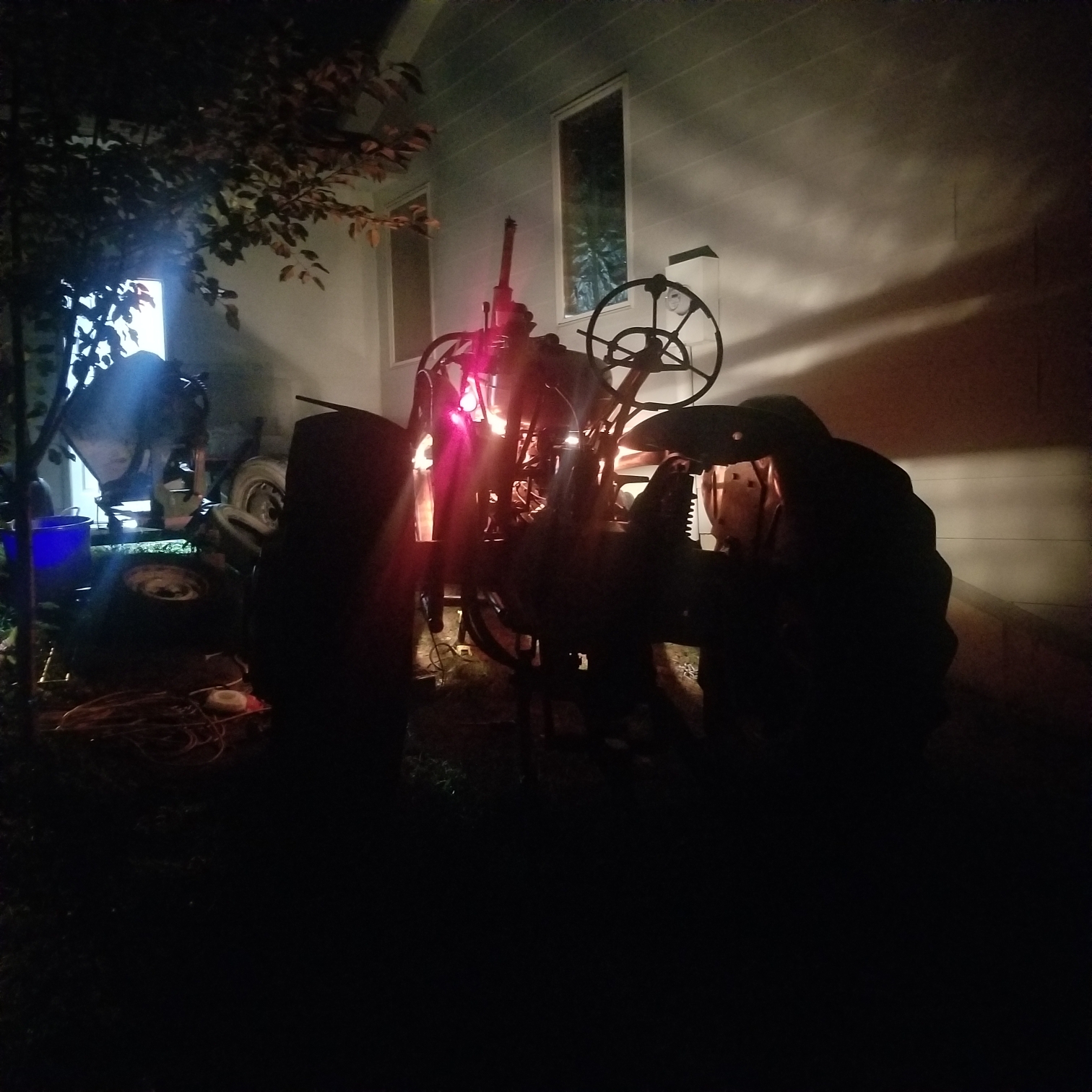

Thought about adding rock lights, would light the road underneath me and make my profile stick out, and make it easier to see underneath while in the field to avoid obstacles, look cool as hell too
