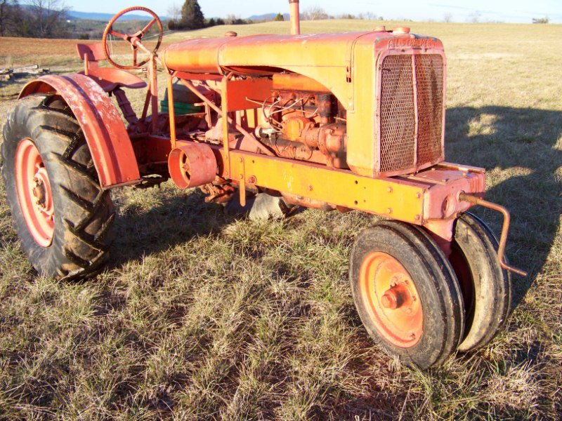

Could these tires on my '37WC  be ORIGINAL?
Someone told me they were old and called "turkey-tread", and looks like the tire tread in WC photo Brochure above?

Post Options Post Options   Thanks (0) Thanks(0)   Quote Ted in NE-OH Quote  Post ReplyReply Direct Link To This Post Posted: 20 Aug 2012 at 10:40pm
Yes , Could be original.
