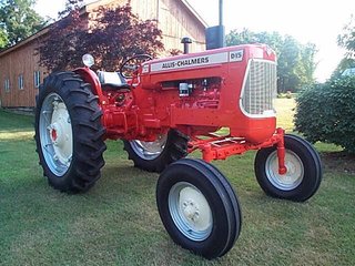

My D15 II High Clearence with 13.6-38 rears and 6.50-16 fronts. Eric NY

Nice to see that photo again! I actually have that photo saved on my computer from years and years ago from the previous AC forum at this site. My tractor is absolutely no match for yours and looks quite beat up and silly with the 26" wheels on her now. But I often check out that photo and dream about what mine can look like some day! Beautiful!
