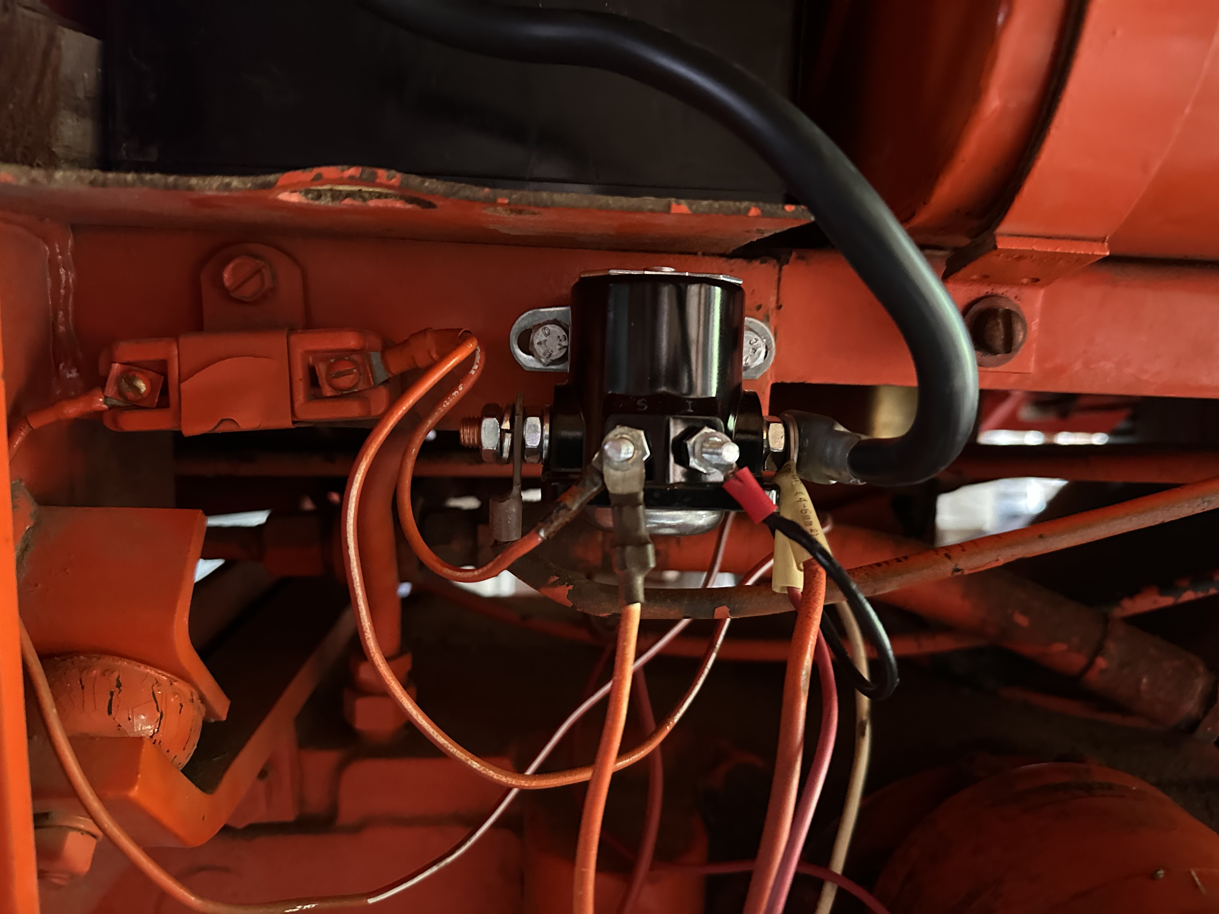

Post Options Post Options   Thanks (0) Thanks(0)   Quote Bds86 Quote  Post ReplyReply Direct Link To This Post Posted: 02 Jul 2025 at 6:08pm
Ancient thread but hoping for assistance with a similar issue. Thanks to the advice from previous replies I've got the right part in but the wiring isn't quite right.
AC 170 starter solenoid wiring
I am far from a mechanic and trying to figure out what's wrong. I took over repairs from my uncle who has fallen ill. Right now the tractor starts but the starter motor continues to run after ignition. I've tried different combinations but nothing is resolving the issue.
Total hail Mary but hoping someone can lend an eye. Unfortunately, I do not have a picture of the original wiring.
Black in picture was added to ground to frame.

Post Options Post Options   Thanks (0) Thanks(0)   Quote Alex09(WI) Quote  Post ReplyReply Direct Link To This Post Posted: 02 Jul 2025 at 11:24pm
We sell and use the OEM Allis-Chalmers brand solenoid. We have used several in our service dept and never had an issue.

Your picture is so large, it's hard to tell if the problem is in the wiring.
When you turn the key to the "ON" position, does the starter immediately start turning or do you have to push the start button (or turn the key) to activate the starter? I think the 170 has a start button, but it could have a start position on the key switch. Regardless, if you have to push the start button (or go to the start position on the key) to activate the starter, it is most likely wired correctly.
If the engine starts and the starter motor continues to turn, I will suspect that either the starter drive is binding and not allowing the spring to retract the gear from the ring gear, or the solenoid is defective and keeping the starter energized after the start button is released.

Post Options Post Options   Thanks (0) Thanks(0)   Quote Les Kerf Quote  Post ReplyReply Direct Link To This Post Posted: 03 Jul 2025 at 8:13am
Originally posted by Bds86 Bds86 wrote:
Black in picture was added to ground to frame...
That doesn't look right to me Confused
Edit: Is this an OEM part or some random solenoid from an auto parts store?

Post Options Post Options   Thanks (0) Thanks(0)   Quote Bds86 Quote  Post ReplyReply Direct Link To This Post Posted: 03 Jul 2025 at 9:04am
Thank you for the feedback! It's definitely push button start and starter stays engaged.
Sorry about the large picture. Not sure why it didn't crop. I've tried 2 NAPA solenoids as others discussed here. ST80 had the same issue so I've tried ST67(in picture) which has the I and S labeled posts. Both small wires are on one post and the other needs a ground wire back to the tab mount screw or frame. I was also under the impression it grounds through the tabs.Without that wire theres power to the key but the ignition button does nothing.
I was just told this morning that the solenoid issue happened shortly after replacing the battery but I'm not sure how a battery could've caused an issue? Might have shorted something.
If I bypass the wire spliced to the small post to the other side of the large solenoid, it fires and starter disengages but I have to disconnect that bypass to kill the engine.
All very confusing to me and either the part is totally wrong and I'll order off Agco, or it's going to take some wire tracing.

Post Options Post Options   Thanks (0) Thanks(0)   Quote Les Kerf Quote  Post ReplyReply Direct Link To This Post Posted: 03 Jul 2025 at 11:19am
... It's definitely push button start and starter stays engaged...
The solenoid is getting feedback from the ignition (resistor/coil) side
... ST67(in picture) which has the I and S labeled posts. Both small wires are on one post and the other needs a ground wire back to the tab mount screw or frame.
The small wire running from the resistor to the "S" terminal needs to be moved to the "I" terminal; this is causing the feedback which is keeping the solenoid energized.
The small black wire that is on the "I" terminal needs to be removed and may need to be connected to the mounting tab to provide a good ground.
Edited by Les Kerf - 03 Jul 2025 at 11:20am

Post Options Post Options   Thanks (0) Thanks(0)   Quote DrAllis Quote  Post ReplyReply Direct Link To This Post Posted: 03 Jul 2025 at 12:33pm
Wired incorrectly. Push button starter wire to "S" on the relay.  Double wire connection on the resister goes to the "I" terminal on the relay and also goes to the coil on the engine. Whatever that black wire is get rid of it.

Post Options Post Options   Thanks (0) Thanks(0)   Quote Glenn (NJ) Quote  Post ReplyReply Direct Link To This Post Posted: 03 Jul 2025 at 4:10pm
I had a similar experience replacing the relay on my Series IV.   That relay is an overseas copy that the guy making them didn't get it quite right.  The "I" and "S" on that case do not mean anything - they just happened to be on the case that was copied.  If you disconnect the wires from both small terminals and then meter across them you will find that  you have the two ends of the coil  That is why you needed the black wire to the tab to make it work.  Les has it right that the ignition circuit is back feeding keeping the relay closed.
Toss it out and get the correct relay from one of the vendors on this site.

Post Options Post Options   Thanks (0) Thanks(0)   Quote DrAllis Quote  Post ReplyReply Direct Link To This Post Posted: 03 Jul 2025 at 8:04pm
IT IS WIRED WRONG !! Let's get the wires where they actually belong before condemning the second starter relay. The BLACK wire has to go away if it is a ground wire. It appears to be homemade.  The thick single vertical wire (white in color if you remove the orange over spray) on the rear post gets moved to the front post. The double wire that goes to the resistor stays where it is. Once it is wired correctly, always be suspect of a starter push button switch if the rubber is worn away where your thumb pushes it. It could be sticking and keeping the starter spinning when it shouldn't be. But, get the wiring corrected first.
