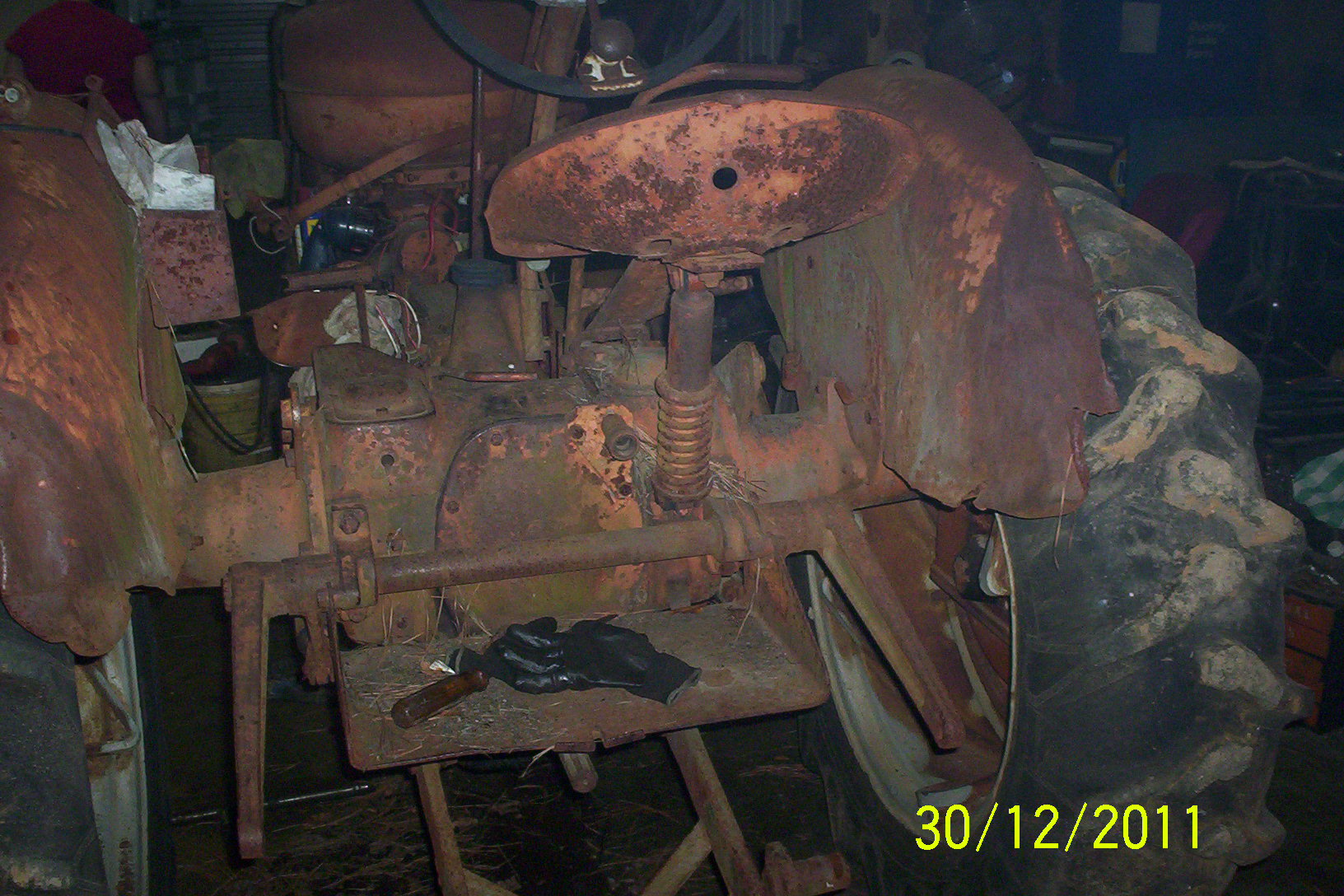

front viewback viewI know this is not a new subject but here goes.... Obviously I'm new here. I have what I believe to be a WD. I have the engine S/N WD332600PA. I have searched the real axle and have found nothing but casting marks. It does have the straight shifter and the number in front of it is 200931. The number is cast into it though and not stamped; however there is a plate above the number that appears to read R-K-KL (it could be an A at the beginning), and there appears to be a 6 stamped in below the cast number. Can anyone help?trans number

Looks like a WD to me, the serial number is stamped on the real axle housing below the left brake access cover.

Number should be stamped in the vertical surface right above your screwdriver handle.

Welcome to the Allis group.  You have a WD.  The serial number is on the flat area above the adjusting screw for the left brake.  The screw is about three inches below the brake cover.  It will start with WD______.

I have searched that area and see no numbers

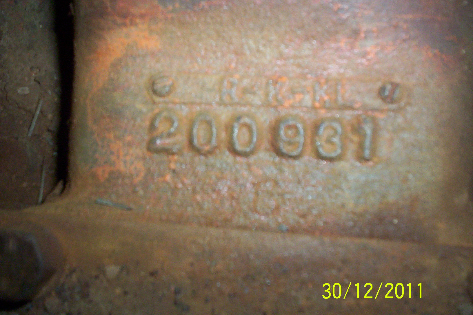

Early WD's had the serial number stamped in the top surface of the differential housing on the right side of the left brake cover. You may want to look there if there is no number stamped on the aforementioned place.
Follow the link to see exactly where the serial number is stamped.
http://people.clemson.edu/~wsmth/SNLocat/ACSN4.htm
332600 is a 1952 engine block but that doesn't necessarily mean the tractor is from that year. A lot of these old things have had transplants. Another possibility is something happened to the rear end and a new housing was used to correct the problem. Replacement housings would not have had a number stamped in at the factory.
 So if there isn't a number where the pictures show after scraping off old paint, you may have a 1952 with a replacement diff housing.

I had to use a wire brush on a grinder to find the numbers on my wd45. They aren't stamped very deep on mine. By the way welcome to the forum. You'll fine any info you need right here.

Thank you everyone for your help on this. After some wire brushing I did find the S/N WD122436, so I guess it is a 1952.

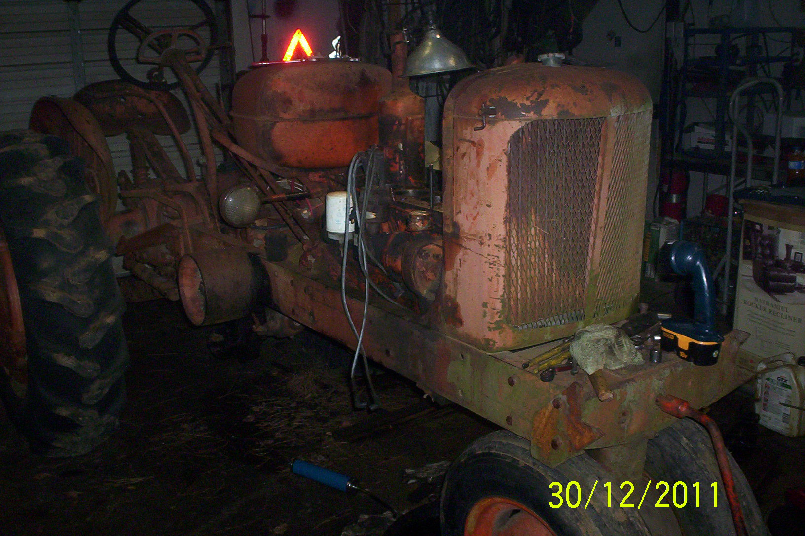

I was wondering what the brackets were for, and yes it does still have the shudders. As far as getting it unlocked, I let it set the first night with all the cylinders full of oil, since I have just been keeping in soaked with a rust inhibitor.
Also, if I jacked up the back wheels and put it in gear, shouldn't it engage the engine?
Can anyone tell me the proper way to get the starter off this thing?

First disconnect the starter cable and starter rod.
There is a large set screw with a lock nut  on the left side in the bellhousing just ahead of the starter. It may be a hex head or a slot. Loosen the locknut, and remove the set screw. It has a taper on the inner end that engages a tapered hole in the nose of the starter. Once this is out, a large screwdriver or prybar can be used to start it loose, then pull it back out of the bellhousing.

Once you get the starter out, try and turn it again... it might just be a jammed starter gear... happens sometimes.  Speaking of which... I got a WD sitting in the driveway that I need to move in and unstick... it was free about 5 months ago... hope it's not bad...

It looks to me like someone welded the lift arm shaft to the right side support.  Am I seeing that right?

The cultivator mounting brackets look like they have been modified. Do you have a drawbar for the tractor? Looks like it has a mounting bracket for a John Deere #5 sickle bar mower.
