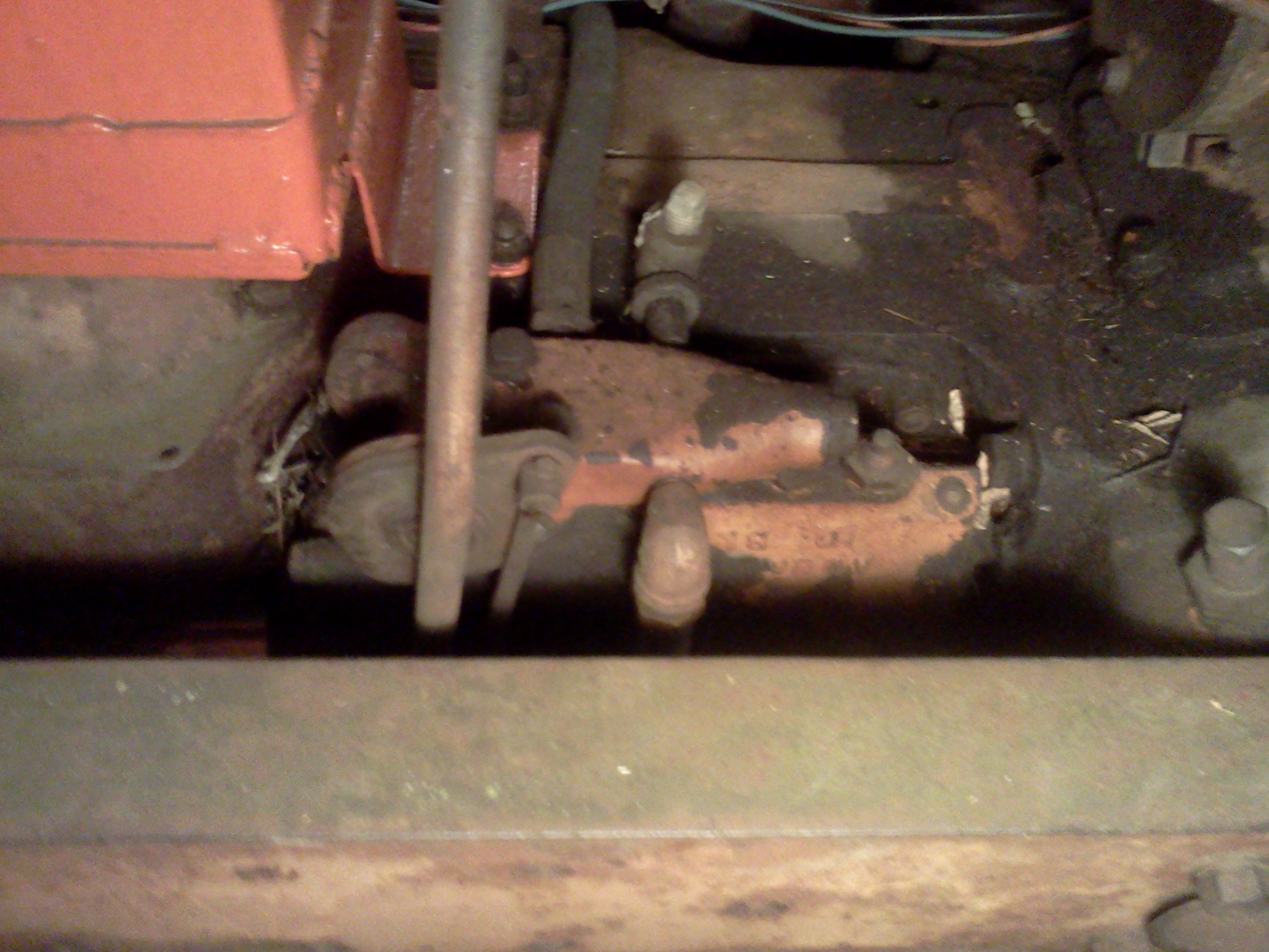

Here's a picture of the top of the unit . Is that elbow with the plug in it the remote outlet?
Gary in Texas View Drop Down
Location: Burkburnett, TX
Points: 630
Post Options Post Options   Thanks (0) Thanks(0)   Quote Gary in Texas Quote  Post ReplyReply Direct Link To This Post Posted: 09 Nov 2011 at 3:22pm
The remote is the elbow with the plug.
You don't have the rear outlet.  The lines on you system to to the 2 point lift, works with snapcoupler or pint hitch.
The remote operated after the main lift is up, kind of a delay.
Edited by Gary in Texas - 09 Nov 2011 at 3:24pm
Points: 8636
Post Options Post Options   Thanks (0) Thanks(0)   Quote SteveM C/IL Quote  Post ReplyReply Direct Link To This Post Posted: 09 Nov 2011 at 3:34pm
Well if remote is connected at lift cly,you'll end with the same result-sorta. Normally that supply line is the front left port on hold valve (where that galvanized elbow is).It's a steel line that runs accross the torque tube,around the battery then back underneath it right behind the hand clutch cover then bends around the sterring column post and back to a triangle plate(mounted off differential cover bolts)which has nipple welded in it to which with the proper fittings connect the line.
