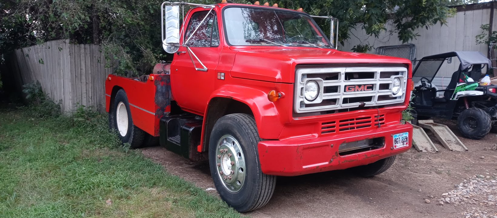

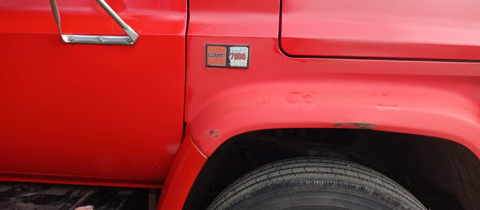

Did the old used car salesman trick to my '86 GMC last summer. Rubbed it down with tranny fluid. Used about 2 cups to do the whole truck. You can see the before and after in the close up picture. I washed it with some Zep citrus degreaser first to get the oxidation off.
Neighbor did his '64 Ford pickup with a product called Flood Penatrol. Watched some videos online of guys doing it. They say it lasts about one year. Works kind of like a clear coat.
Edited by truckerfarmer - 19 May 2025 at 6:42am

Isn't that going to make it a dust collector ?

It did catch a little for the first week. Wipe it on with one rag, buff it with a clean rag. "Wax on, wax off".
