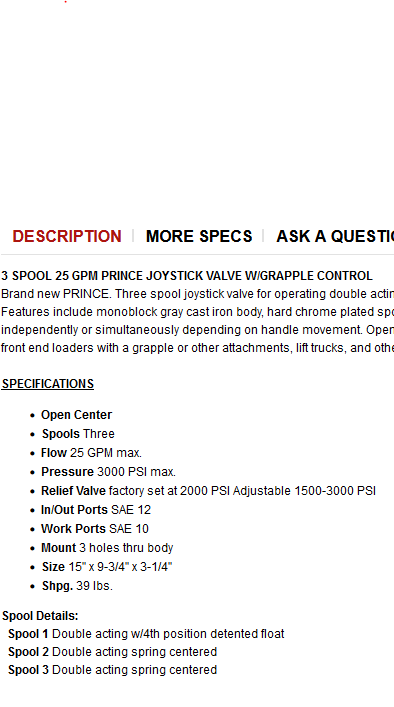

Assuming my plumbing route is correct above, I want to try this 3 spool system if it will work.  It comes with a PowerBeyond adapter plug.  The 190XT is only 12GPM but this valve is 25GPM.  I think it is a maximum rating but is this valve too large?  190xt is supposed to be 2000psi so I don't need to change the factory setting.  They don't seem to have a combo unit like this in smaller sizes so I would have to move away from the joystick w/grapple entirely which isn't the end of the world.  I think on a 12 GPM I should have a minimum 17GPM rated 3 spool valve.

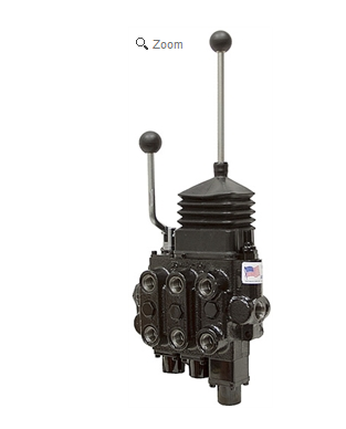

Here is the pic from surplus center and is Prince HC-V-BP22 model at $427 (out of stock until March, of course) :
Here are the specs

The valve is fine. Being larger in GPM capacity hurts nothing. Get the valve located where it is easy for you to operate and make hoses to connect things up. My location of choice is the area above the right brake pedal over to the front of the console control. You'll never get on/off that side of the tractor. The return line is easier to plumb into the bottom of the hydraulic return sump. Use a 1/2" pipe tee installed sideways and return oil into one side and opposite side use as a drain.

Yep mount the joystick where comfortable/possible, then worry about hoses.  I generally take some big rope, and route it the way you want the hoses to go, then mark each rope with some tape to dee where it goes.  Take the ropes off, measure, and either have them made or buy the closest(a little long) pre-cut length, with the right fittings already on. Surpluscenter.com has pretty good prices on the pre-cut hoses, compared to our local hose shop...Wink
