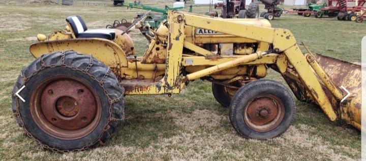

I climbed on a D10 today. Talk about uncomfortable to use. That steering wheel is huge, low, and near parallel to the ground. It forced me to be bowlegged to drive it as the fenders squeezed me into the seat area. And yes, the seat was bolted to the rear most position.
This is a p/s industrial D10, in case that changes the steering wheel specs.
Unless there is a way to raise the steering wheel height, drop the seat height, and/or reduce steering wheel diameter, the CA is better for us taller guys.

The Industrial D10 is so rare, it seems wrong to modify it to make it useable.
Imho: Extending the steering column would be the best fix.
Side view:
Edited by KMAG - 27 Mar 2021 at 11:02pm

The Ind D10 seems to have a shorter steering column than the ag D10.
Notice how the steering wheel rim is lower than the seat.

Andy, is it really shorter, or just a big thich padded seat on the Industrial ?  Lower the seat 3-4 inches and it might look the same... but leg room might be a problem with lower seat ? ............... i like raising the steering wheel / shaft 6 inches ??

I have a lot of old advertising literature. Every picture I have of a series 3  D-10 or D-12 has the deluxe seat cushion 4 inches below the tops of the fenders. Also, the OEM deluxe cushion isn't as thick as that yellow tractor in the picture.

In the above picture the seat appears to be in the standing position (up and back) that raises you up under the steering wheel.  Those Deluxe seats have a driving position and a standing position. They can be a very nice tractor and I'd suggest getting the deep dish steering wheel like shown on the I-400 which is also the same as a 190 uses.
