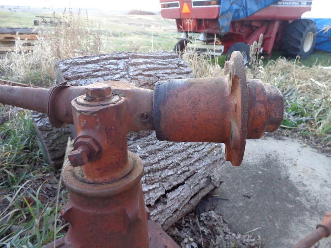

The reason I want to remove this is I want to use the spindle and hub to build a gauge wheel for my 73 plow. Have a perfect piece of steel and a wheel and tire is no big thing.
Here is a picture of the patient, or victim. Pin already out.

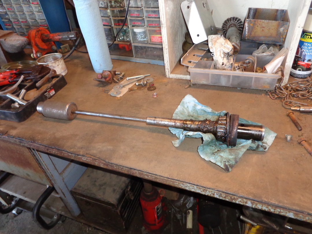

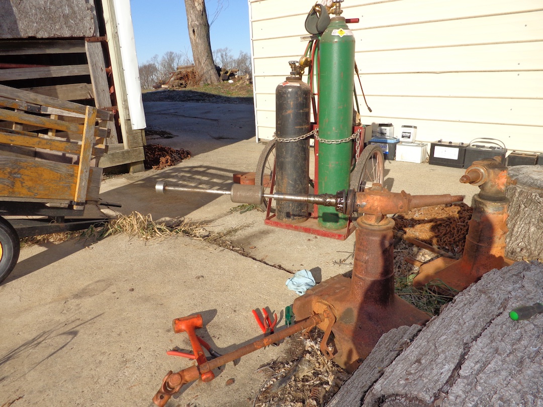

Post Options Post Options   Thanks (0) Thanks(0)   Quote IBWD MIke Quote  Post ReplyReply Direct Link To This Post Posted: 01 Dec 2020 at 2:05pm
Finished the adapter today. Got the torch out, was going to 'heat-cycle' it one time. Decided what the hay, screwed the slide-hammer on it, gave at a few good raps, it moved! You can see the torch in the background. Pulled right out.
I do some of these kind of things just to see how hard or easy they might be.
One pic getting ready and one on the bench ready for the next step.
