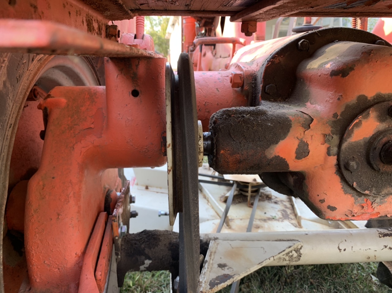

That drive pulley is on backwards like >< instead of <<. If the drive pulley was half and inch closer to the right it would work. I did speed the deck up to 1/2 speed and it stayed on like in the pic but I did not want to damage the $80 belt so I stopped.
Nathan (SD) View Drop Down
Location: Day County SD
Points: 1304
Post Options Post Options   Thanks (0) Thanks(0)   Quote Nathan (SD) Quote  Post ReplyReply Direct Link To This Post Posted: 18 Oct 2020 at 8:30am
Your pulley hits the PTO housing before the nut is tight ? Is that the problem ?
KungFooMASTA View Drop Down
Joined: 25 Apr 2020
Location: Kingman KS
Points: 35
Post Options Post Options   Thanks (0) Thanks(0)   Quote KungFooMASTA Quote  Post ReplyReply Direct Link To This Post Posted: 18 Oct 2020 at 8:49am
Yes sir.

I dont know how "loose" the pulley is on the shaft.. If it is just a small amount, maybe you can grind the face of the pulley hub so the pulley will slide on a little further ?
The side that would need to be ground is already flush with the spokes.

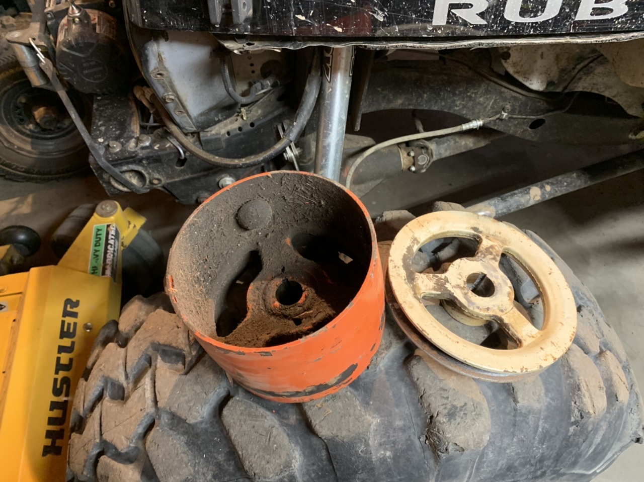

The factory pulley is 1.165” on big side. The Woods part 7450 is 1.3”. The shaft is 1.175” at the housing.

Grinding will not work because of shaft SIZE !!!!!    Had a customer put a woods mower on his early B and  I got the correct pulley from woods dealer .He later sold the mower and the guy that bought used the later pulley .
 If u have another B sitting around for parts swap out PTO UNITS .

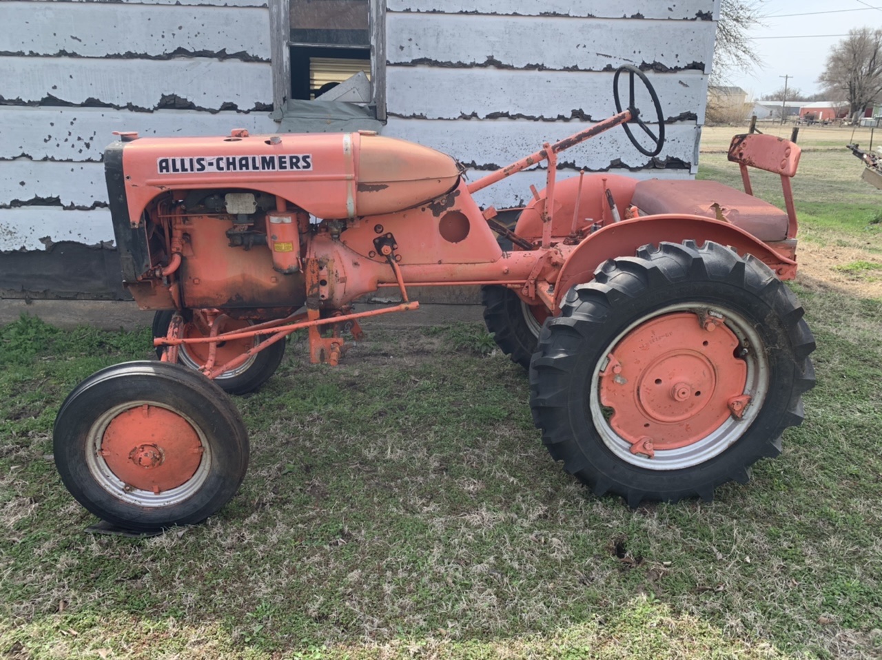

Here it is where I found it. Behind a neighbors garage. He does not know how long he has had it. He claims it ran when he parked it but i dont know how. None of the spark plug wires were in the right spot even.

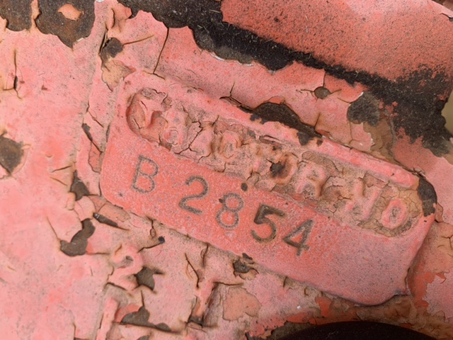

Thanks for showing pictures.  Really looks good for an older unit.  Check the serial number to determine the age.  It is by the gear shift lever to the rear.  At this age has probably been well painted over.  May have to clear for reading.  I understand there is a serial number list on this page.  If not let me know I have a list.  The 30's B serial numbers go from 1 - 33983.

For its age, that is one great looking B.  The tires are worth a lot, they look new!  You got a great deal there.  I hope you get it all figured out, they are a great 'lawnmower'.

I cant remember the exact number but its #28XX. It is not the super early ones with a Wisconsin engine it has the Small Allis engine.
Gary View Drop Down
Location: Peterborough,On
Points: 5911
Post Options Post Options   Thanks (0) Thanks(0)   Quote Gary Quote  Post ReplyReply Direct Link To This Post Posted: 20 Oct 2020 at 6:16pm
FYI Ser. 2802 is in the Owner Registry.
Joined: 25 Apr 2020
Points: 35
Post Options Post Options   Thanks (0) Thanks(0)   Quote KungFooMASTA Quote  Post ReplyReply Direct Link To This Post Posted: 20 Oct 2020 at 6:45pm
2854

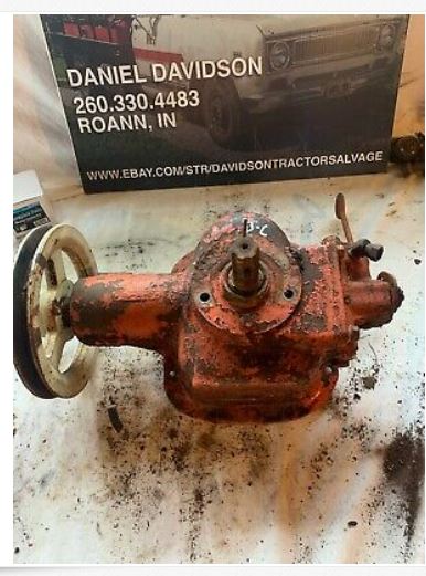

https://www.ebay.com/itm/Allis-Chalmers-C-B-Belt-Pulley-PTO-Assembly-With-Hydraulic-Pump/293425707166?hash=item445188f89e:g:hI0AAOSwLfxeH0mp
If I got this one would I be able to have hydraulics on it. Where would the tank mount? I dont think Bs came with hydraulics. Did IBs come with hydraulics?
Points: 90808
Post Options Post Options   Thanks (0) Thanks(0)   Quote steve(ill) Quote  Post ReplyReply Direct Link To This Post Posted: 20 Oct 2020 at 7:22pm
that housing should fit a B or a C tractor.. The SUMP is the oil cavity. Holds a couple extra quarts of oil in the transmission / bevel gear box.. The HYD valve is the thing on the right side of the case.. The PUMP is part of the valve and is inside the case... all held on by 4 bolts.  Since this is a very LOW VOLUMN pump you can run ONE cylinder of 1-2 inch diameter to lift a plow / blade / ect... It is not for a front end loader with cylinders 3 ft long.  When you slide the housing onto your bevel gear case, the internals drive off the top shaft of the transmission.. You have to have the motor running and clutch engaged ( foot off pedal) for the unit to run.. Push in the clutch and it STOPS.

Post Options Post Options   Thanks (0) Thanks(0)   Quote steve(ill) Quote  Post ReplyReply Direct Link To This Post Posted: 20 Oct 2020 at 7:24pm
it says NON RUNNING, so i would assume you will have to pull the pump / valve and disassemble / clean / reset......... it may not work properly in present condition.
Oh ok thank you good to know. My dads ca has that I always wondered where the hyd tank was. It would be nice to have some hydraulics. I want to build a small pull behind box blade.
Joined: 25 Apr 2020
Points: 35
Post Options Post Options   Thanks (0) Thanks(0)   Quote KungFooMASTA Quote  Post ReplyReply Direct Link To This Post Posted: 21 Oct 2020 at 12:33pm
That might be more than I want to do.
