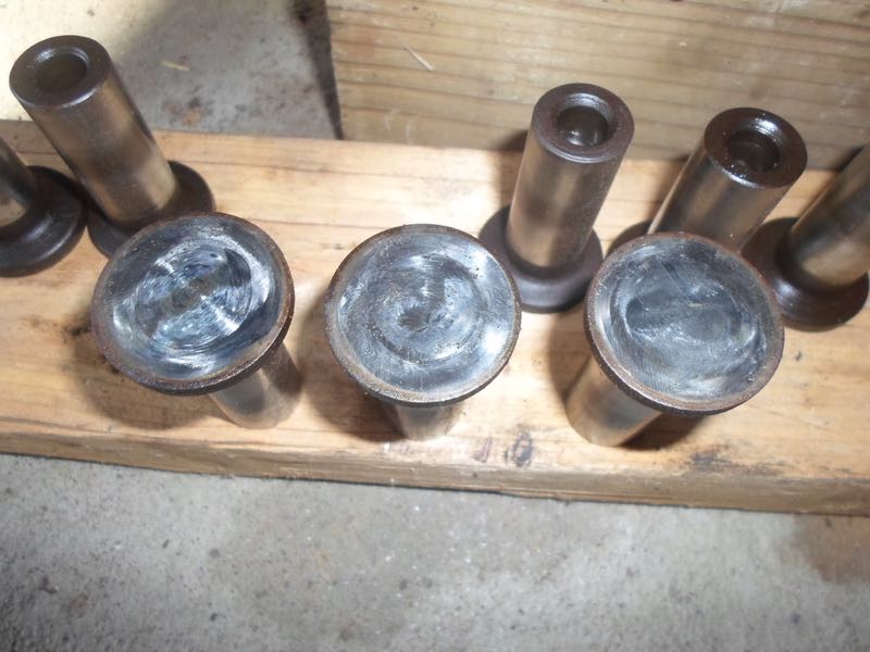

There's plenty of discussion about this on automotive forums, but I'm curious what the guys who deal with low-speed low spring pressure Allis-Chalmers engines think. The lobes on the camshaft out of my WD look decent, but the middle journal is worn way out of spec, so I'm looking for a replacement camshaft. Do the original lifters from whatever camshaft I buy need to go with it, on their original matched lobes? The concern is that mismatched lobes and lifters would start wearing rapidly and wipe out the lobes.
All of my lifters are worn slightly concave, and a couple of them have more serious wear patterns on them that concern me. I haven't priced new lifters at AGCO but I doubt they're cheap.

Awesome. I guess that makes sense... They start out convex, eventually get worn flat, and then wear in to concave. By at least making them flat they're probably at least half as good as new, and way better than what they look like now.
These are samples of the ones I'm working with out of my WD. They're concave by 0.002-0.003 in the centers. Some have some pretty ugly wear patterns from the lobes at 90 degree angles which tells me they weren't or haven't been rotating at some point in their lives. Those spots are worn in a little deeper. I'll play around with grinding them flat on the valve end grinding attachment on my Sioux. No Bridgeport unfortunately but I can try hand finishing them.

WJohn, yours are way worse than mine was. It had to be a noisy motor. I wouldn't attempt to do those by hand. But mine turned out good and still in there after several years of lite work.
