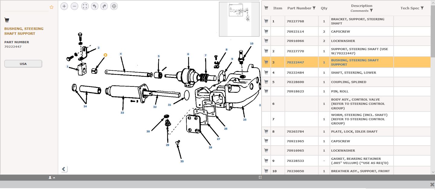

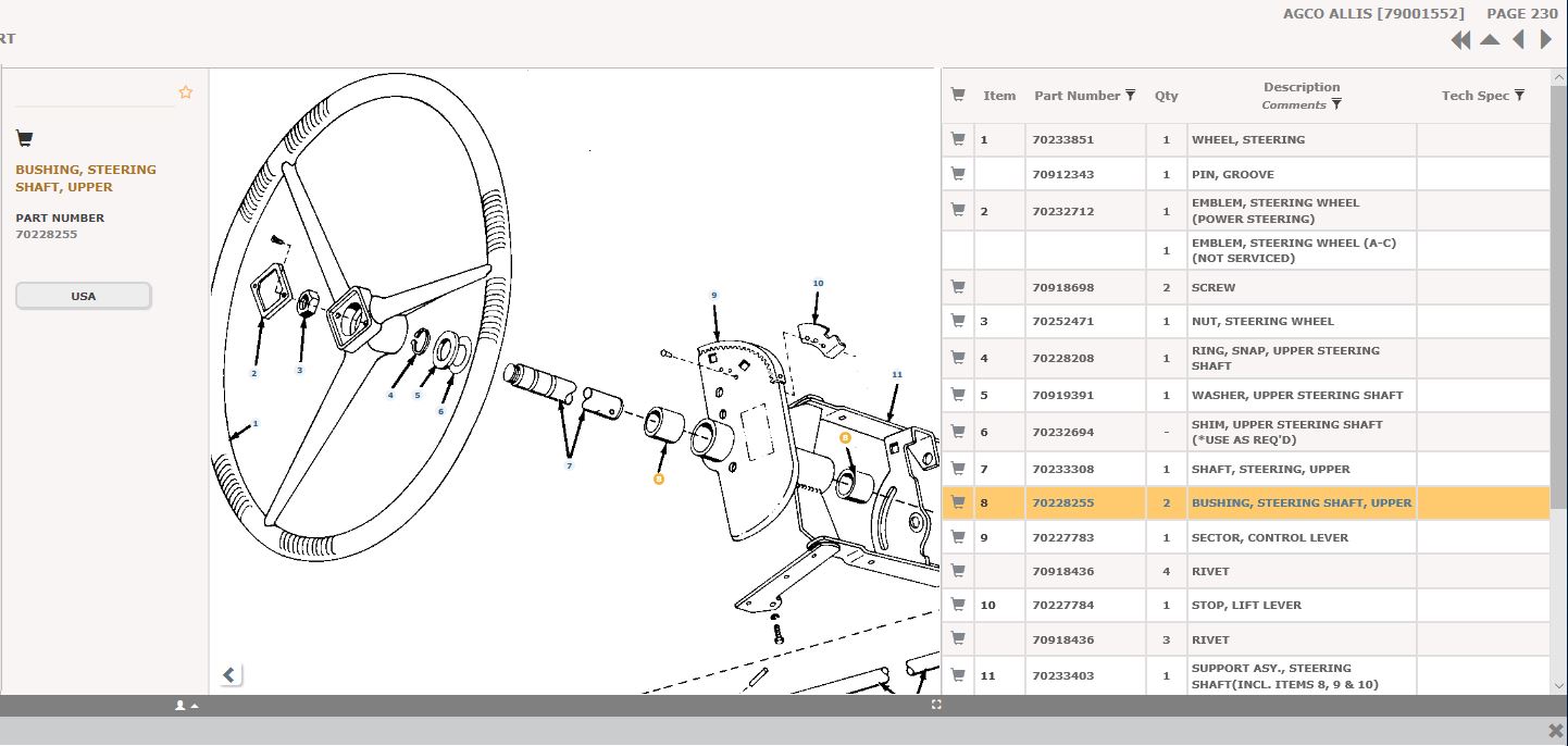

Trying to replace the one on the frame rail close to the carb . Have it off and what's left of the old bushing out . New bushing is maybe 1/8" too big . Anyone know if this sounds right ? Its #70228255 Thanks

Using the D15 parts catalog the 70228255 bushing appears to be for the upper shaft (steering wheel area). The bushing for the lower shaft (frame rail) is 70222447 for both manual and power steering, if this is the one you are looking for. HTH

Well , no wonder it won't fit . Didn't realize there were 2 up at the steering wheel . Thanks Jim !!

Heck I just learned there's supposed to be a bushing in the frame rail ( #3, 2nd dwg) !!!!
All this time I though thought it  was just a nice 'clearance hole'.....
It looks like 1/2 the tractor has to come apart to install a new bushing so maybe next ,next Summer's project ????
Guess I'll check #2 and #3 to see if THEY have that bushing...tomorrow..THAT I can do..

Plan to pull this #70228690 coupling today and see if it's worn out and causing all the play in my steering . Thanks again Jim for the diagram .

Anyone know how this #70227783 control assembly comes off ? Have the dash panel loose and the snap ring off on the top of the lift/lower lever . Trying to access the steering shaft bushing . Any help is much appreciated . Thanks
