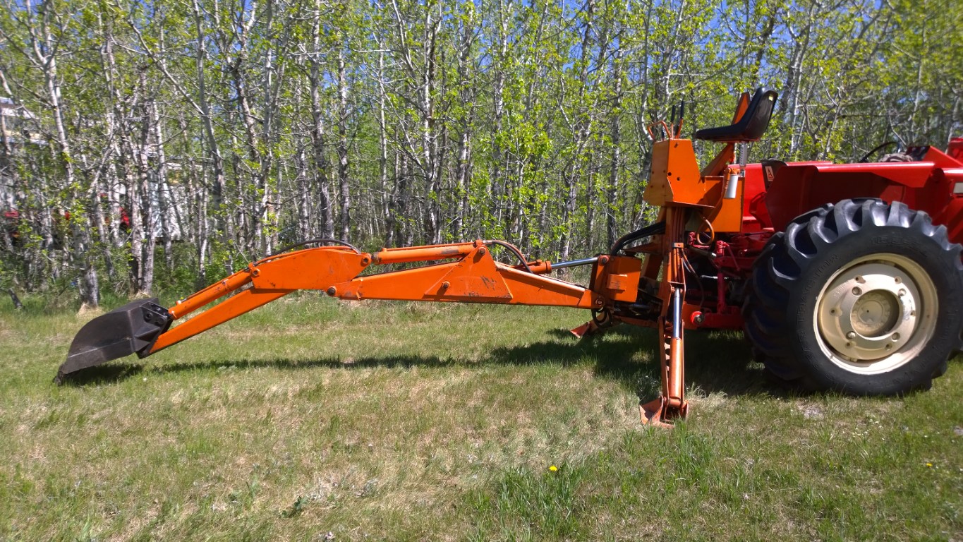

Had a Woods backhoe on a 170.  3 point model.  Worked OK.  In addition to the linkage, it needed to be chained down to the hitch so you had down pressure, otherwise it lifted up the 3 pt linkage and your stabilizers were floating in the air.  This unit used a PTO pump and the tank for the oil was just below the seat.
Edited by Reindeer - 16 Mar 2019 at 10:28am

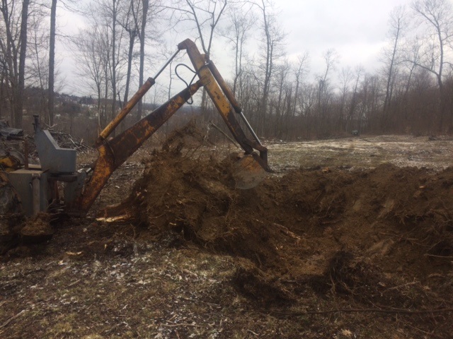

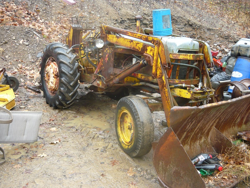

got a d17 with henry loader and hoe, works great. but the pto is blocked by the hoe and ya can't use the 3pt hitch. old and well worked, but still does the job
