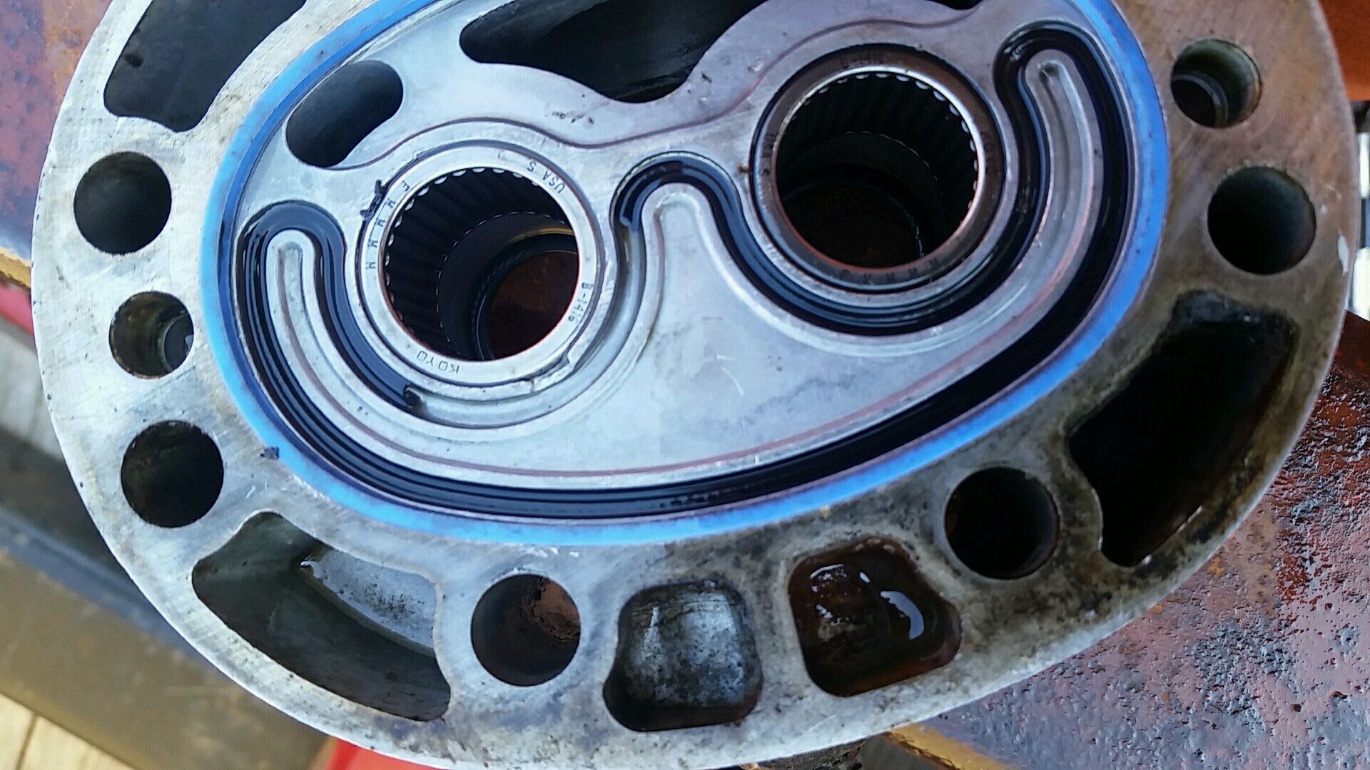

I'm no hydraulic pump expert but behind one of the main wear plates the aluminum housing next to the bearing is cracked out and the seal is blown out. Could this be part of the problem? Lol

That's not going to work that way...
Points: 22827
Post Options Post Options   Thanks (0) Thanks(0)   Quote DrAllis Quote  Post ReplyReply Direct Link To This Post Posted: 30 Aug 2018 at 7:09am
That is your problem.
Points: 8984
Post Options Post Options   Thanks (0) Thanks(0)   Quote SteveM C/IL Quote  Post ReplyReply Direct Link To This Post Posted: 30 Aug 2018 at 8:14am
and with that chunk missing you wont hold a backup seal if replaced. JB might fix that with a little effort. Do you feel lucky?

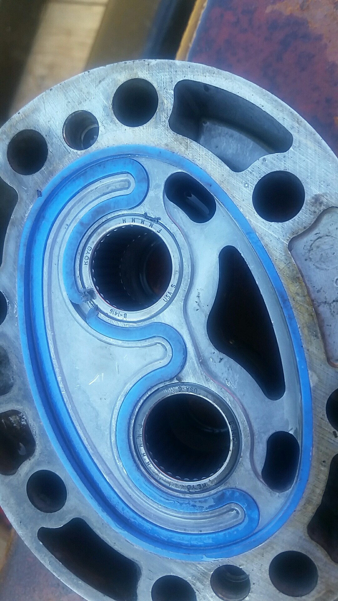

It appears to be cast aluminum, trying to find somebody who could TIG weld it up, then I'll massage it back to shape with a die grinder.
Called my agco dealer and he tells me the seal and the backer are only available as a kit and run 113 bucks... yikes

is there a chunk missing where the blue oring blew or is it just a mark where someone peened the housing to hold the bearing?

There is a piece of the housing missing right where the blue seal blew out.

Unfortunately I think I caused this problem. I put all new bearings, seals, and wear plates in the pump a few years back. I`m assuming I chipped the aluminum when removing or installing the new bearing.

Had a local guy tig weld up the pump section. Then I dressed it up with a die grinder and pressed in a new bearing. New preload and load seal and it's back in business. Lifts the baler and discbine without trouble. Adjusted the relief back to factory spec so all should be good.
