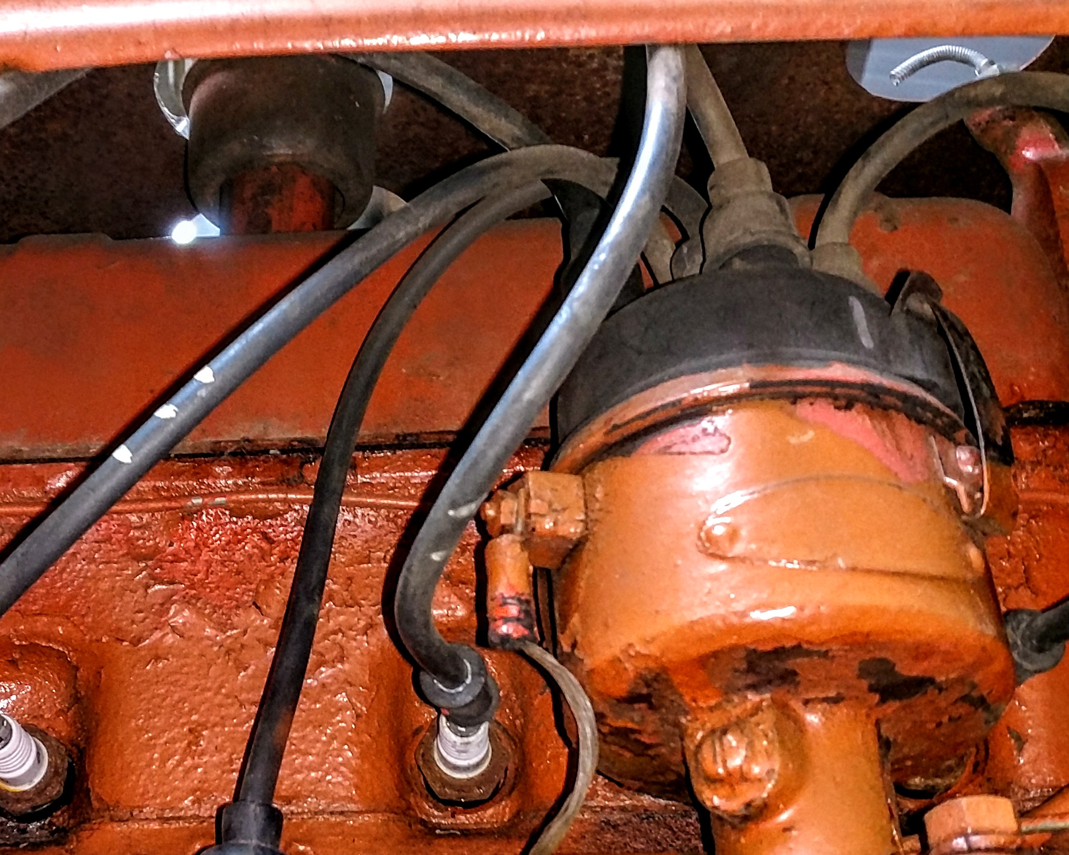

Here's my plug wire order picture

Points: 8543
Post Options Post Options   Thanks (0) Thanks(0)   Quote Sugarmaker Quote  Post ReplyReply Direct Link To This Post Posted: 29 Mar 2018 at 7:56am
Sorry I just tuned in but in that picture it looks like the wire going to the distributor is bare? That could be a issue if it is touching anything metal.

Post Options Post Options   Thanks (0) Thanks(0)   Quote Hunt4Allis Quote  Post ReplyReply Direct Link To This Post Posted: 29 Mar 2018 at 8:21am
It is barely, but not touching anything
