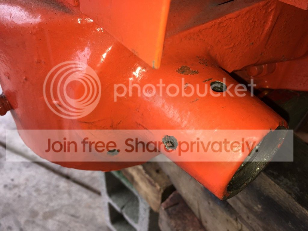

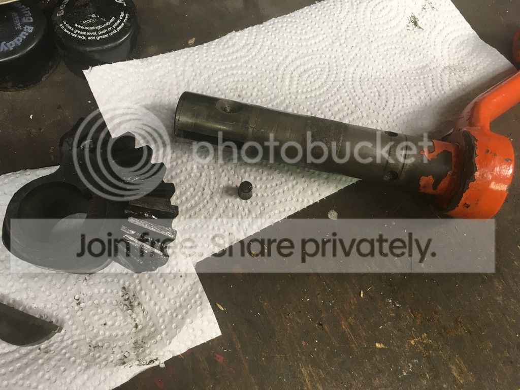

Finally got gear off by drilling a 3/4" hole in casing opposite the shaft and pounding out shaft.
Question- what are the 3 holes in the casing that appear to be threaded and the 3 dimples in the shaft for.  It is not indicated on any parts diagram.  Almost like it should have a ball and spring to fall in detent to hold shaft steady- but for steering?
Anyone seen this..
Thanks
