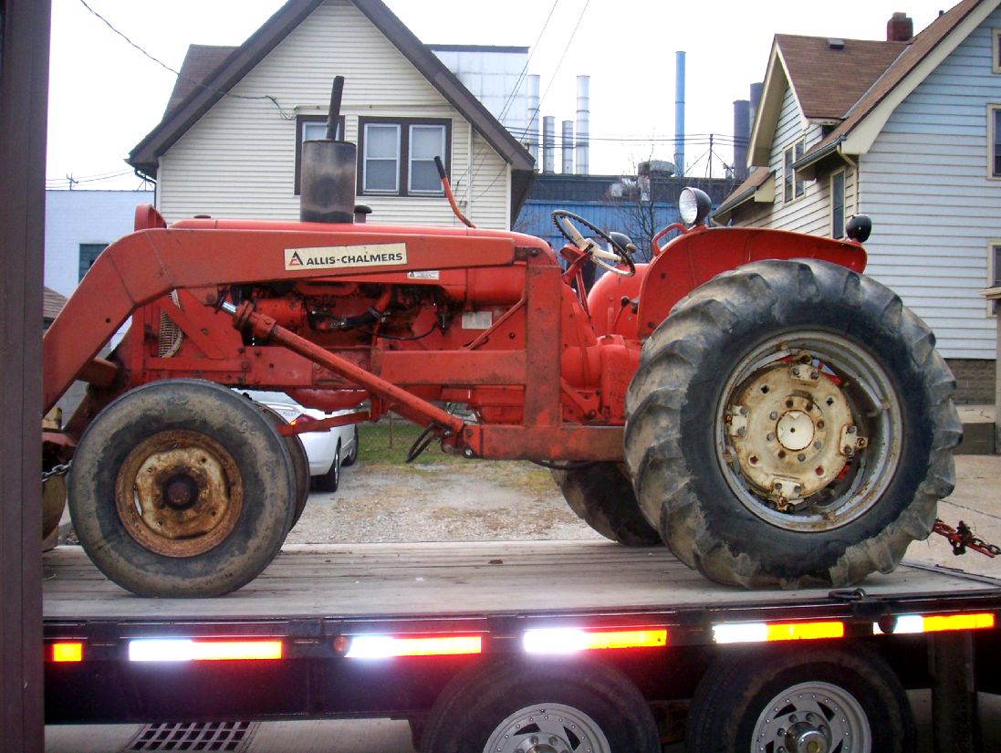

Anyway here are a couple pictures. First one is probably 10 years ago when we hauled it up. Picture is in the alley behind my house in West Allis. In the background is Motor casting Co. and directly behind that is the old Allis Chalmers tractor plant which you can't see in picture.
Second picture was last week when I pulled tractor out and pulled in garage.

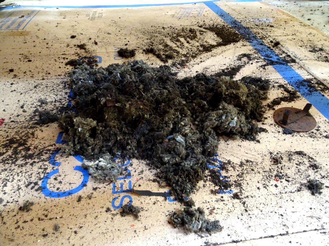

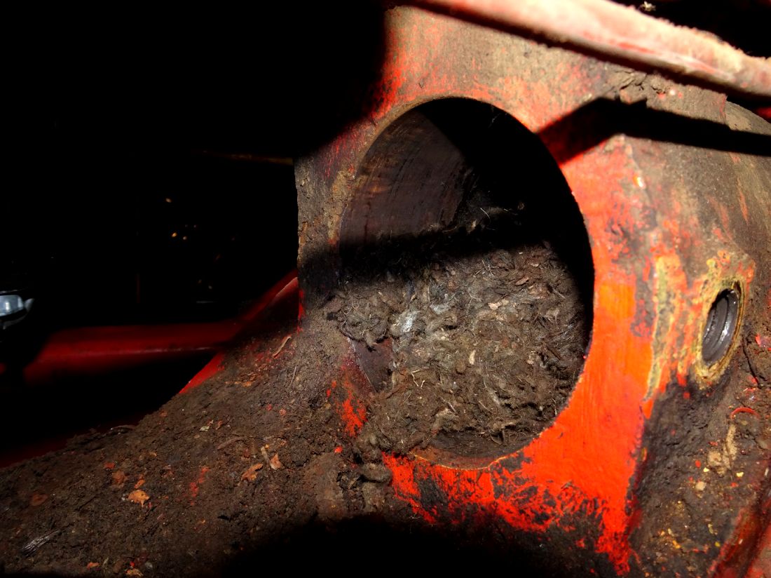

Most likely sweat stuck, IMHO, but mice love to nest in these bell housings, for some unknown reason. you might wanna check for foreign objects, in the bottom of the bh, as well as the stuff other posters have said.  Usually, a big wrench on the pto, or rocking the rear wheels in 4th gear will unstick stuck rings. I have seen the best wrench to use, its a piece of female drive shaft, welded to a 4'long winch bar, even has the knurling, on the bar, to keep yer hands from slidin off...Wink
DiyDave was correct!  Clap   Pulled starter out and it was packed in there with mouse nest so I went underneath and pulled round access cover off bottom of bellhousing and it was packed SOLID with mouse nest. I had to jam a screwdriver in just to start breaking nest loose. After a couple hours of pulling stuff out, blowing through top and from underneath with air nozzle seemed to get most of it out. It did take a big pipe wrench on PTO to break it loose. After just pulling out what I could at first and putting wrench on it I could start to turn it a little and then it would lock but after a lot of back and forth with wrench and cleaning got it to turn pretty easy. Looks very clean now.
Still couldn't get it running though. ran out of time to work on it. Got it to pop a few times anyway so just took carb off to bring home and rebuild for next time. should hopefully be good to go then.

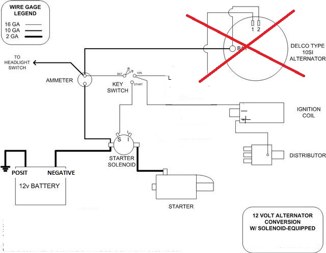

Leave the plugs out. You turned the FAN, did the motor pulleys turn ? .... 90% of the time a NO CRANK is due to bad battery cables, or bad starter solenoid... Take the cables off and clean the ends with wire brush to CLEAN METAL.. Where the cables connect, make sure the terminals are all bright and shinny also..
Im not sure i understand you cable description 100%.... If you have a POSITIVE GROUND then the POSITIVE terminal on the battery is ground to the frame ( clean and install new ground bolt).... The NEGATIVE terminal of the battery goes to the starter solenoid, and the other side of the solenoid goes to the starter terminal.... The small wire on the SOLENOID  comes from the key and energizes the solenoid so that internal the TWO BIG lugs are connected.
Points: 87925
Post Options Post Options   Thanks (0) Thanks(0)   Quote steve(ill) Quote  Post ReplyReply Direct Link To This Post Posted: 17 Mar 2022 at 7:44pm
Your battery / starter / solenoid wires should look something like this... I assume you have a generator and not an alternator... that is not important right now..
( "the negative battery wire goes to the starter " )  .. do you actually have a SOLENOID that is turned on by the KEY. or do you turn the key to ON, and then push a starter rod >
Edited by steve(ill) - 17 Mar 2022 at 7:48pm

Post Options Post Options   Thanks (0) Thanks(0)   Quote Bweston Quote  Post ReplyReply Direct Link To This Post Posted: 17 Mar 2022 at 8:38pm
To turn the tractor on it’s actually on a toggle switch for power then you have to press a push button
Edited by Bweston - 17 Mar 2022 at 8:42pm
Points: 87925
Post Options Post Options   Thanks (0) Thanks(0)   Quote steve(ill) Quote  Post ReplyReply Direct Link To This Post Posted: 17 Mar 2022 at 10:28pm
OK... the push button takes the place of the ignition switch "start" position... But you still need a solenoid, maybe mounted to the starter, that has the BIG BATTERY wire connected to it ?
Again... ALL of the battery cables need to be clean, shinny, and good bolts on the ground cables...... The starter also is GROUNDED to the bell housing/ motor block.. The mounting face of the starter and the bell housing it bolts to need to be CLEAN
