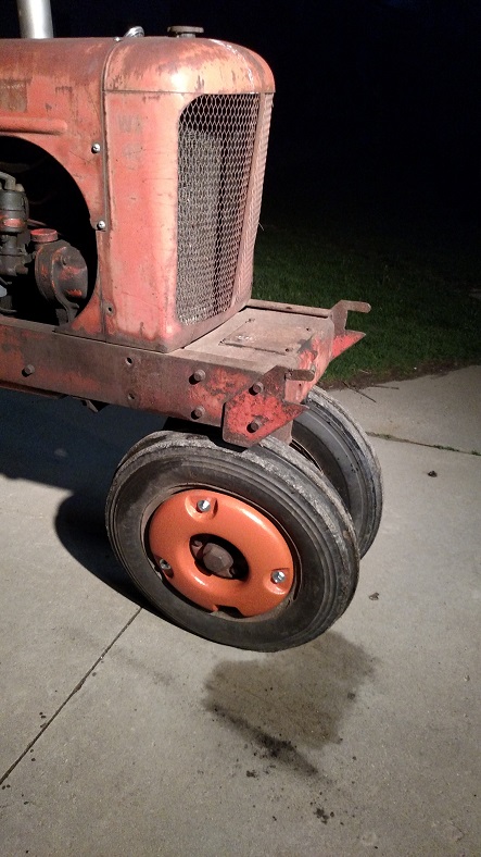

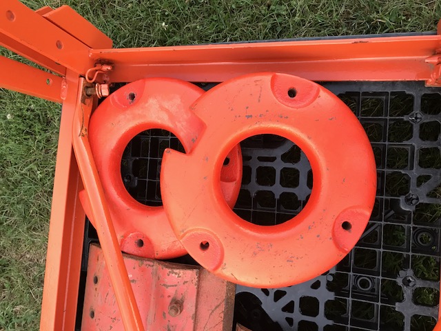

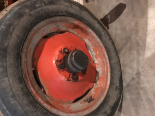

I had a chance to pick up some weights thinking I'd put them on my WD45. That's when I noticed there are no mounting holes on my rims. Is a different rim needed or are these not meant for a WD45? I already have two of the front stack weights on it. There is a very steep hill on my road which is a county minimal maintenance road and I can never keep the front end down when grading it. Thanks.

The bolt goes thru the slots. Takes a special bolt. HTH Tracy

Yup, just like Tracy says.  I was pretty young and dumb when I bought mine.  $10 bucks each and all 6 holes had the "special" bolt nut and washer.  Didn't know how fortunate I was they were sold that way. So, I didn't have to find out how they worked.  When you got the special bolts they really work cool!  Sometimes I think the bolts are more rare than the weights!

I didn't have the special bolts so I modified some carriage bolts to go in the slots.

I used regular bolts on mine. Grind the head down flush with the bolt on one side. You will have to use a big flat washer on the weight. A bolt small enough to go thru the slot is smaller than the hole in the weight. It ain't a perfect fit but it will work.

I used some 1/2" bolts from the hardware store. I ground down the bolt head on one side and it worked perfect. I cannot remember how long the bolts are.

use a Carriage Bolt 1/2" X 3 3/4" , grind one side

A carriage bolt might hold them. The real bolt head is offset , longer on one side to catch the rim correctly. the head size pushes bolt to true center of hole. A carrige bolt won't do that, without building up the head and machining it. HTH Tracy
