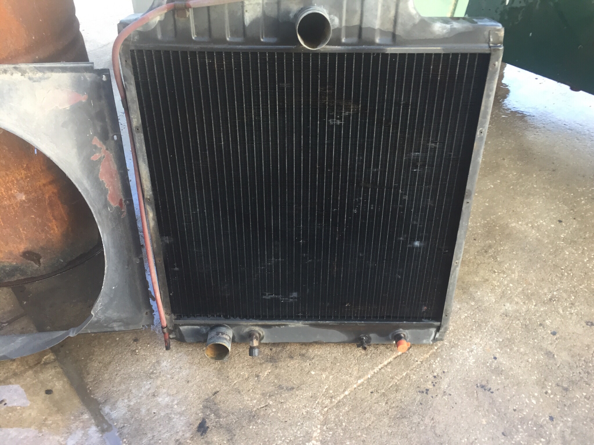

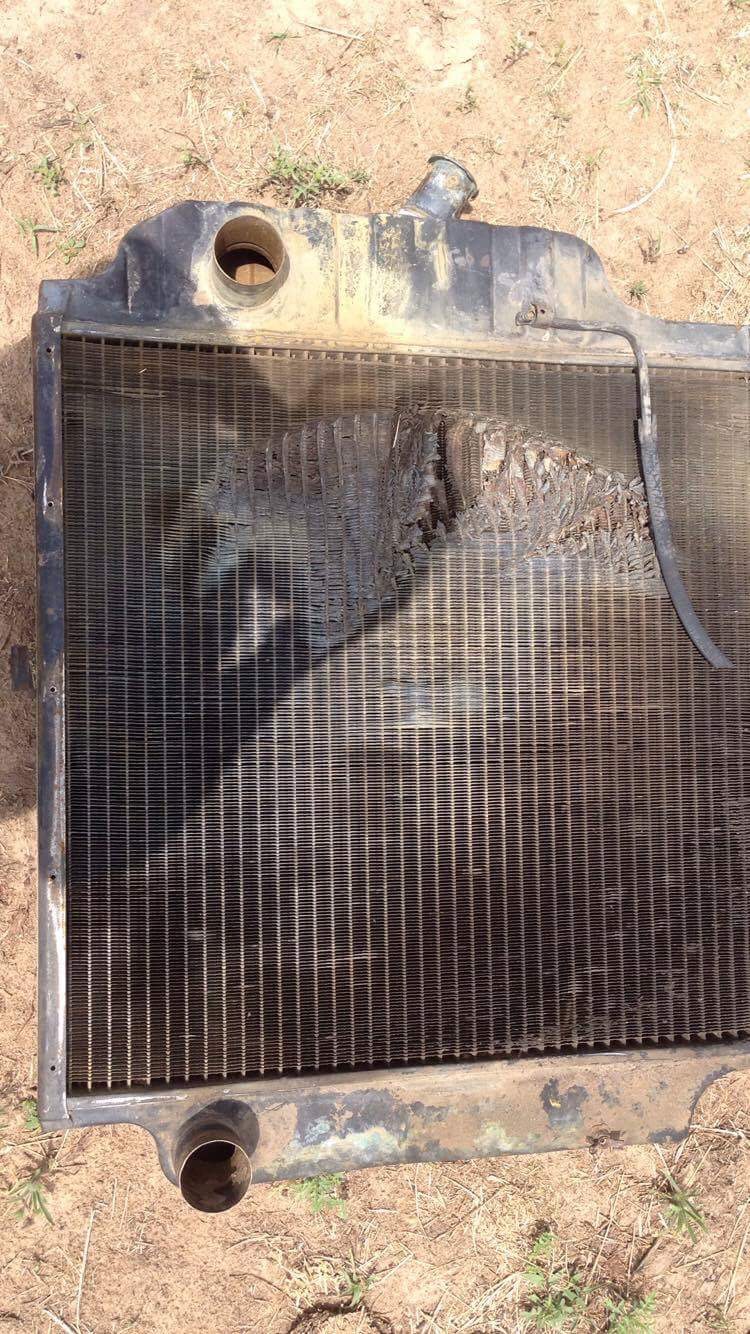

301 engines had ac compressor up top where 426 had them on oh side of engine. 426 radiators have top tank spout in middle where 301 spout is to the outside more. And when I say spout I mean where top radiator hose hooks on.

pictures for example one that had fan damage is from a 7020 where other one is from a 7040
