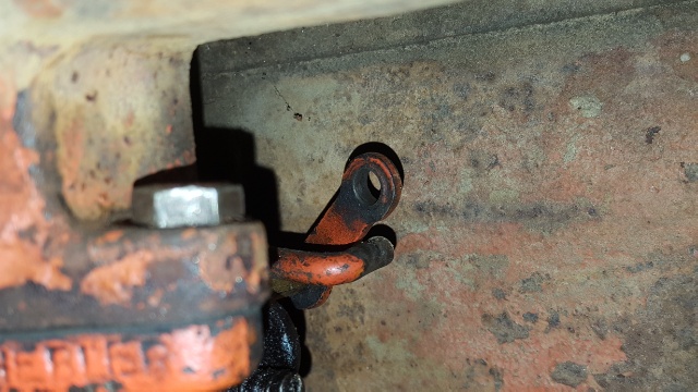

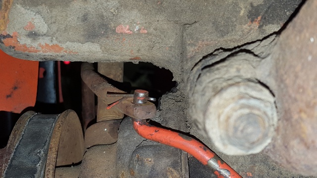

Throttle wide open...
Can't fix stupid

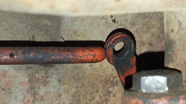

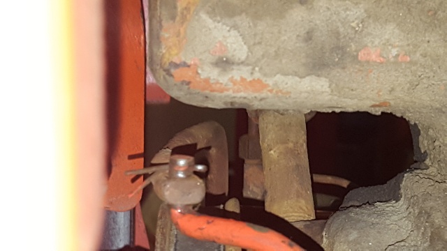

Post Options Post Options   Thanks (0) Thanks(0)   Quote AJ Quote  Post ReplyReply Direct Link To This Post Posted: 14 Jun 2017 at 3:14pm
Throttle all the way down..

Post Options Post Options   Thanks (0) Thanks(0)   Quote AJ Quote  Post ReplyReply Direct Link To This Post Posted: 14 Jun 2017 at 5:17pm
Is there something wrong with these positions?

Post Options Post Options   Thanks (0) Thanks(0)   Quote David Maddux Quote  Post ReplyReply Direct Link To This Post Posted: 14 Jun 2017 at 7:01pm
From rhe way I see the photos, the rod may be a little short. Can you take some of the bend out of the rod to get it within an 1/8" from fitting in the hole?

Post Options Post Options   Thanks (0) Thanks(0)   Quote AJ Quote  Post ReplyReply Direct Link To This Post Posted: 14 Jun 2017 at 11:21pm
Bend the governor rod toward the carb more? I can but then that rod will hit the front of the block/head I'm pretty sure because when the throttle is at idle it's almost touching as is. (See first picture of throttle all the way down)

Post Options Post Options   Thanks (0) Thanks(0)   Quote DrAllis Quote  Post ReplyReply Direct Link To This Post Posted: 15 Jun 2017 at 9:15am
Don't try and bend the governor arm that crosses in the front of the block UNLESS you absolutely have to. Too much of a chance of damaging something else if you aren't an expert on this.  Your link rod (governor arm to carb rod) is too short. Remove it and straighten out some of the bends and see if you can't get it to proper length to just slide back into the holes. VERIFY THE LINK ROD DOESN'T RUB AGAINST ANYTHING WHEN DONE. If it doesn't idle down fully after this adjustment, correct that by changing the throttle rod length under the gas tank.
