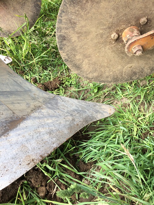

Back in mid-April I was posting about adjusting my 2-bottom plow to fit the WD45. Finally got a chance to put the plow in the ground today. I worked the plow in a section that had already been plowed to polish up the bottoms. Though plowed, the ground is typical New England soil: BONY! So I kept the speed down. Here's a video - in 2nd gear with throttle open not much! I need to adjust the plow to cut deeper, but that will require me to free up the beaming crank! Also cutting deeper on the front bottom than the back, so I need to tweak how I've got the winging screw set. I'll get to these soon - supposed to rain tomorrow and Friday.

I've added photos of both bottoms....front first, then rear.

The plow isn't sucking deep enough. Not sure what the cause is. I've added photos of both bottoms to the original post to see if the plow people out there think the tip shapes are okay.

After freeing up the beaming screw, I raised the back of the plow relative to the front - now sucks deeper. I think the idea is that the plow 'wants' to run level front to back, so raising the rear bottom makes it drop deeper into the soil to get to level. Maybe!
