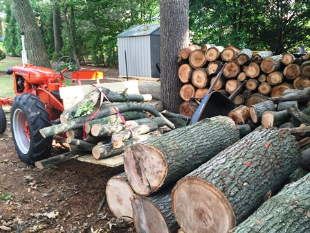

I love the 3-point on my B.  I did put the engine weights on and you have to keep the weight on the back in mind.  I moved the large logs one at a time without an issue.
I had to flip my draw bar over to install the hitch.  And like was mentioned, leave everything loose until it is completely mounted then tighten things up.
Remember that the load is further back than if the tractor was designed with a 3-point so you need to be very situationally aware.  I never strapped the big logs on in case the front lifted, the log would roll off before I got into too much trouble.  You will never get to the clutch fast enough to stop it in time.  On the other hand your implement will act like a wheely bar.
