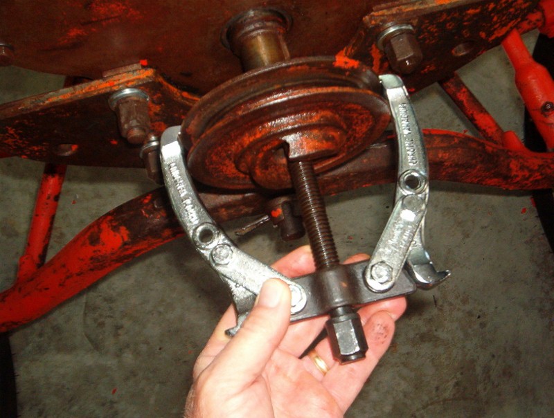

Post Options Post Options   Thanks (0) Thanks(0)   Quote GLHolmes Quote  Post ReplyReply Direct Link To This Post Posted: 24 May 2010 at 4:56pm
All right, been working on getting the old pulley off, without much success.  We've been pouring lubricant to it and heating it up with the blow torch for 5 minutes or so, and it won't budge.  Does anyone have an idea for us?
Post Options Post Options   Thanks (0) Thanks(0)   Quote CTuckerNWIL Quote  Post ReplyReply Direct Link To This Post Posted: 24 May 2010 at 5:07pm
Take the second set screw out. Some had a double set screw, one to jam the other.

Post Options Post Options   Thanks (0) Thanks(0)   Quote Chuck(ONT) Quote  Post ReplyReply Direct Link To This Post Posted: 24 May 2010 at 5:09pm
There is a set screw on there. You will have to use a gear puller. I have used 3 short nuts and bolts behind the pulley in combination with a puller.  Put pressure on it from behind by cranking out the nut. They have been on there for up to 70 years.

Post Options Post Options   Thanks (0) Thanks(0)   Quote GLHolmes Quote  Post ReplyReply Direct Link To This Post Posted: 24 May 2010 at 6:29pm
Still working on it and looking it over; we cannot see a second set screw.  We only found one set screw on the backside of the pulley on a raised portion of the collar.  Also, the pressure of the gear puller is breaking the back side of the old pulley right off.  Please help!

Post Options Post Options   Thanks (0) Thanks(0)   Quote R Aiken Quote  Post ReplyReply Direct Link To This Post Posted: 24 May 2010 at 7:08pm
This is what I use to get those pulleys off. Some of them I had to get red hot but never broke one.  Some of them are tight.

Post Options Post Options   Thanks (0) Thanks(0)   Quote WC7610 Quote  Post ReplyReply Direct Link To This Post Posted: 24 May 2010 at 9:49pm
Ray's right.  Went thru this in March.  Thought for sure it was going to break-but it didn't.  Heat and steady pull from a good gearpuller.

Post Options Post Options   Thanks (0) Thanks(0)   Quote DSeries4 Quote  Post ReplyReply Direct Link To This Post Posted: 24 May 2010 at 9:55pm
Both set screws are in the same location - one behind the other.  I found out the hard way getting the pulley off of my D14.

Post Options Post Options   Thanks (0) Thanks(0)   Quote Wes (VA) Quote  Post ReplyReply Direct Link To This Post Posted: 24 May 2010 at 11:55pm
A bearing separator placed behind the pulley distributes pressure from the puller well...  Just a suggestion   -Wes
Post Options Post Options   Thanks (0) Thanks(0)   Quote CTuckerNWIL Quote  Post ReplyReply Direct Link To This Post Posted: 25 May 2010 at 6:37am
If there is any shaft sticking out from the front of the pulley, clean it and remove any paint or burrs. Wire wheel, sandpaper, and a file. If you have pulled it out some, spay penetrating oil on it and tap it back in.

Post Options Post Options   Thanks (0) Thanks(0)   Quote acisbest Quote  Post ReplyReply Direct Link To This Post Posted: 01 Jul 2010 at 5:46am
My experience with these pulleys is that you need a really good puller. I have broken a few of them with pullers. I believe I have heated them a bunch to get them off.
 If the one you have on there is shot you may even consider cutting it off with an angle grinder. Maybe cut a groove on opposite sides enough so that you can crack the casting with a chisel?

Post Options Post Options   Thanks (0) Thanks(0)   Quote pumpkin man Quote  Post ReplyReply Direct Link To This Post Posted: 01 Jul 2010 at 10:32pm
 Look at the picture that Rich Akin posted thats all the tools you need . put the heat too  it get it red hot it will come off and if it breaks so what it was worn out thats why  you want one thats not   right. ore grind, drill, weld ore whtever  wen the engine  backs while your cranking and the crank dozent come out you can call me and  I give the name of the DR. who put my wrist back together.

Post Options Post Options   Thanks (0) Thanks(0)   Quote Bee Quote  Post ReplyReply Direct Link To This Post Posted: 02 Jul 2010 at 6:51am
Took one off yesterday.  Like everyone says remove the locking screw.  Put your puller on and heat the pulley with a propane torch.  It will bust loose.  Also you may want to heat the pulley then spray with rust buster.  As the pulley cools it will wick some of the rust buster into the seams.  Turn the crank so the lock screw hole is facing up and spray some rust buster into the hole.
